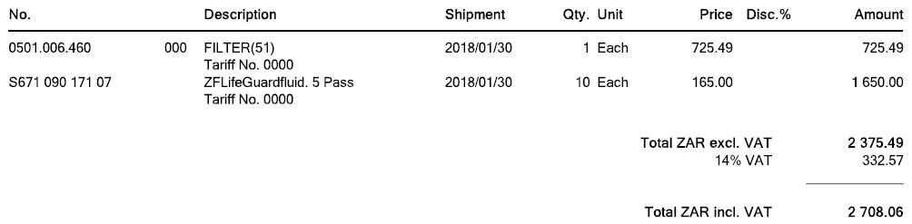

Whilst thinking about this - I would like to replace the gearbox oil and filter (if all comes together and I purchase the RS). Problem I have is that checking with the Agents in South Africa won't work, seeing the VIN doesn't pick up as the correct vehicle.
Can one still get the incorrect filter even according to VIN? I contacted ZF directly in South Africa and asked for a quote on Gearbox oil and filter - was send the following (attached).

That's the part number for the A6/S6 4.2. It *might* be the same for the RS6 but I would want to double check with the catalogue.
Or give them the part number for the gearbox. They have OE gearbox part numbers in their catalogue.
/also you don't need 10 litres. That's the capacity from dry. You won't be able to get more than 7 litres in, probably.

Thanks for the info Shoppinit. I'll see if I can find out more. Will need to get the boxes details - can one get any of this info from VAG-COM? Otherwise I will just need to wait until I have the car and get it on stands (which I want to do in any case). I want to do an assessment of what parts I will need to focus on - work on a triage system of sorts.Shoppinit wrote: ↑Tue Jan 30, 2018 3:25 pmThat's the part number for the A6/S6 4.2. It *might* be the same for the RS6 but I would want to double check with the catalogue.
I was planning to go the 10L route to do a bit of a flush first. I'm not sure if it has ever had this done.

Makes sense. Get a bit more then, and do it twice. That way you'll get 90% of the old oil out. Means you'll have to do a flush before dropping the sump and changing the filter, though, or you're gonna need 2 gaskets and they aren't cheap.
You might want to get some new sump magnets, too. And I recommend getting all new sump bolts. Although I'm guessing that the weather in SA is probably not as rust inducing as here.

Give em this part number and gearbox code (GAG):
https://audi.7zap.com/en/rdw/audi+rs6+r ... 00-300060/
