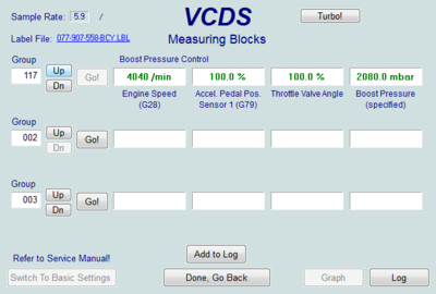

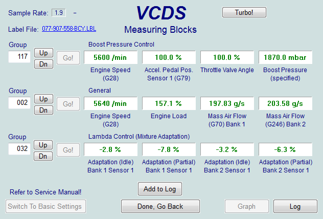

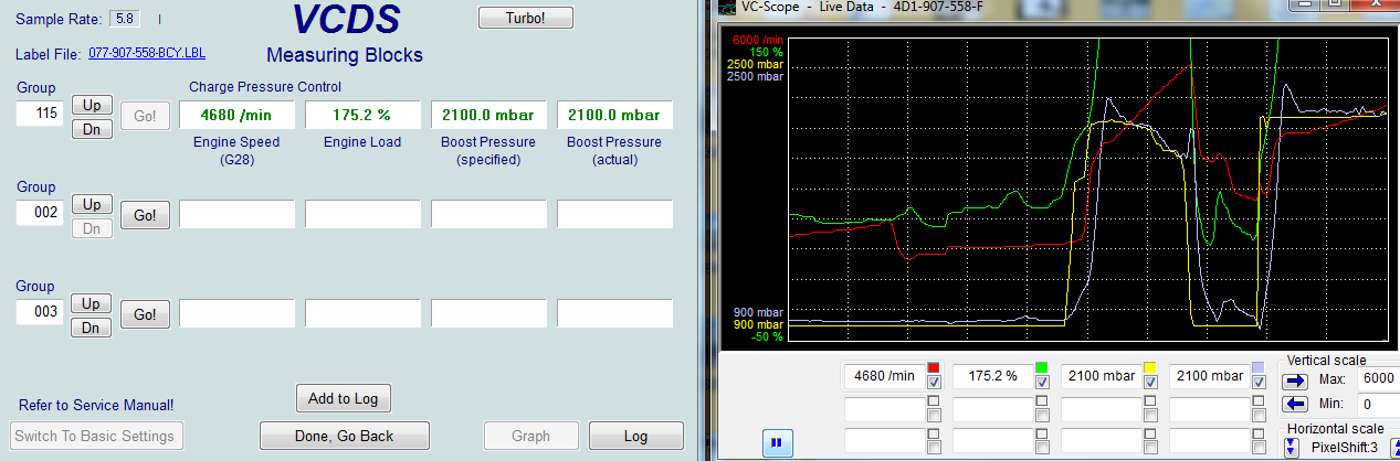

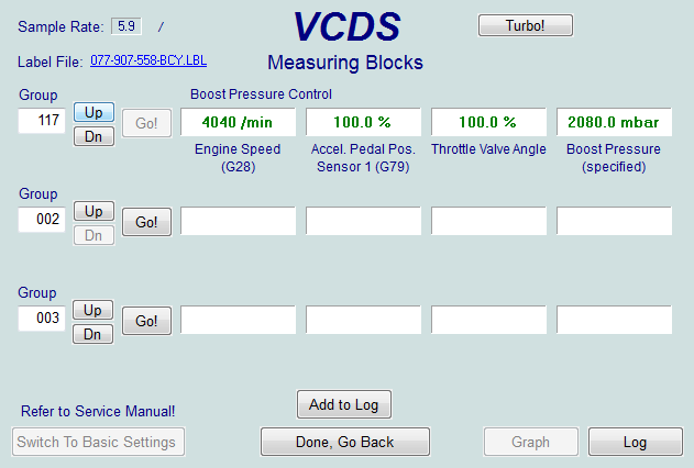

I did a few road-tests, here is what i got:

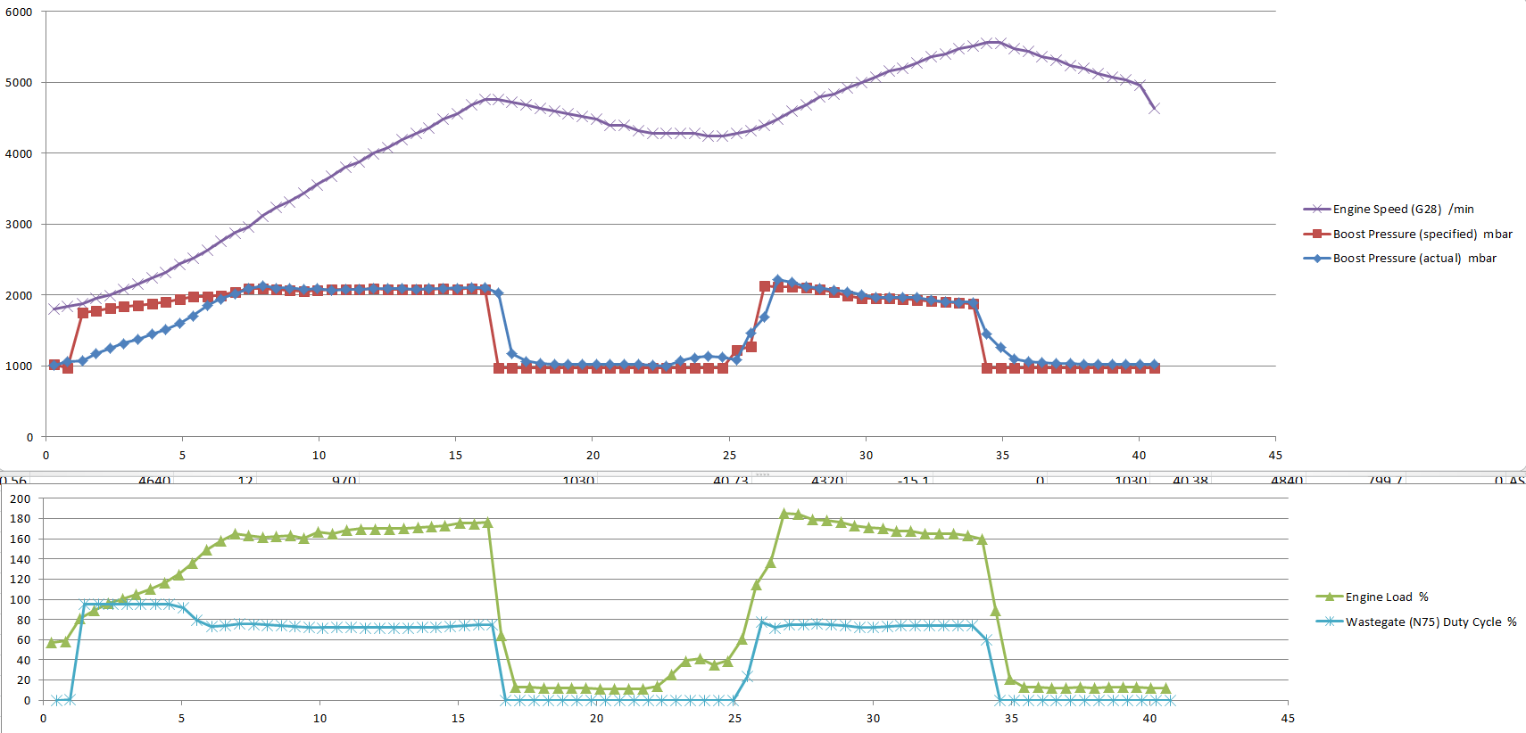

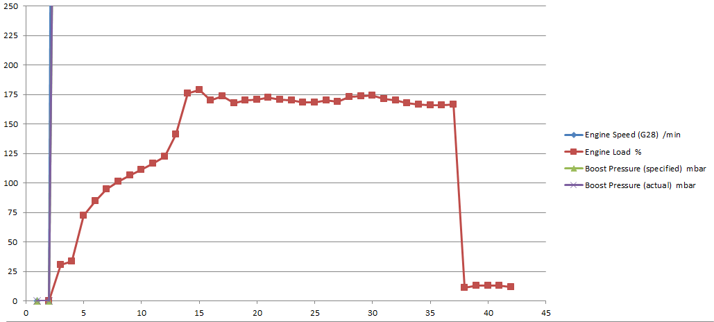

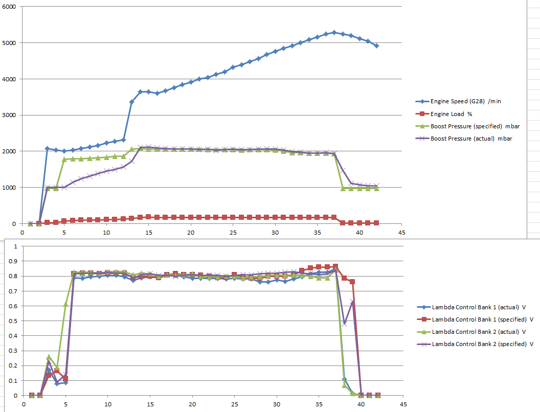

and a couple of graphs:
Why did the Wastegate open fully at full throttle at low RPMs(<2500)??
This causes the discrepancy between Specified and Actual Boost Pressures...
I don't understand how Engine load can be 170% ??
Conclusions:
MAFs are fine.
Lambdas are fine. (Or should I take a look at some other lambdas measurements? There are many and I get lost in them)

Seems to be running quite high boost. Thought they only ran about 0.8/1.0 bar as standard, and the turbos aren't really big enough to be pushing that much boost.

The boost graphs look OK. If it was overboosting you'd expect a DTC, unless it was coded out. How reliable is the tuner who did the map?

For the overboosting - but the SPECIFIED and ACTUAL boost match almost everywhere (except low RPMs). So it will not show errors on that.
On Idle run the boost shows 1000mbar and at full load it's up to 2000mbar, so it's absolute pressure...
Is 1 (extra) atmosphere boost too much?
What is the specified boost for RS6 (googled it with no result...)

It must be mapped if it's asking for that much boost.
