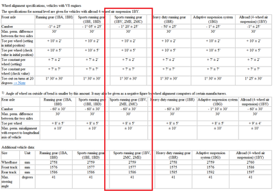

Does anyone have the correct (perfect?) Camber & Toe settings for the front & rear?

Found a copy. :D

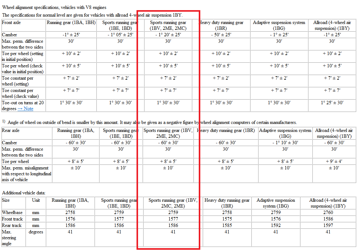

Post by Mɐʇʇ » Thu Jun 02, 2016 7:20 pm
