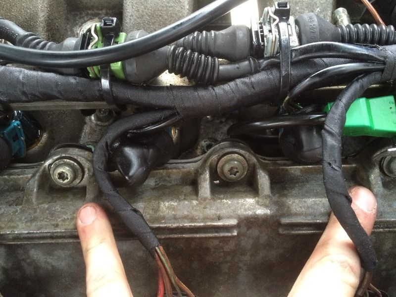

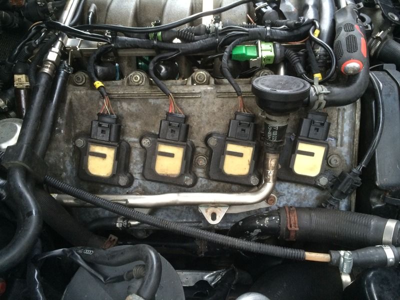

Got an oil leak which we've found out to be a split rocker cover gasket. I've got myself a genuine Audi kit. Was looking changing it today but it was getting late and didn't have all the proper tools to do the job.
Leak between these two points (gasket looks split)

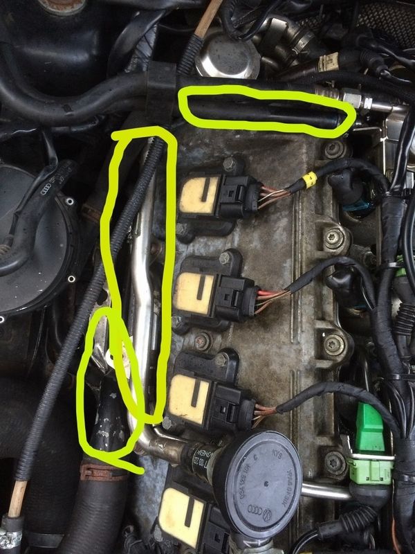

Do these pipes need to be removed to get the cover off?

In theory, that rocker cover is an engine out job. As far as I can tell that's because those pipes you've highlighted are a bugger to get to to move out of the way.
It can be done with the engine in, though. You might need to drop the engine and subframe a bit to get access though. Not a job to start just before tea-time.

£97 a couple of years ago will probably be an hour labour. They would not have dropped the engine in that time. Are you sure you can't get the pipe loosened and lifted slightly. I had the same issue with a similar pipe on the b5 rs4 when I did the rocker covers but managed to fiddle them up a little and sort it.

Been reading that you can just slightly bend that black coolant pipe out the way (say slightly as they say that wield you can see is weak) as long as the two bolts holding it onto the block aren't siezed. The oil breather pipe looks like there a rubber section at the back of the block that got a clip on that that's fine.
So its just the damn coolant pipe, which is the problem
