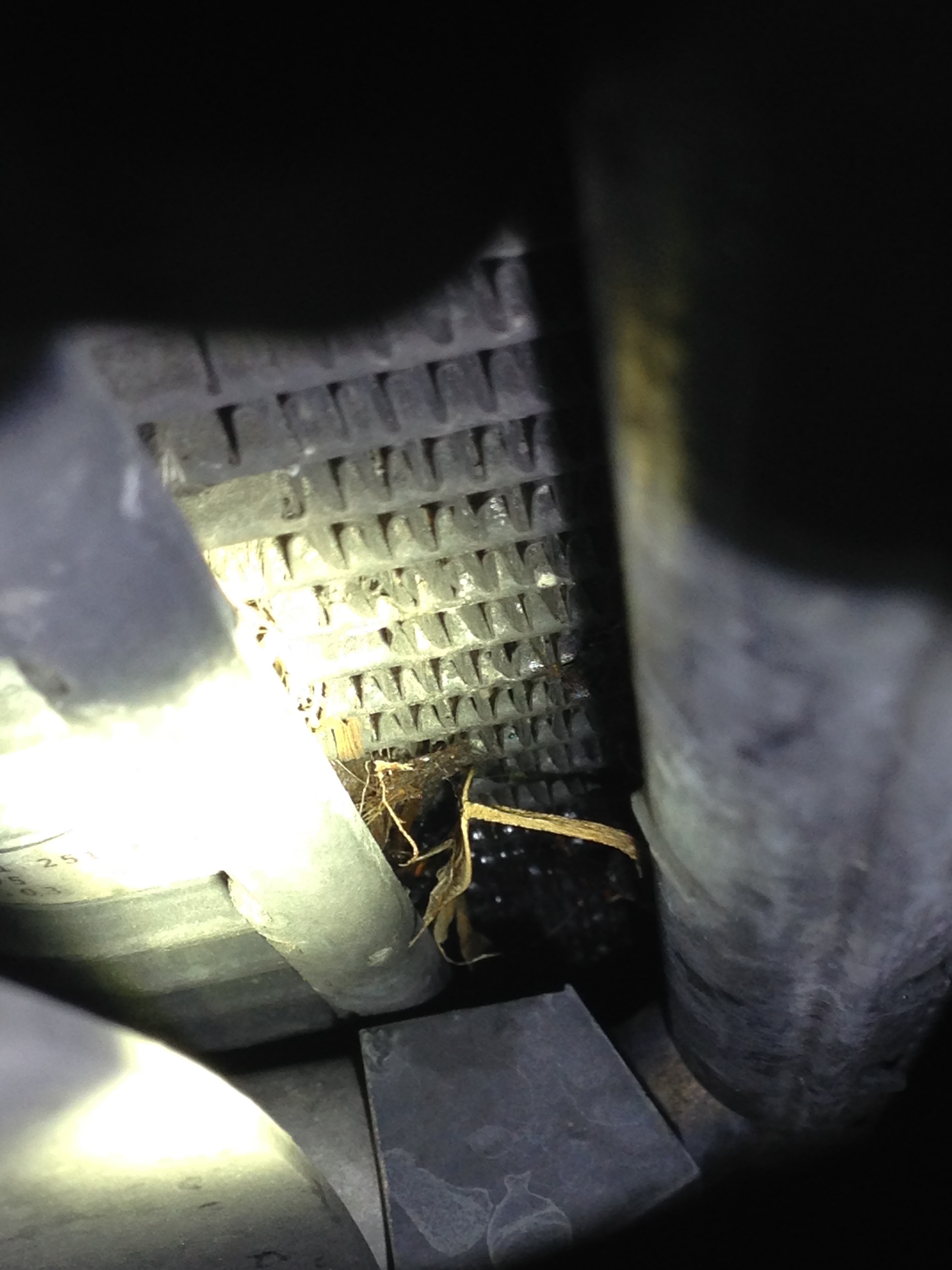

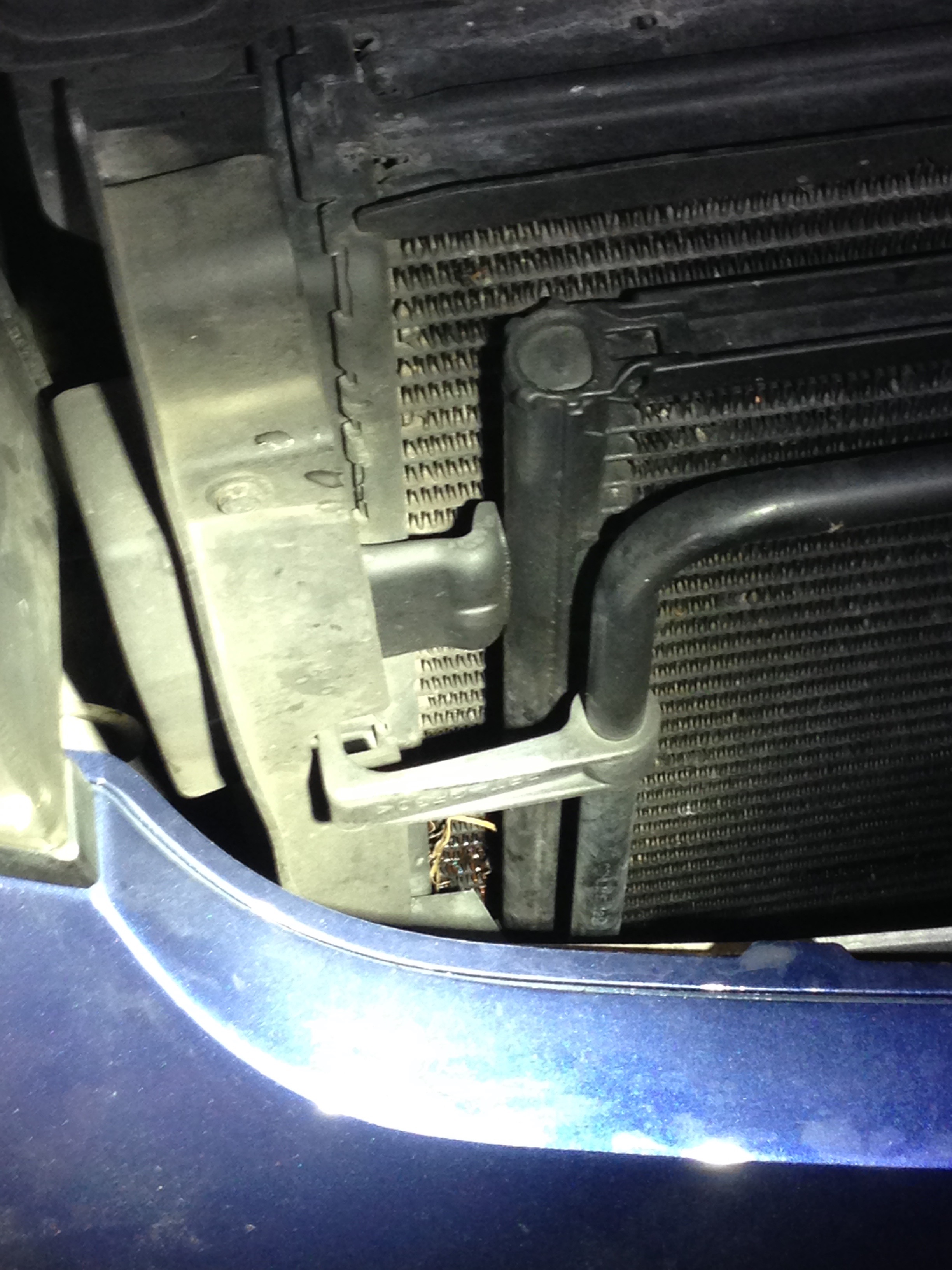

So I find myself in a similar position to OP.
My mostly ultra reliable (for 4 years) C5 RS6 now has a weeping radiator ( I had suspected a minor leak since returning from last years Le Mans, but there was no sign of one when it was having its gearbox service only 500 miles ago)
Turns out it's the expensive rad c£944.
Decision time, do I change the cam belt etc at same time and save a bit on labour even though it's a bit early being only 3.5 years and 26,000 since last change?
I was going to leave it another year, but as I think I'll be keeping it long time, it's a trip up north to Grizz a Unit 20!

I think i'd be going for cam belt change at the same Captain.

Has anyone investigated the cost of re-coring an existing radiator rather than buying a brand new one?
Re: It had to happen
My neighbour (mechanic) suggested radweld or similar.
It might be OK on a Corsa, but probably not a good idea on a RS! or do you know better?
