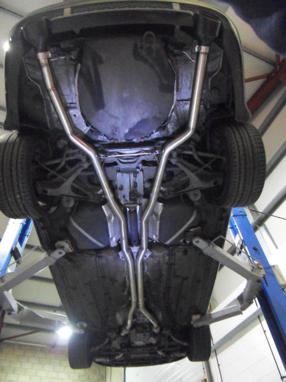

This:
and then you will get this:bam_bam wrote:Just remove the center sections.
gmac78 wrote:I must admit i prefer a more bass tone to the exhaust note so wouldn't want to change the type of noise too much, just increase the volume of it.
