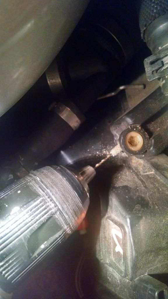

I don't check the site that often, but saw this and thought I'd share what I did.
The nylon gears are prone to failure.
Remove the gear
Carefully drill a tiny hole in the end of the knurled pin
You'll have to hold it so it doesn't push in
The hole is needed so you can tap a tiny screw in the end to be able to hold the knurled pin out. Carefully put jb weld in the hole on the nylon gear, and slide on the pin. As your doing so, you'll have to get your screw or nail ready to go on the drilled hole and pull the pin outward, sliding the gear on further.
Let dry and your done. And still adjustable.
That or buy a new headlight.

Thanks 4everRS,
That's more or less what I did, although without pulling on the shaft. I might have to try again with your method. It's a pretty stupid design!

Post by 4everRS » Sun Mar 22, 2015 1:29 am
SuprSi wrote:Thanks 4everRS,
Yeah, it's really important to be able to pull that pin outward while sliding the gear on. Mine's been holding great for several months now.
