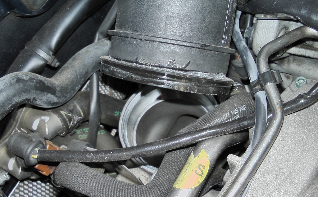

I have been suspecting that my MAF seals are leaking little bit as MAF goes in too easily and after getting new OEM maf reading still are too low (~1.5g/l). So I started looking for other options as OEM 1 seal cost in Australia 122 AUD /~100 USD and I won't buy that. My work involves high pressure (+10000psi) applications so I use lot's of different seals and I noticed something what I can easily use.
It sits exactly into intake pipe first step (with light push). As seal has little lip at the top then this holds seal in place (sits on top of intake metal edge) when you are pushing MAF into it. MAF sits into seal good (not hard or too easy), when you look the pictures you see that this seal has another O-ring inside of it, this is called energizer, this will keep outer seal ring what goes against MAF always active/pushing against MAF to make air proof connection. I will glue these in with locktite 406 (difficult to bond materials) to keep them there when I'm pulling airbox off.
There is part number on top of the seal, this is basically measurement of the seal, you should be able to get these from any O-ring shop in States and they cost few dollars each.
I hope this is helpful.

i used the Apikol seals, really great product for about $60 a set. I think the problem is not only the pressure, but the T they are exposed to, so the Apikol ones i reckon would be better than a general seal which was probably not designed to withstand high temperatures as you get in that area which is very close to the turbos. Anyways, that is a great finding and offers another solution apart from Apikol.

Actually these seals can last more then 200C, it's way more we will ever need in that place.
Part number is HB 18703125-375, always make sure that energizer O-ring is inside the lip.

Re visiting this! My experience is that it does not work as is. When I removed the air box, the MAF's came out of the airbox (as expected as they weren't secured) and out of the manifold complete with the seals too. The adhesive didn't work, at least after 4 years. What it did do was to get all over the seals and all over the MAF body where it seals and is a real bugger to get off. My solution is to buy two new MAF's and the Apikol seal kit.
The seals are hydraulic rod seals and the perfect size. The downside is the seal profile is a double lip so the seal cannot seat fully in the recess in the manifold. I would consider machining off the outer lip if I were to try that again. For the moment, It'll be new MAF's and apikol seals. Cannot understand how AUDI can even consider the asking price for the OE items.

I 3D printed a set of seals for mine from TPU and bonded them in with polyurethane adhesive. Little run and MAF removal they seem to stay put fine and as far as I can tell are sealing up nice and tight. Once I'm happy with them and checked the temps after a more solid run I'll post up the design if anyone want to try them. I think the roll of TPU was about £26 and that would probably make enough seals for all the remaining RS6s in the world! (I think the material cost is about 8-9p a seal). I had tied a couple of hydraulic seal options based on the above and I was struggling to keep them in place, lacked confidence in them staying put properly as there is not a lot back there holding the airbox in place.
