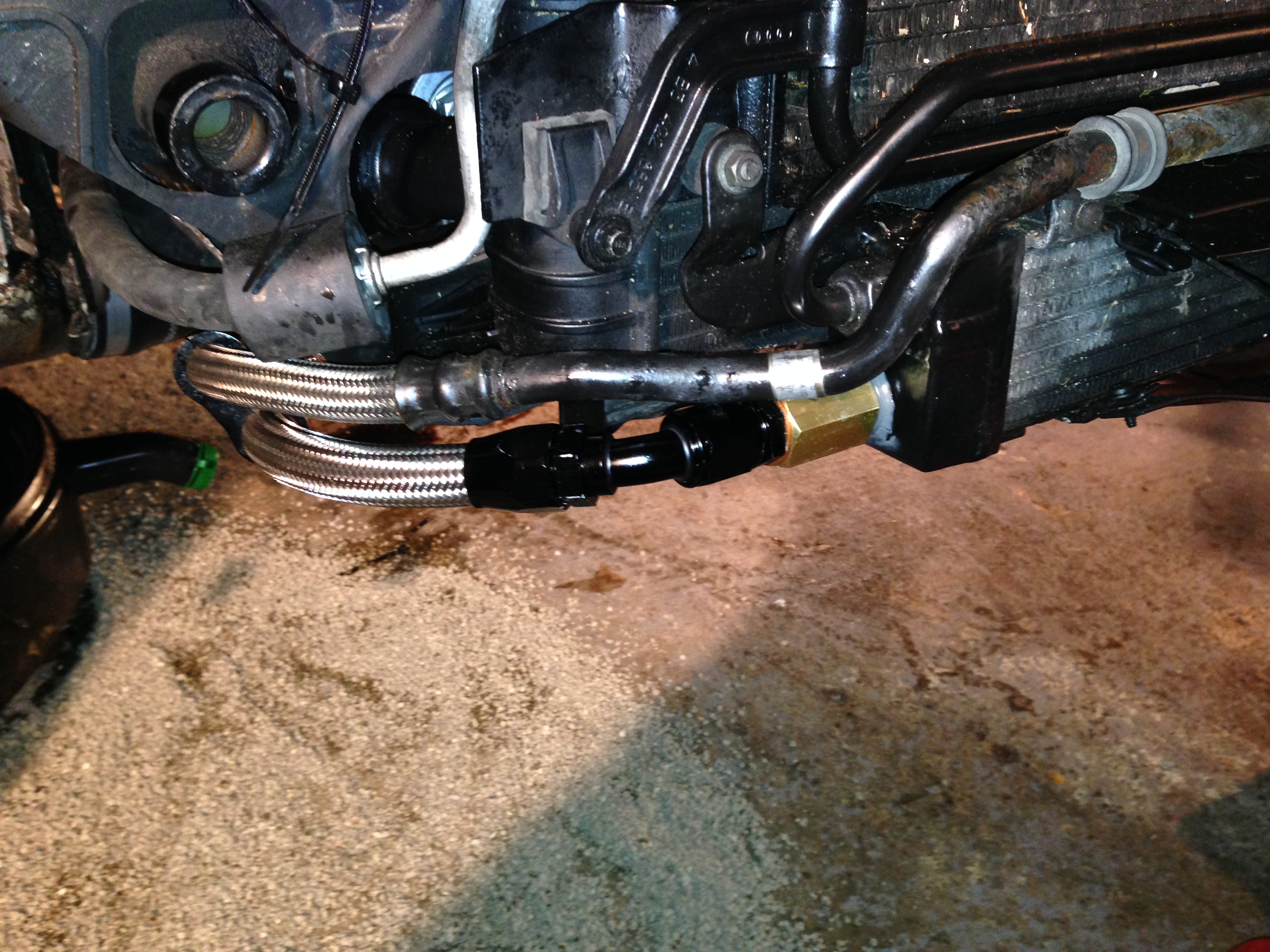

The M22 x 1.5 threads on the RHS of the oil cooler are mashed up by the mild steel oil pipe fitting.
The Solution
I found that there is still some good threads left on the oil cooler beyond where the steel fitting screwed (perhaps 5 turns) - this gives us something to work with.

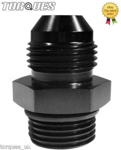

2x M22 to AN10 adaptor (The shorter Setrab one as per here - there is a longer type also) : https://www.ebay.co.uk/itm/382268993413

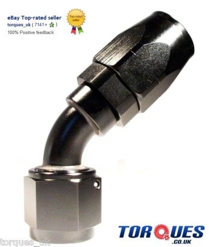

2x AN10 45 Degree Fitting : http://www.ebay.co.uk/itm/150781418512

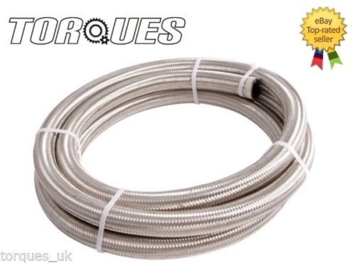

1 metre AN10 : Stainless Steel Hose : http://www.ebay.co.uk/itm/360881217559

Step 2 - Clean up the remaining threads on the oil cooler and make sure they're not full of swarf/oxidisation and fully degreased. Stuff a blue Shop towel (not rag) down the open end to make sure you don't get any swarf etc in the end.
Screw on the M22 Female socket. It will need some adhesive - you could perhaps use thread lock, but I I decided I want this socket to be a permanent fitting on the cooler and I've found JB weld to be the best consumer epoxy I can lay my hands on.
Step 3 - Unscrew the oil filter end of the existing hose and the adaptor - you will need to remove the OS intercooler hose.
Step 4 - Screw in the new M22-AN10 adaptor into the oil filter housing. Make sure you include the o-ring - or possibly you may want to replace it with a 22mm copper washer and a littler sealer.
Step 5 - Make up one end of the hose with a 45 degreee AN-10 fitting on. There's loads of guides how to do this well, so I won't cover it here. Make sure the internals of the hose are really clean. (FWIW, for cutting hose I recommend binding the hose with electrical insulating tape and cut it in the middle of the tape with an angle grinder with a 0.8mm cutting disk).
Step 6 - Temporarily route the hose through and hand tighten on the oil filter end. Measure up the length of the finished hose to the oil cooler using the 2nd 45 degree fitting. It is approx 0.7m IIRC.
Step 7 - Make up the finished final hose end. As above - make sure it's super clean internally.
Step 8 - Final install it and use the separator to mount it tidily. The new An-10 hose is a little large than the old hose, so it is a little tight - but it's fine.
