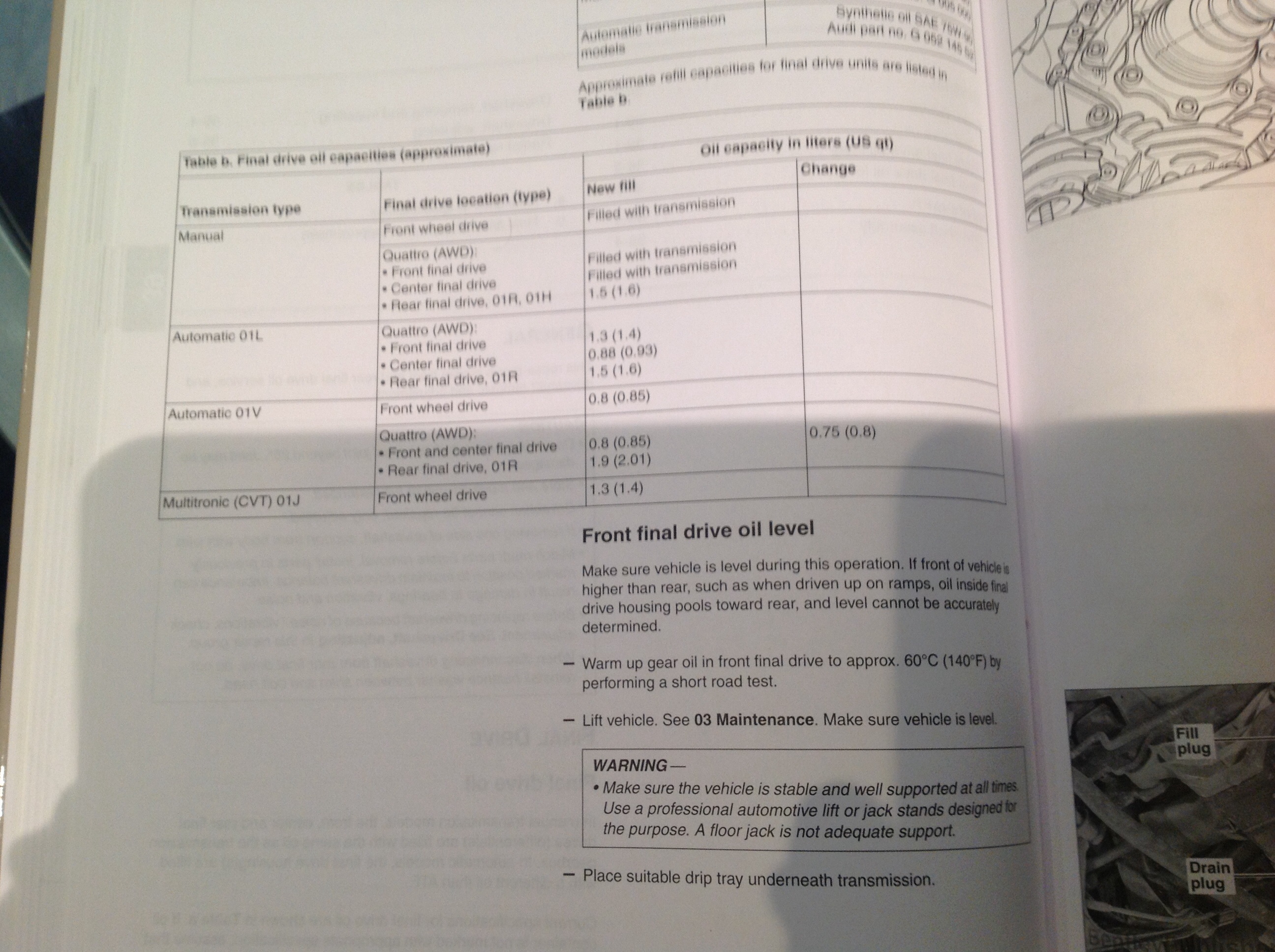

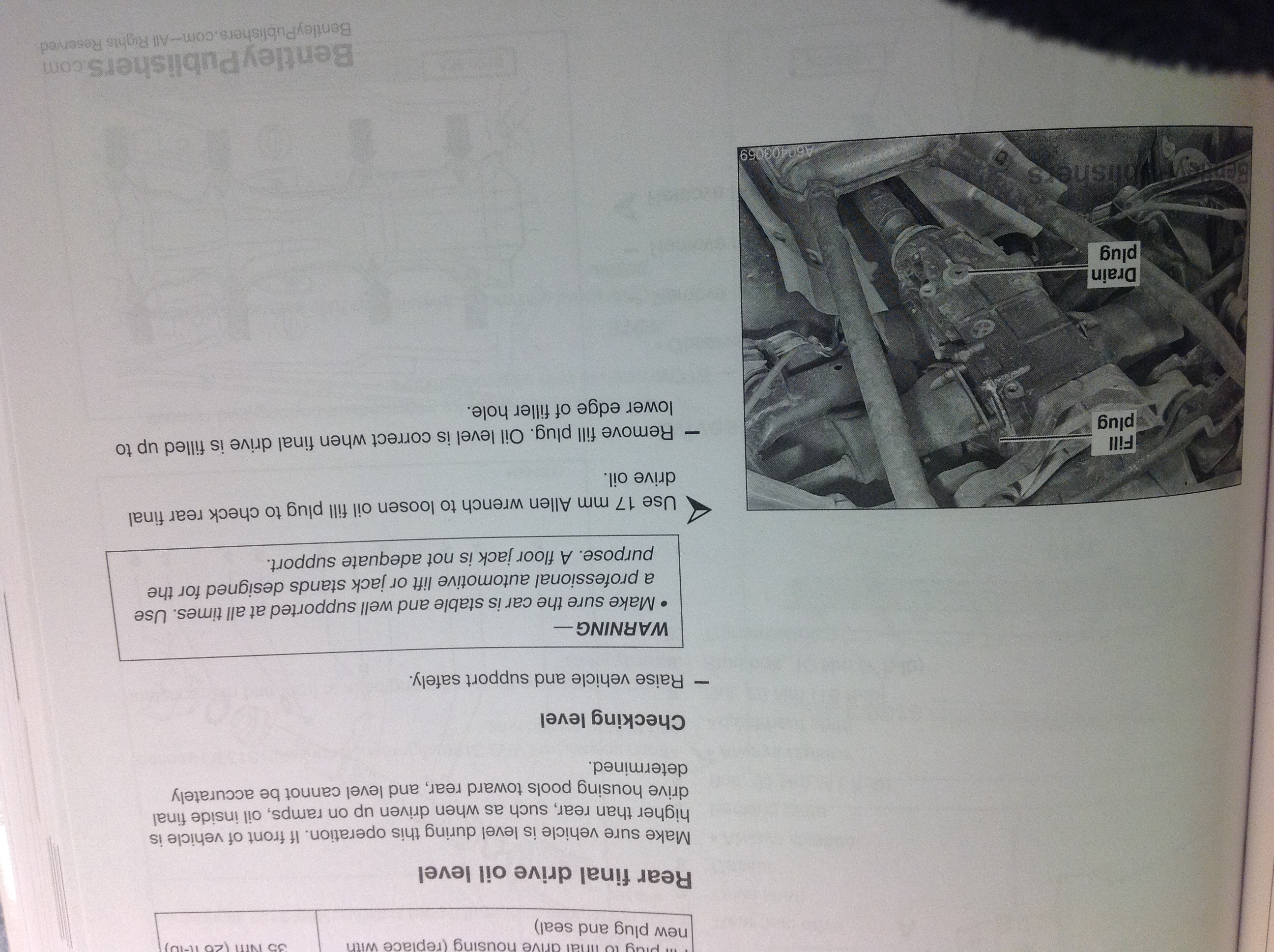

Is this what you want?
Sorry if it's a bit blurred
Re: Topping up rear output shaft oil.
Thanks alot
Looking at it, got me thinking if this pic is the from the rear part of the gearbox, cos thats the one i need...
That's the rear diff, not the transfer box which is the one I believe you are talking about, Mav.
I did this the other day on mine. It's easy.
You just need to get the car in the air (I used ramps on the front and axle stands on the rear to get the car level) then crack the fill bolt. This is a bugger, but you can just get to it with a socket. It's angled in such a way that you can just miss the exhausts to get the bit in the bolt head. Mine was on very tight. Be careful not to burr the head of the bolt or you'll be in a world of hurt.
...i think thats the front right diff side...
No worries, thanks for the effort
