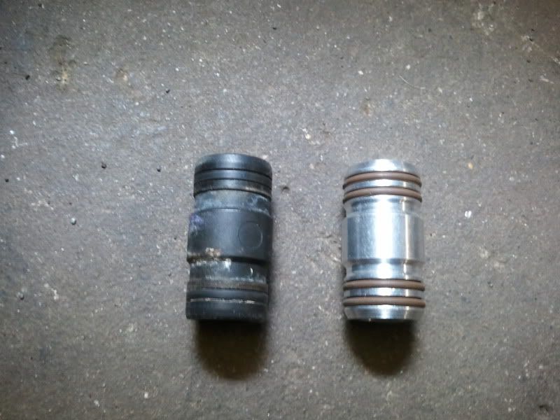

There's a small 2in long rubber pipe within the small oil/water cooler on the right side of the engine (where the oil filter lives) which breaks down. The Bufkin Mod is a metal pipe with 4 O-rings which replaces the original pipe.seaneb wrote:Bufkin mod?
