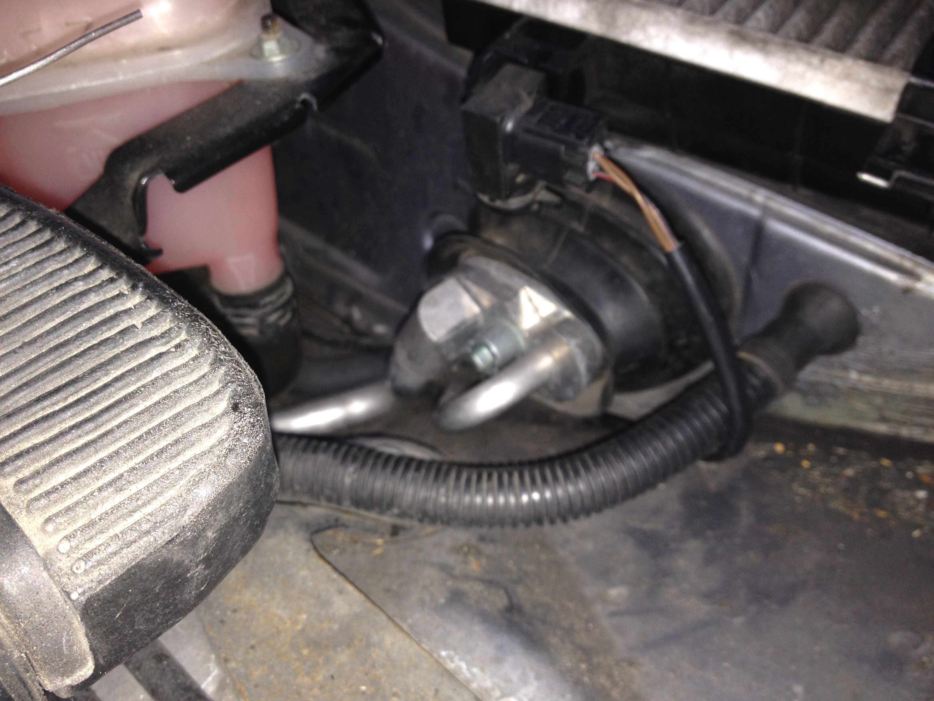

The large grommet behind the glove box which you referred to, is that the one in this photo?Shoppinit wrote:I got mine from Canada because I was there and the product looked good (and it is):

Can anyone recommend which is the best grommet to use to pass a wire from inside the car through to the engine bay? The one in the photo above seems to be the easiest to get to, but I'm reluctant to use it as it's not for wiring and I'm concerned that if I pop a wire through it, it may leake!

No, the one I used was for a really fat bundle of wires to go through.
Just take the glovebox out, you'll see the one I mean.
Re: Tom tom poor signal
I've taken the glovebox out and I could only see two grommets, the one in the photo and one that was about 8 inches below it. This one had several cables going through it. I fed a piece of welding wire through it, about 12 inches, but I could not find it when it passed through to the engine side. How high or low down was the one that you used?
