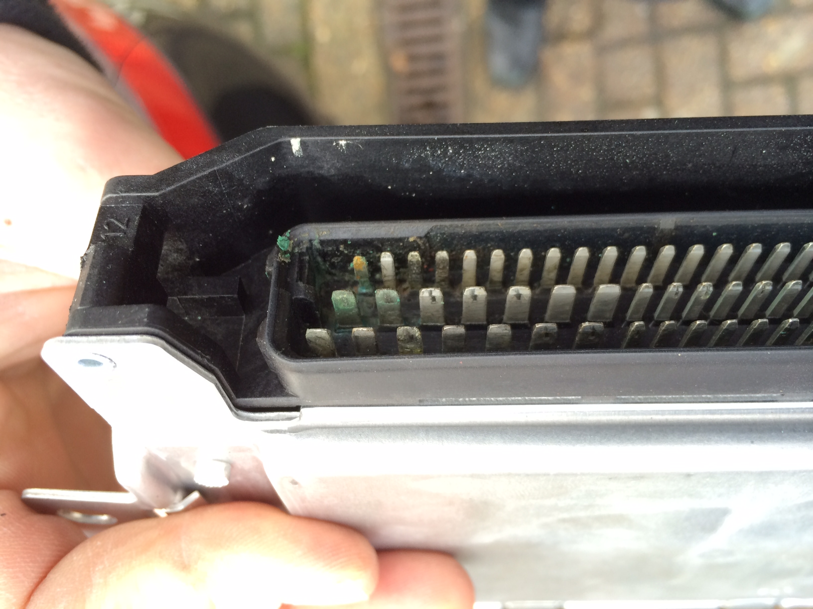

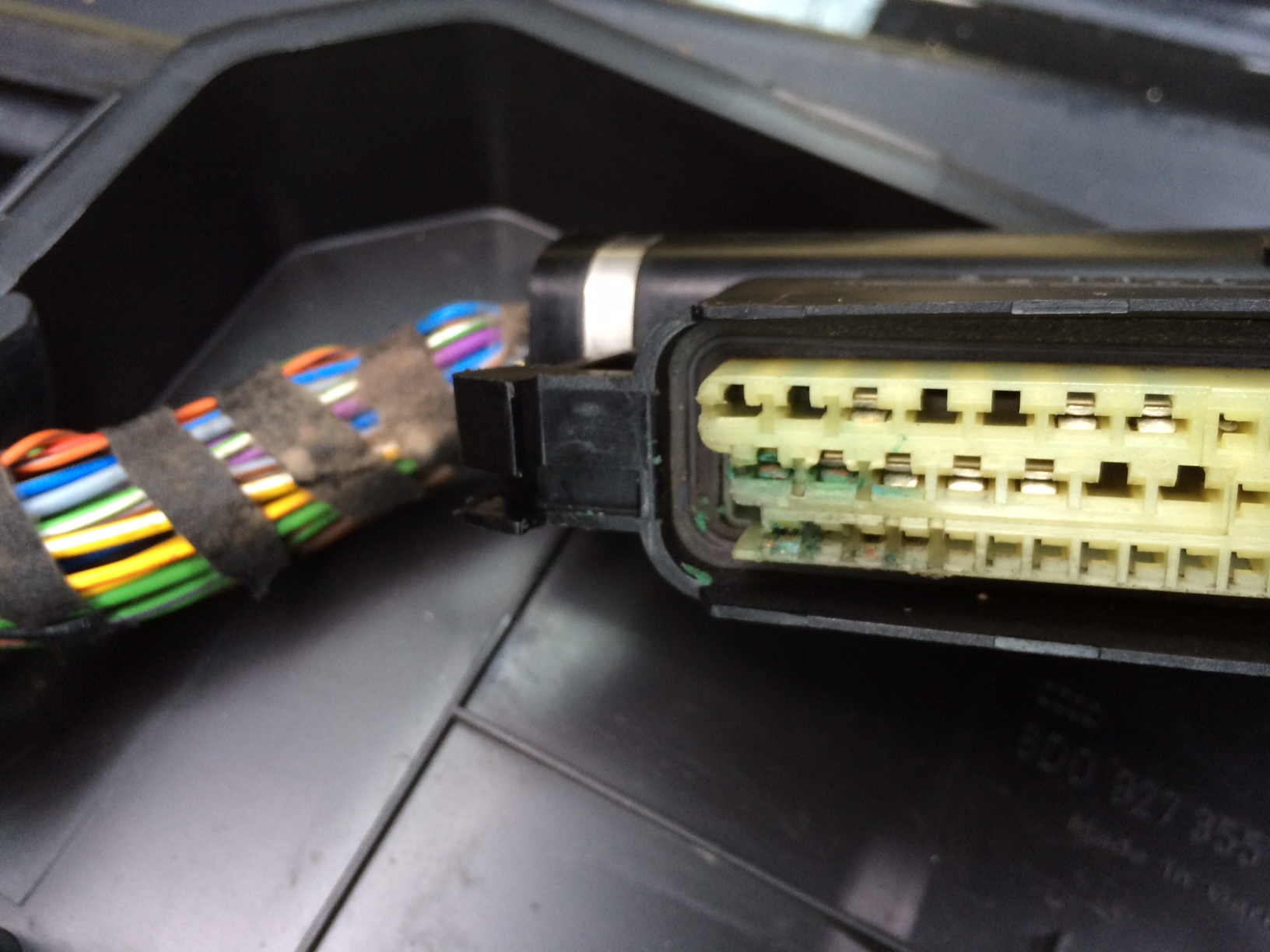

removed and took a couple of pics, what do you think water ingress?

Definitely. Try cleaning up those contacts and see if it fixes the problem. Do / did you have a water ingress problem? Even if resolved it can take a while for the contacts to corrode to the point where they no longer conduct.
Might be worth opening the TCU to see if there's any damage inside.

I have never had water ingress but that's not saying i've never had it or noticed it.
i'm going to give them a scrub with contact cleaner the best i can and give it ago,
I would open it up but looking at it i'm not sure the best way to do that so might leave opening it. for the moment

Well after a big scrub with cotton buds and contact cleaner..
IT WORKS !!! :D
Thanks for the help. and strangly the airbag light has gone out now which i had the drivers side igniter exceeded.
i did re press on all the connectors in the footwell so maybe one of them was loose..
but am happy as just saved me a few hundred quid i'm sure.. :)
