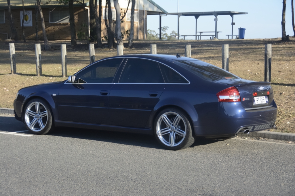

My RS6 is running rims which came off the current model RS5. Offset 32 (as opposed to RS6 OEM of 35), 5x112 bolt pattern (but that's most of VAG group), and 255/35R19 XL Pirellis. The only difference is that the A5s have a 66.6mm hub diameter (why?? did they get them from Mercedes?? http://www.wheelsupport.com/bolt-pattern-list-5-x-112), where as the RS6 (and A3/A4/A6/A8) has 57.1mm hubs - but sleeves are readily available. That 3mm extra offset looks just that bit better, I think. No problems with clearances.

Are those the 'peelers? Thought the RS5 came with 20" Rotors or are they an option?
Nice looking 'loon btw :thumbs: Dectanes?
