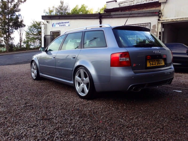

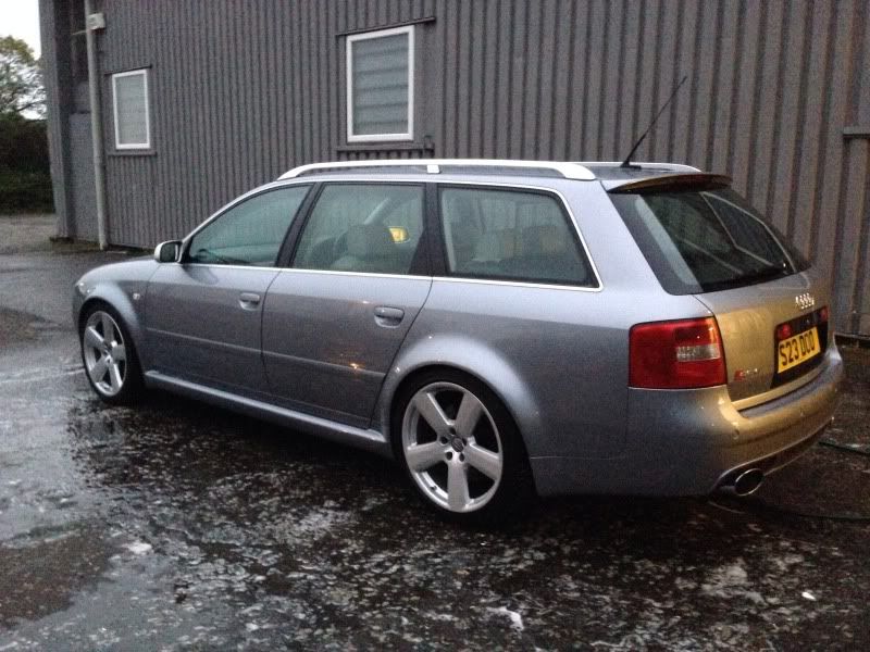

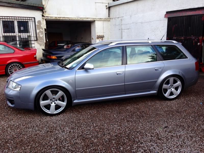

Hi all, well that's the box fluid changed, diff seal done and Diff oil refilled..... Oh and 2 cats gutted ;) so far car Is driving great gear changes are really smooth so happy result and a no bad bill of £400, so next thing is get out and enjoy it :)

Very jealous mate, supposed to collect mine at 5pm tonight but it wasn't finished, and didn't finish work until 8.30. Was so disappointed had a proper school boy strop. Monday cant come quickly enough! Enjoy your car, looks very nice.
