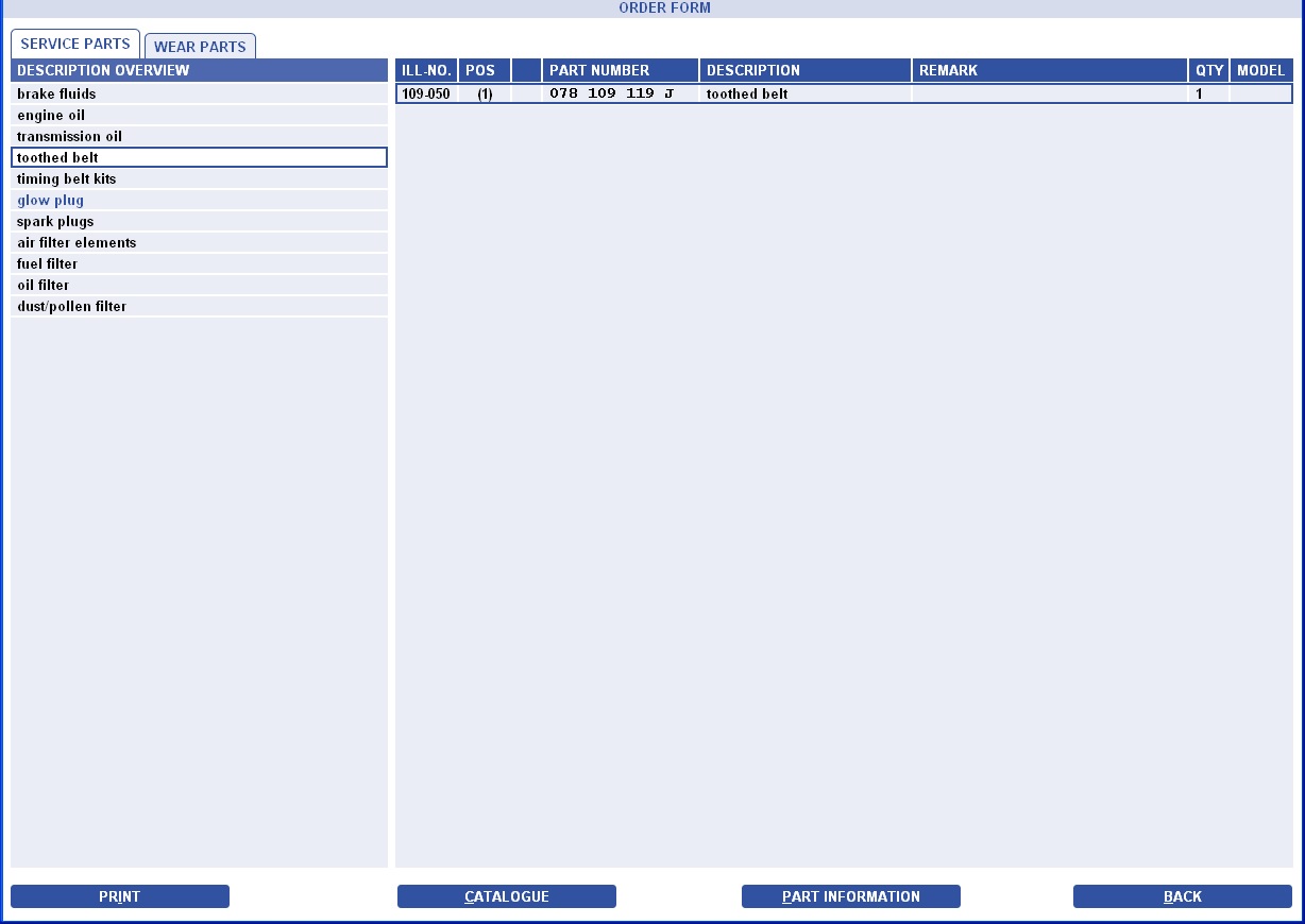

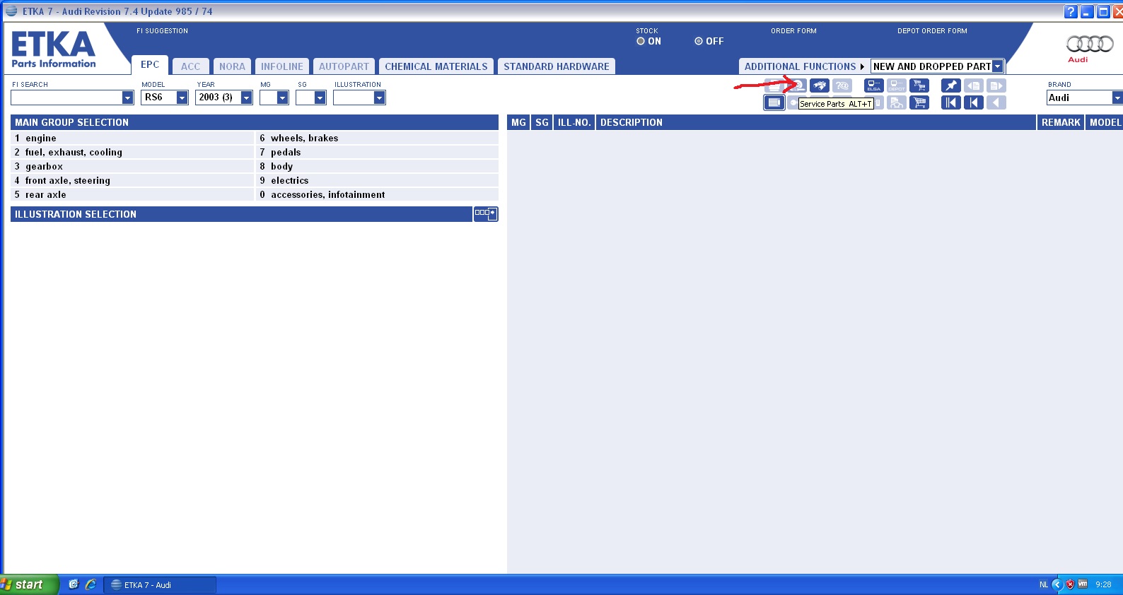

Yup, that's the only way to be sure. Are you able to generate service action sheets with yours? Like for the 20k miles service? I used to be able to then one day I couldn't any more.
Re: Front suspension arm info
..is it this?

Sorry, I'm being a spaz. I was referring to Elsawin.
