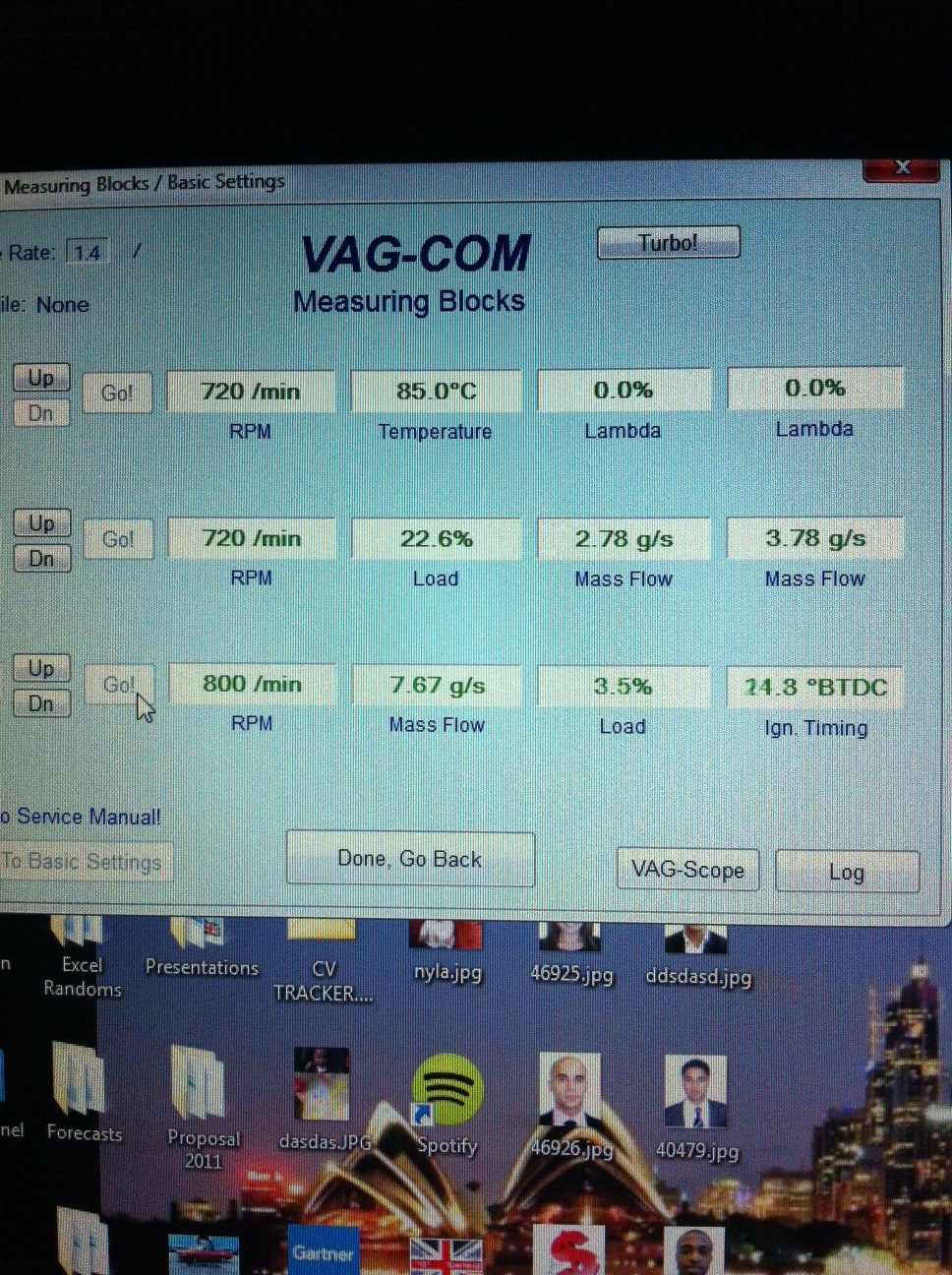

Re: Urgent help road trip tomorrow and really rough idel
right, hooked the Vag-Com up and the results are.
Bit low on bank one. What happens at 2k rpm?
all good at 2k i think mate, why?Shoppinit wrote:Bit low on bank one. What happens at 2k rpm?
Do you think that the low reading on bank 1 could cause my issue?
shall i take another reading at 2k?
