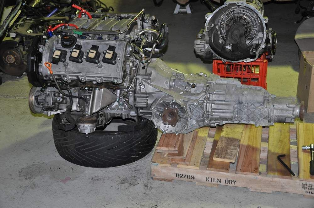

Looks like it's had headwork.mavada wrote:
....and a 0A3 B7 RS4 gearbox.

Any details? It's a better shifter than a 01E, not sure about the gearing on a stock 0A3, it's reportedly a bit short.
0A3 B7 RS4 gearbox
Custom 6mm gearbox spacer
Modified TDI 6th gear
B7 RS4 clutch slave
A6 manual Clutch master
A6 manual clutch pedal/brake pedal
ClutchMasters FX850 Twin Plate clutch
custom front half shafts (using existing stock RS6 CVs)
custom gearbox mount brackets
modified tail shaft
B7 RS4 clutch slave
modified tail shaft

Noice. Thanks Mav.mavada wrote:0A3 B7 RS4 gearbox
B7 RS4 clutch slave
modified tail shaft
