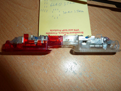

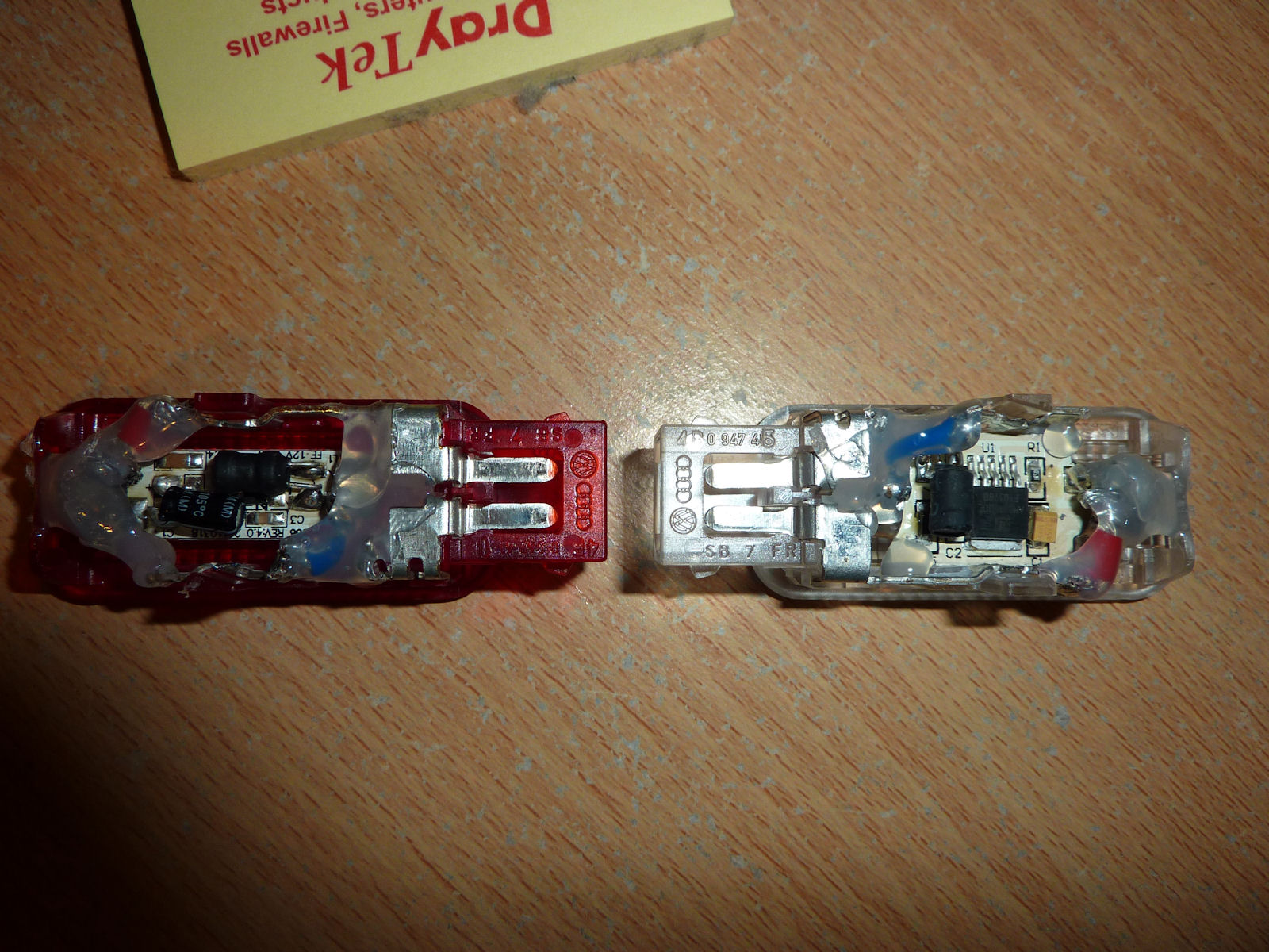

Glovebox light (REQUIRES CUTTING OF LENS PARTS/SOLDERING as per images in this thread) - 1x U373CW 3LED Cool White 37MM Festoon - http://www.ultraleds.co.uk/37mm-leds-fe ... -1496.html
Bottom Door lights (REQUIRES CUTTING OF LENS PARTS/SHAVING OF LED PCB/SOLDERING as per images in this thread) - 4x U376UCW 6LED Cool White 37MM Festoon - http://www.ultraleds.co.uk/37mm-leds-fe ... -1493.html
Side Door lights (REQUIRES CUTTING OF LENS PARTS/SOLDERING as per images in this thread) - 4x U373CW 3LED Cool White 37MM Festoon - http://www.ultraleds.co.uk/37mm-leds-fe ... -1496.html

Pics of the final modded lenses dotted around the car for reference, showing gaps etc:

Bringing this back from the dead, holy crap my soldering game has improved since I made these monstrosities up, but you don't see any of that anyway. Just for the hell of it, almost 5 years on, all modded units still working perfectly, zero failures in either this car or the 4, did the same mods to her too.
