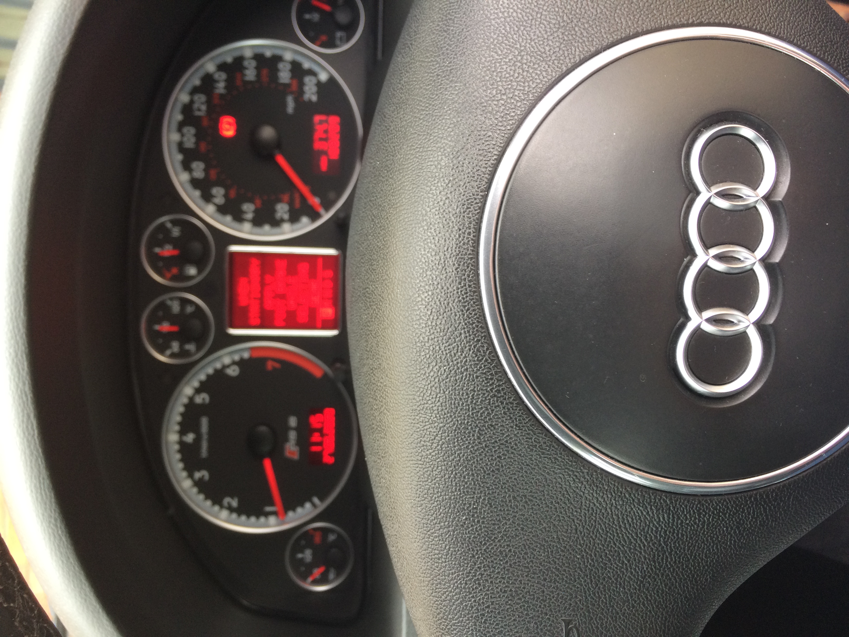

Post by steve2003rs6 » Sat Jun 27, 2020 12:55 pm
Finally got the cluster installed. No missing or faded pixels.
Many thanks to everyone that helped.

Out for a drive yesterday. Noticed I do not have any backlights on the dials. Everything else is ok.
Night time driving a bit of an issue at the moment.
Same problem with the spare cluster I fitted. Lived with that until mine came back after I had the new dis screen fitted.
Weird same problem on two clusters.
