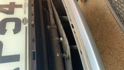

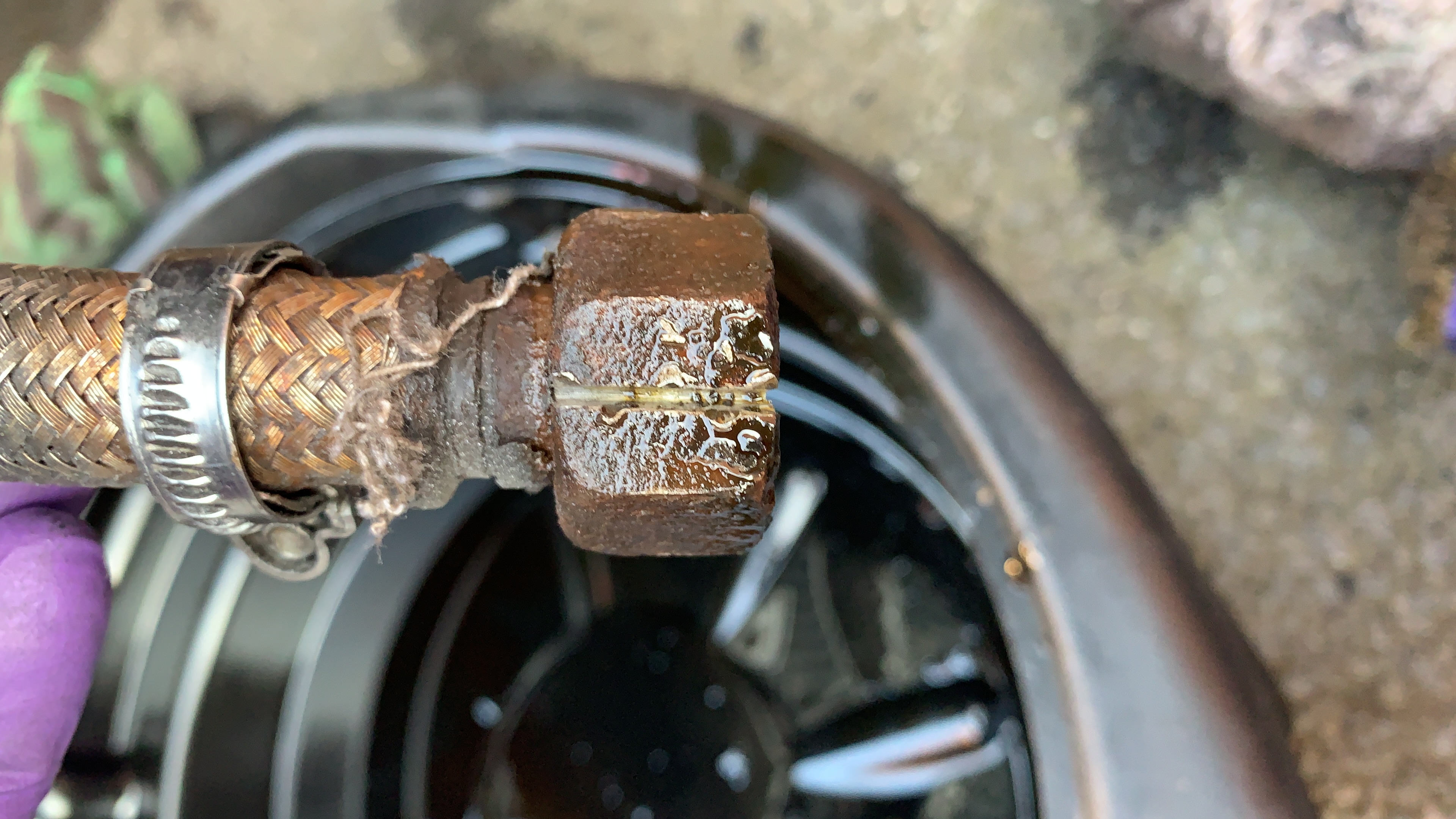

By way of an update to this. Mine let go the other day after a previous budge job failed. So I’ve ordered all the bits described in this thread to replace the areas that are at issue
You can see in the pic the bodge that failed

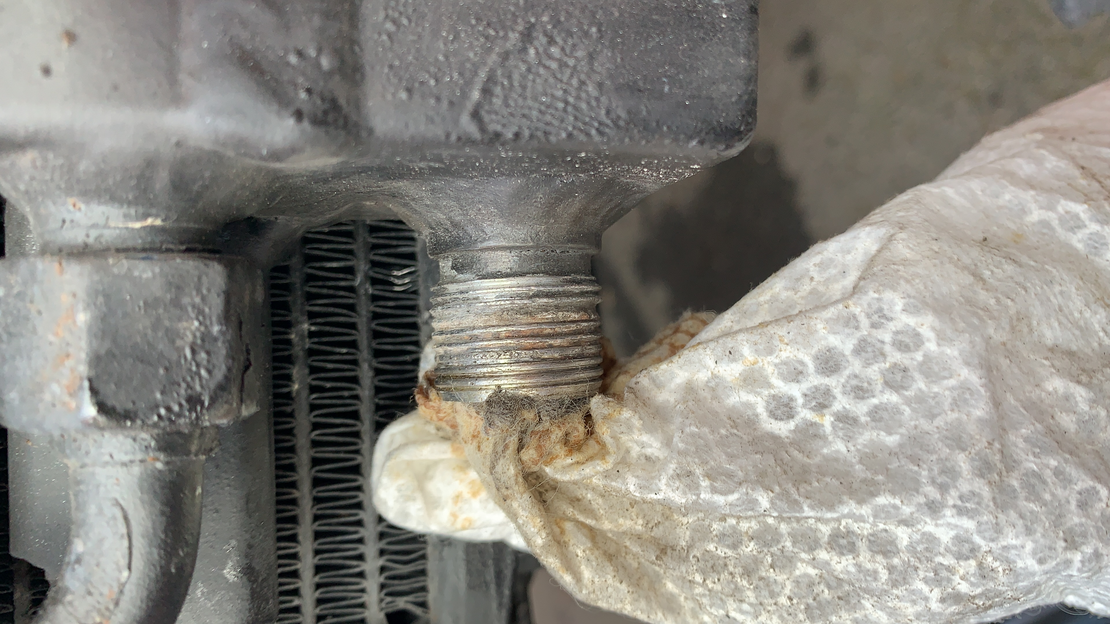

My mk1 version of this repair is now 6 years in, nearly. and holding up just fine. Do take note of my comment re. Teflon though. The Teflon hose is nice.
To remove the OS cooler hose from the cooler, break out the dremel and take it slow and steady. You want to save as much of the cooler thread as you can - the more you save, the more lives you have in store for future jobs.
Lucky it’s that hose and not the NS hose. The NS one is doable, but basically a right bugger and as long as OEM is available, defo the way to go for that one.

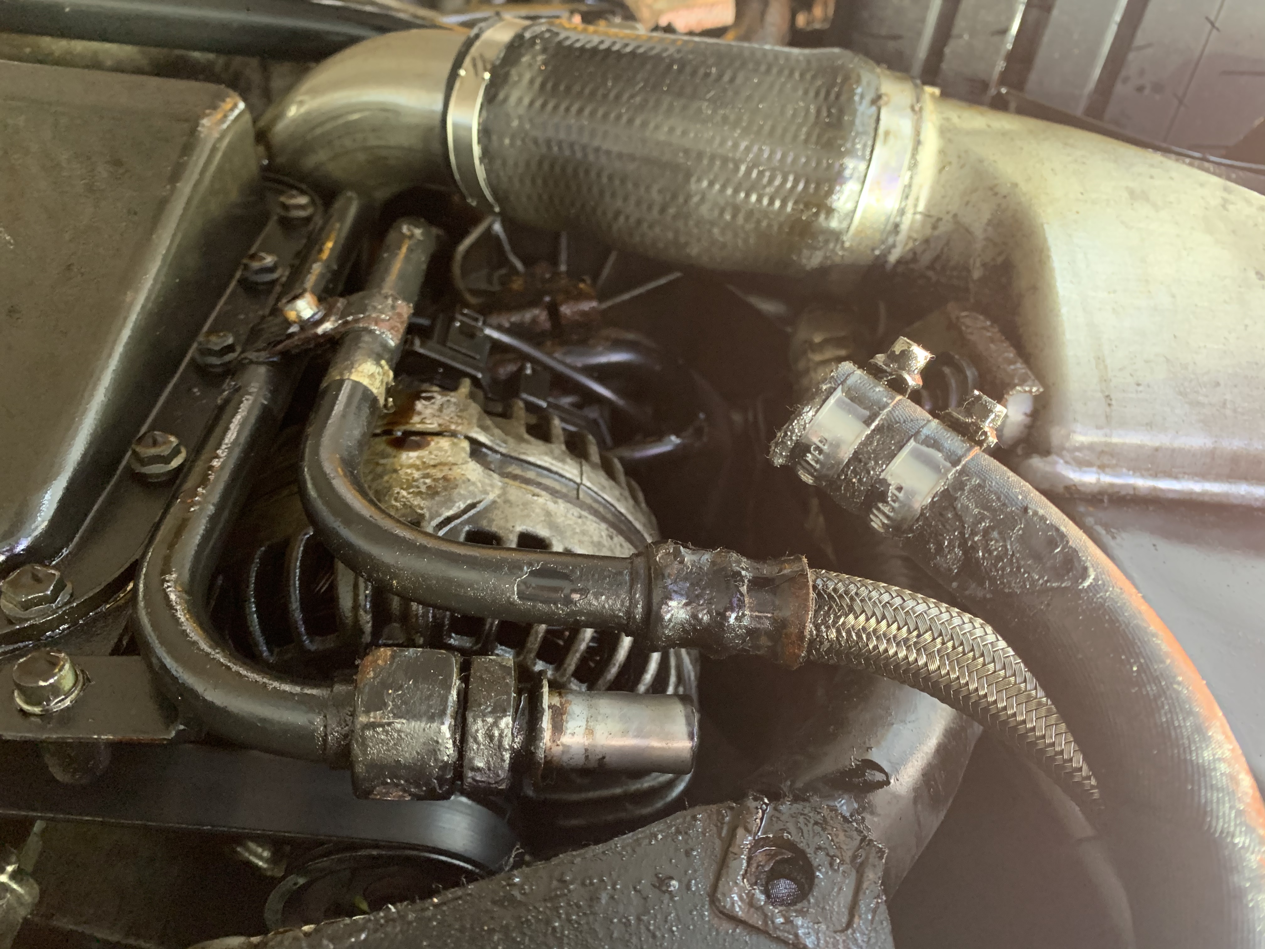

Re: DIY - How to save your oil cooler
The pic is upside down it’s the NS one that is the bodge. He then cut the hard line half way across the front of the cooler as pictured and put a flex hose over that. That’s actually a decent fit As he then out a couple of weld lumps and three jubilee clips so it’s going no where. The rest of the hard line is in good order so will keep that and re do the flex line back to the junction.
Then follow your guide for the OS using this kit and the other few bits so allow me to build it. Basically will be flex hose replacement apart from hardline on both ends for the OS joint. It’s in good order and will be wax oiled to protect it.
I used the dremel idea and got the nut off perfectly without issue

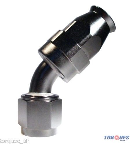

Just to add a note. I can see from other forums that some people go with AN-8 hoses.
I’m sure that is OK, but then AN-10 sizing matches OE hose bore. If you want the extra space of a thinner hose with the same bore as OEM, go with Teflon. Teflon hose is excellent!

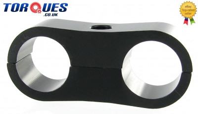

To go with Teflon, replace the 2 hose ends and hose from the original post with these 45 degree end fittings:
https://www.ebay.co.uk/itm/172957761220 And 1M of this hose:
https://www.ebay.co.uk/itm/362145770960 Plus this seperator (it's slightly smaller to fit the teflon):
https://www.ebay.co.uk/itm/362145644313

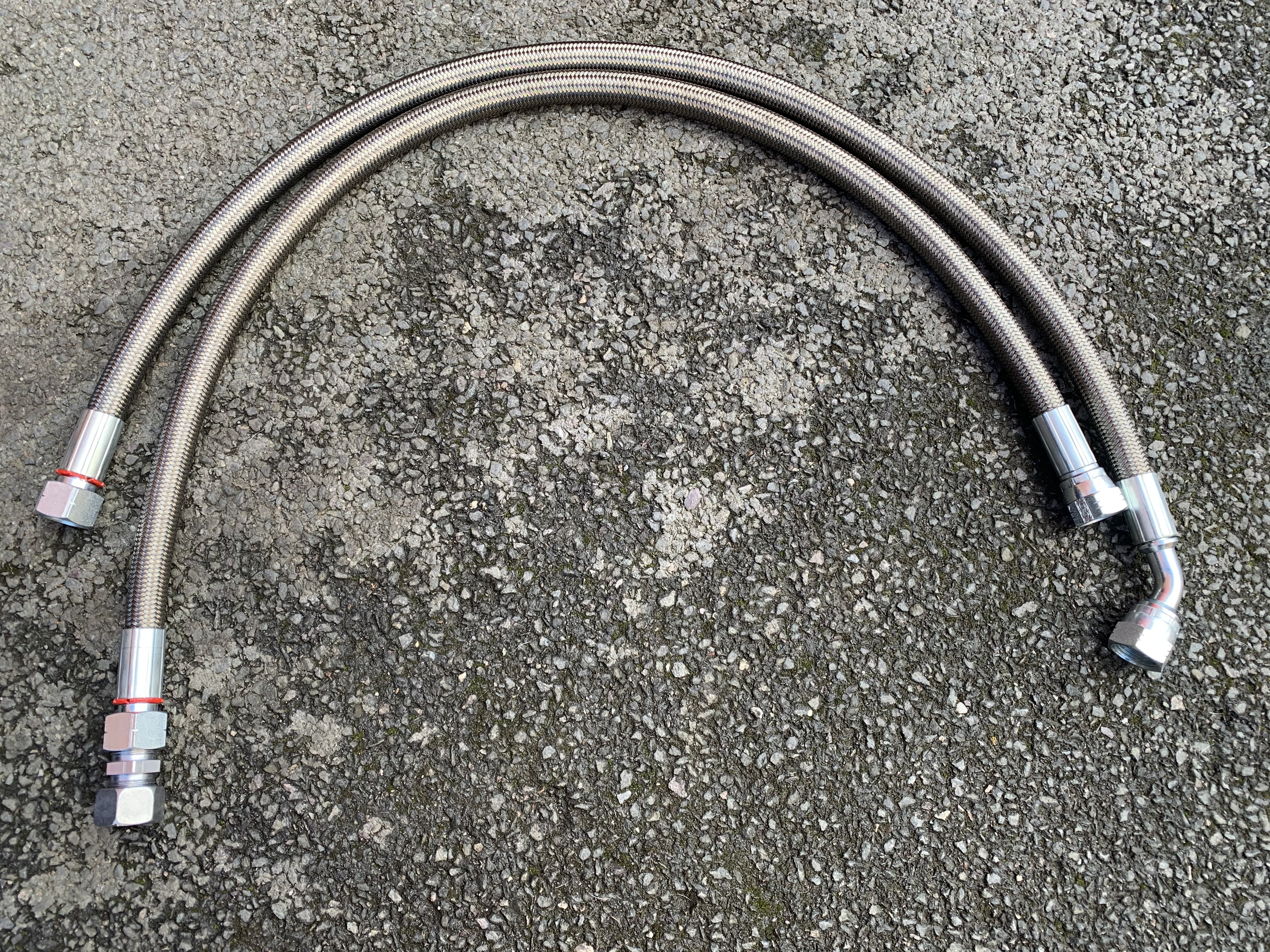

Those look better than the ones I initially got. I settled with these custom made at Pirtek with proper joints for £66 all in

In conclusion to this thread no thought I would just post to say the pirtek stuff fitted really well and has a factory quality to it. One week since fitted and it’s all running smooth.
