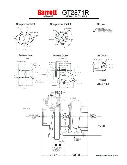

Not sure why you need GT30's
Big 2860's will see you to 650+ and 2871R's will see you pretty much to 750+ and if you get a GTX2867R (or similar billet wheeled HTA type) you should see the spool times getting almost back to standard i would have thought.
J.

Bladerider wrote:Not sure why you need GT30's
J.

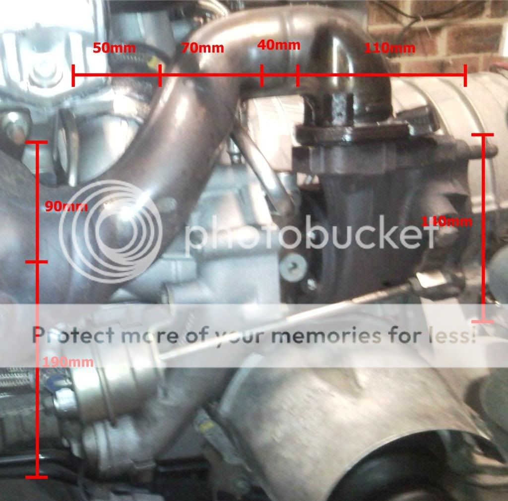

Even the GT28s don't fit with a slushbox, better people than us have tried. I think Jordan was first to pull and give it a bash. I've checked the lengths before (k04 is 196mm vs 198mm GT2860) but there's more to a turbo frame than the length, square peg, round anus and all that.
vs
The other thing is the current 'box is at the torque limit.
Also, you'll need a custom manifold and customised DPs for the most part staying with K04s is a smarter choice.
However, I do agree about the GT2867s, it'd be a better option if manualizing a C5, it'd be far more usable and probably a better drive.
