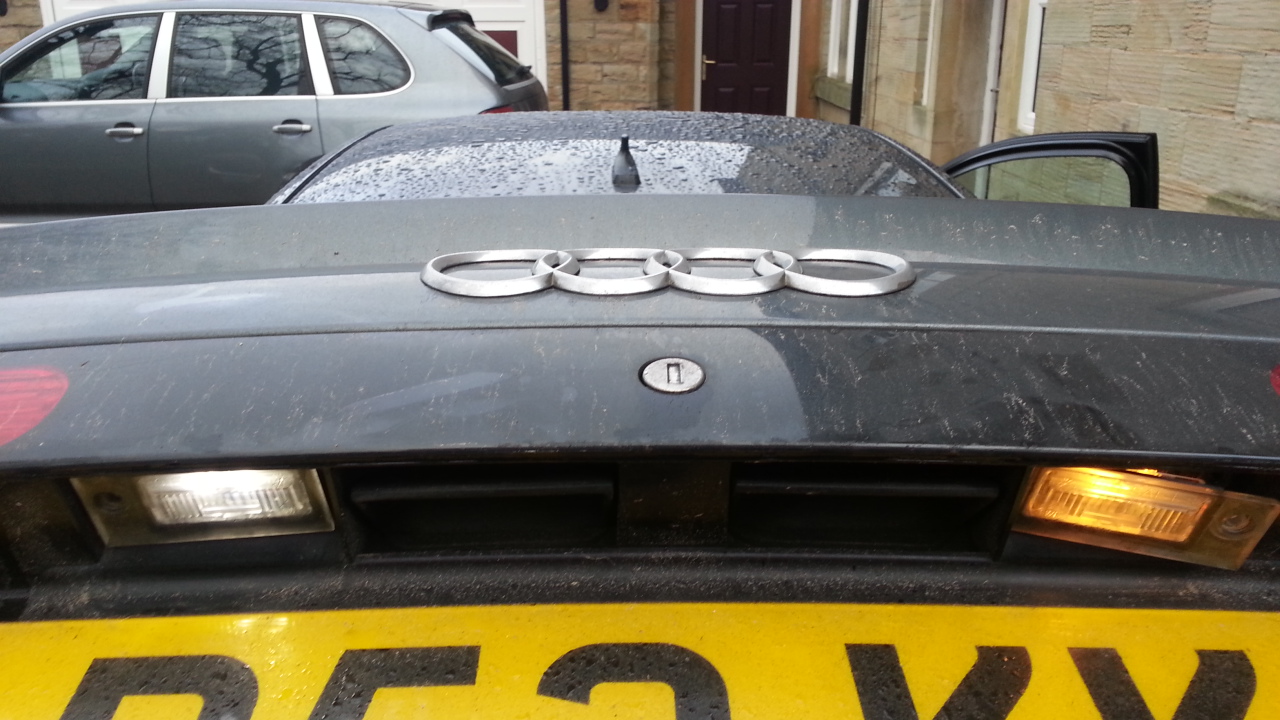

Hi All,
While the turkey is in the oven and I have a few mins to put some of the LEDs in.
The number plate lights were a doddle, double checked they worked before putting them back in.

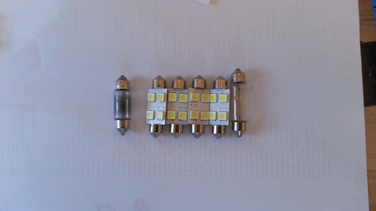

Re: C5 RS 6 LED Kit
Smaller one the the left is the rear main light, the one on the right the front.
They fit in the back all be it a bit tight, the front would need bending.

I'll try to take a few photos tomorrow Trups for size suggestions etc. There are two lights in the 'loon boot and I ended up using the same ones as the number plate and that worked a treat, they perhaps need to be 2x2 instead of 1x2. I'm happy to buy a few more bulbs from you to refine it, I like to have things as perfect as possible.
As far as I concerned the kit does as it says and very pleased overall.
