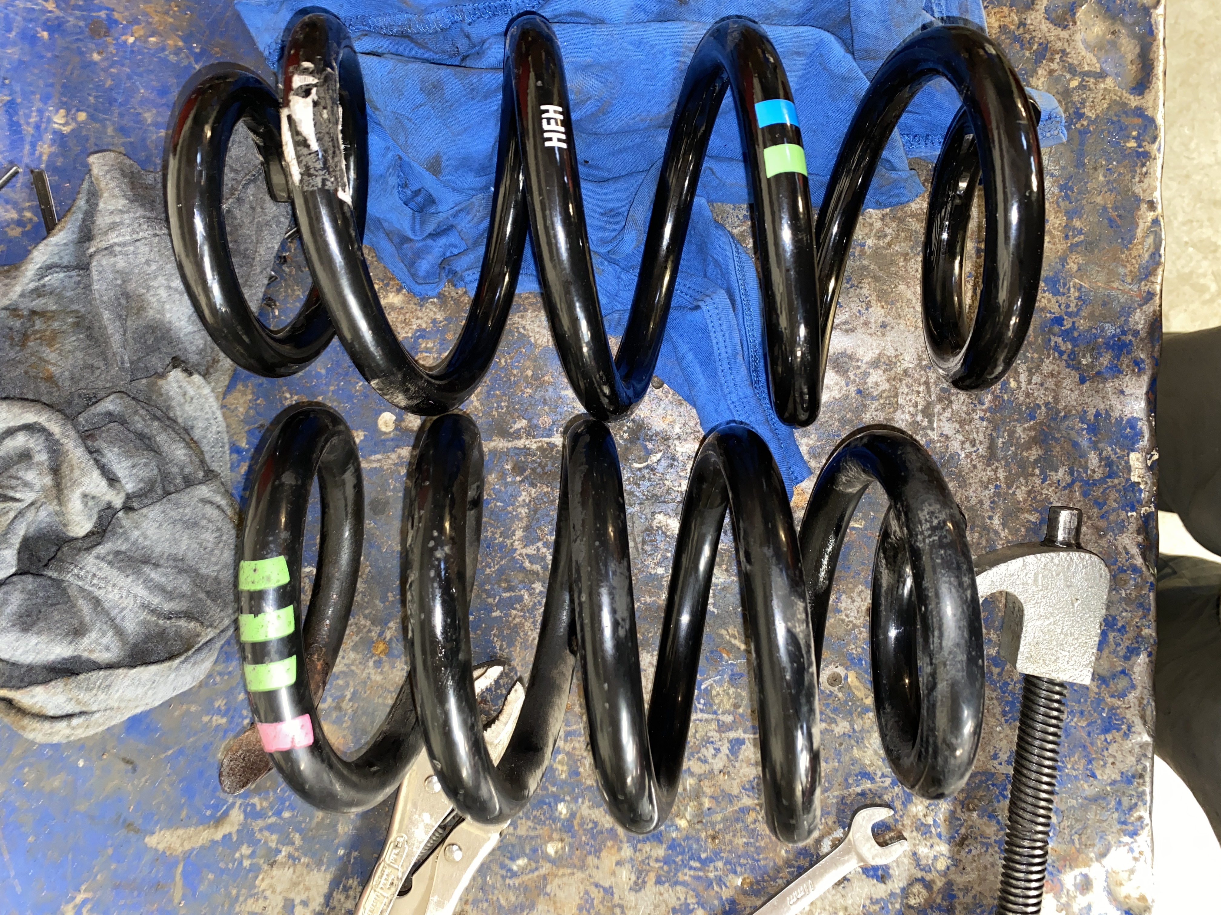

Attached is a photo of the original spring at the bottom, more coils and thicker wire, and the replacement on top. I’ve checked the parts system and
8E0 411 105 CK (3 green stripes and one violet) supersedes to 8e0 411 105 EK which is what's been supplied.
Car is back on its wheels at the back, but the front is still up in the air on axle stands. The upper control arms pinch bolts were seized and took ages to persuade to come out, and on top of that once the damper with the broken spring was removed, the spring was obviously very different. The old spring is substantially thicker than its replacement, and fewer coils to boot. Going to check with Audi...
Gallery of work in progress here Andrew's RS6 project

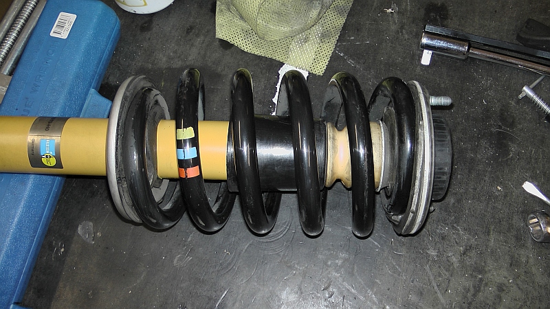

None of those look right to me. Here are my spring colour codes, Standard DRC springs on Bilstein. This is a sedan so the rear code may differ.

The parts catalogue at 7zap is a little confusing, at least to me. It suggests four five options partially depending on weight code?
8E0 411 105 CH coil spring [supersedes to 8E0 411 105 EH]
- 1 blue, 1 white, 2 green
0JK code (weight category 10)
8E0 411 105 CJ coil spring [supersedes to 8E0 411 105 EJ]
- 1 green, 2 violet
0JL code (weight category 11)
8E0 411 105 CK coil spring [supersedes to 8E0 411 105 EK]
- 3 green, 1 violet
0JM code (up to May 2003) (weight category 12)
OJM code + 8Z5 (from May 2003) - 8Z5 = Not Hot Country
8E0 411 105 CL coil spring [supersedes to 8E0 411 105 EL]
- 1 yellow, 1 blue, 1 orange
OJM code + 8Z9 (from May 2003) - 8Z9 = Super Hot Country
4B3 411 105 J coil spring [discontinued without replacement]
- 1 red
0JM code + 2ME (I believe this is Sports Suspension Plus)
On my service book is the 0JM code.
- 1 green, 2 violet
- 3 green, 1 violet
- 1 red

I don't see any of those options matching mine. I'd say that there are a number of other options that aren't shown on 7 zap. I'm in the middle of some major floods at the moment so can't help you much more than that. My initial view is that the replacement spring is not a direct replacement. The spring characteristics will be all different.
Just to add, my suspension code was 2MC, sports suspension with variable shock absorption.
Re: New owner of 2003 RS6 C5 Saloon
There was a thread where we got to the bottom of the spring colour codes a couple of months ago.

I've added to the colour code list. Australia would be classed as a hot country and those got different springs.

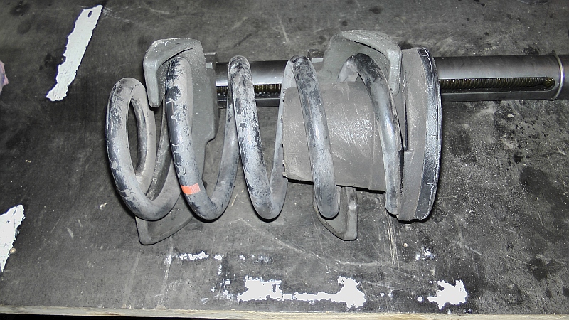

Rear Springs:
4B0 511 115 DP
1 orange
OYQ (weight range 15)
OYR + 2MC (weight range 16) + Sports suspension
Discontinued, possibly replacement but info not given
4B0 511 115 DQ
1 orange, 1 grey
OYS + 2MC (weight range 17) + Sports suspension
4BO 511 115 DR
1 orange, 2 grey
OYT + 2MC (weight range 18) + Sports suspension
4B3 511 115R (Discontinued without replacement)
2 red
Saloon 0YR + 2ME (weight range 16 + Super sports suspension)
4B3 511 115 S (Discontinued without replacement)
3 red
Avant 0YS + 2ME (weight range 17 + Super sports suspension)
4B0 511 115 DP
1 orange
4B0 511 115 DQ
1 orange, 1 grey
4BO 511 115 DR
1 orange, 2 grey
2 red
3 red

I'm keeping notes on all the things I'm doing, and will post further info on this matter shortly, but I don't want to post information that in years to come could be taken out of context and someone falls foul of something because they didn't read the whole thread or someone had cut and pasted information that hadn't been proven.
I've found two Sachs springs which seem to be much closer in specification to the originals, or at least the published dimensions are, so I've ordered a pair of each and we'll see what turns up in a few days.

You might also keep in mind eibach. I used their springs on my RS4 and very good. If they make a set for the C5 S6, they should work well. You'll find that most companies shy away from specific items for the RS6 as no one makes a DRC so they aren't a direct replacement.

Eibach did list a replacement but 15.5mm wire diameter rather than 16.9mm.

Have done some more calcs with the assistance of my brother and his 3D CAD software. Conclusion is that I'm probably worrying unneccessarily and the Audi springs are actually OK. By having thinner wire and less coils, the spring material is shorter by approx 80cm and if uncoiled to form a straight torsion bar would require similar effort to twist. By his calcs, original 88N/mm (502lb/in) and replacements 85N/mm (485lb/in)
