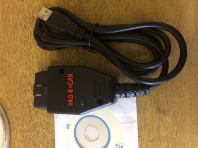

Vag Commander arrived this morning. Just got to pluck up the courage now and do it.

OMG sweegie your a saint. Cluster replaced and re coded remotely. All working and correct milage.

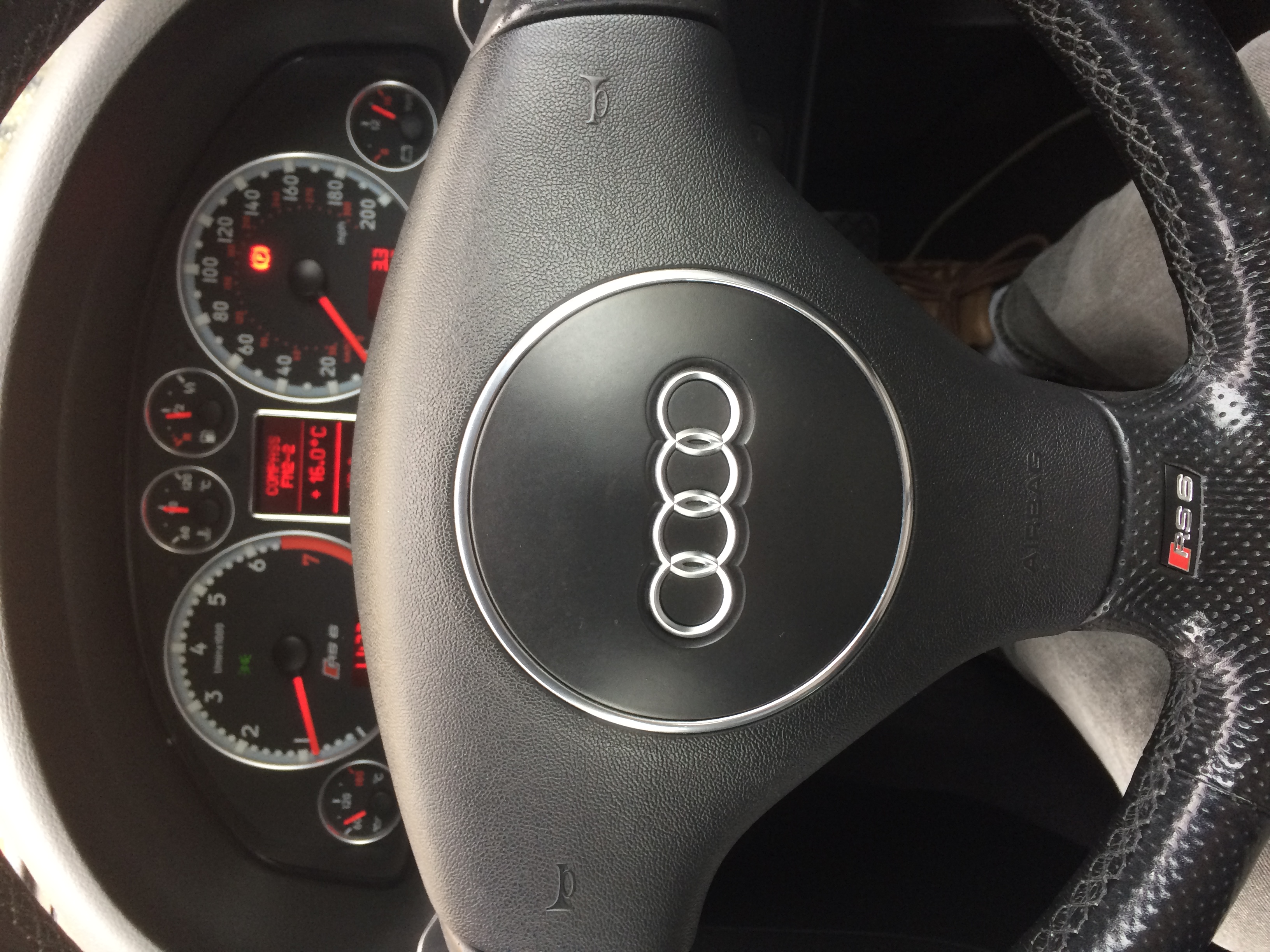

Out for a drive today and noticed the dis display on the replacement cluster is functioning perfectly . How weird !

Don’t know what’s going on with the pixels on the replacement cluster.
Wednesday fitted cluster faded pixels
Thursday pixels ok
Friday faded pixels.
Makes me wonder if I have a bad connection somewhere.
Get my original cluster back in a few days. See what that’s like with a brand new lcd screen.
Thursday pixels ok
