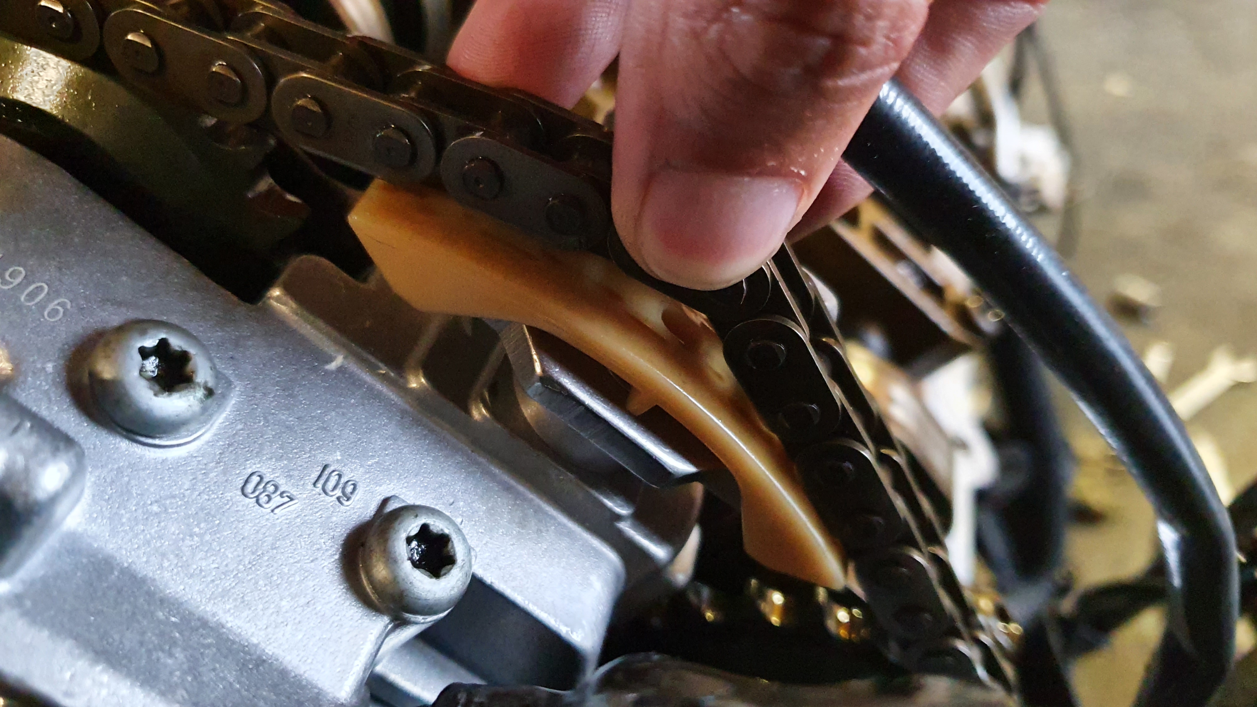

I have noticed that the blauparts shoe (from the US) has slightly different dimensions to the replacement shoes that Nobby originally linked to.
With the blauparts shoe, my cam timing was still a little off (only just in spec) - and it was defo the adjuster - the cambelt and primary adjustment was 100% perfect - even after 5 years when I took it off recently.

The shoes linked to in Nobby's original post are good - they appear to restore the geometry of the cams to a 0/0 position
The blauparts shoes - avoid. Now I've compared, they are slightly smaller shoe. In a neutral position you end up with the inlet cam a few degrees out. 0 ex/5 in or thereabouts. Not great.

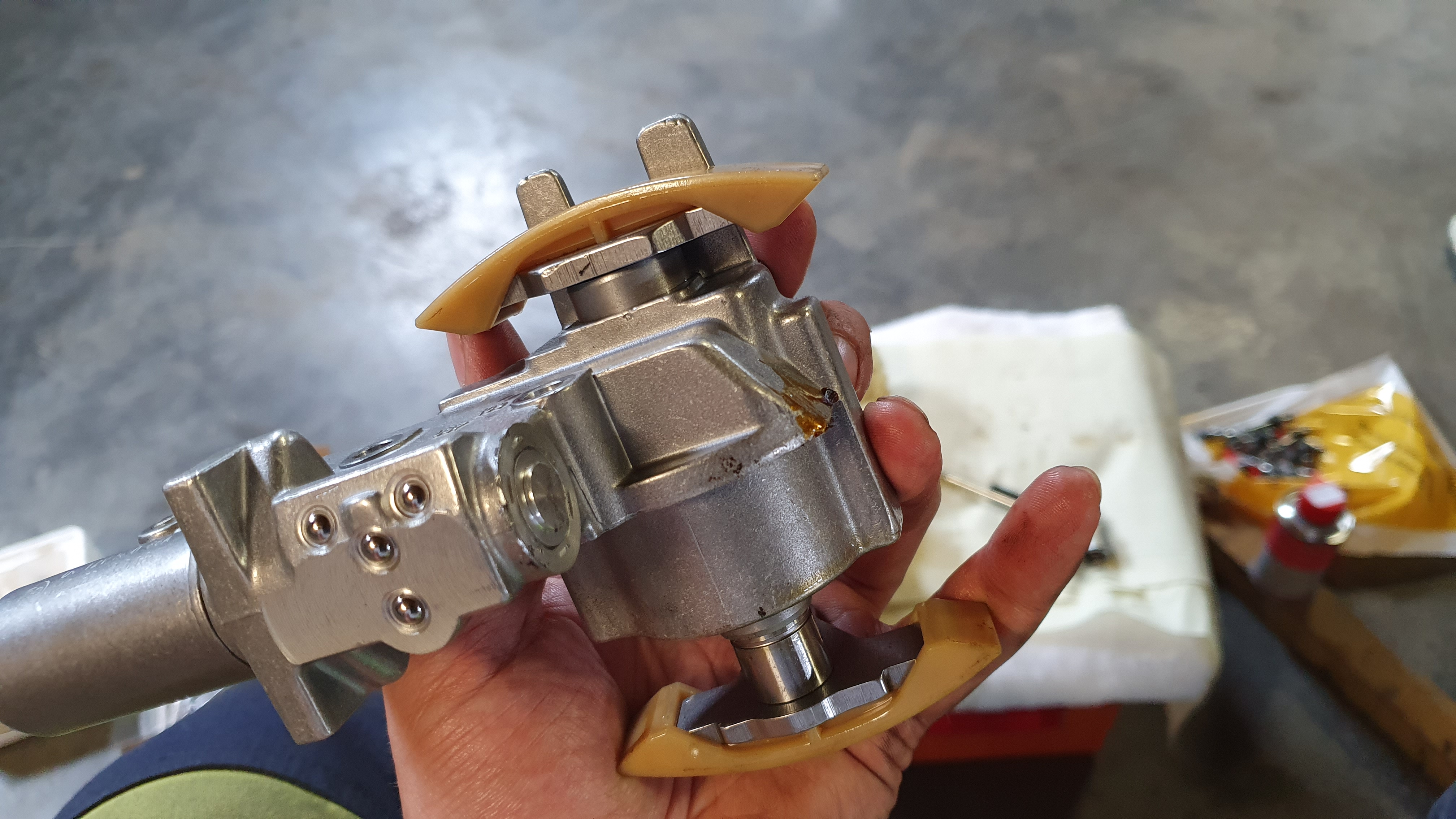

The Vaico tensioner - also looks spot on, cams look 0/0 as well - so looking good so far. Quality of the part also looks fine - quality looks as good as OEM and *does* have the inlet gauze and little valve behind it, just like OEM ones do and unlike the cheap chinese ones. In fact, quality looked good enough and the casting itself looks virtually identical except for the logo, I could well believe they came out of the same factory

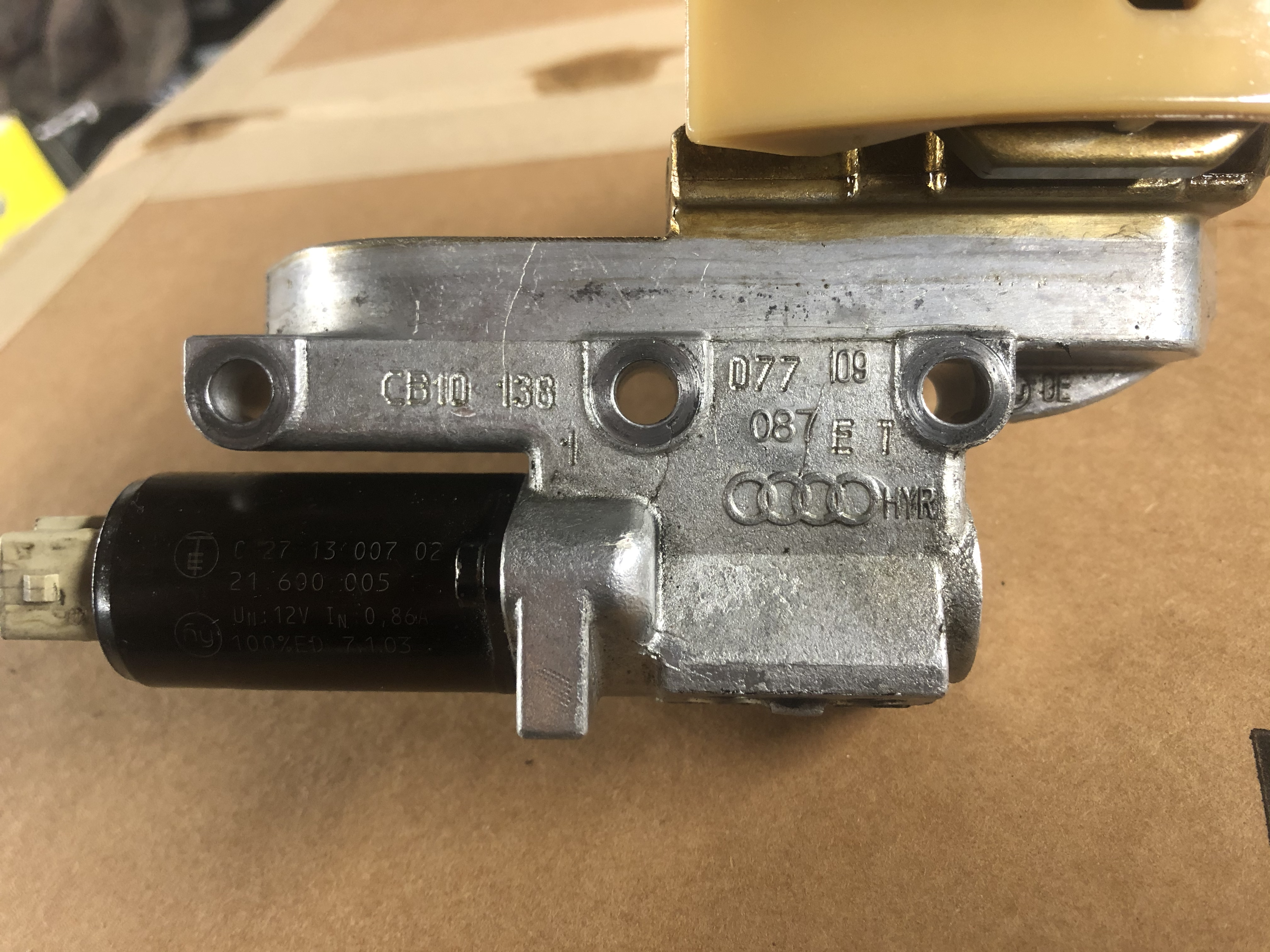

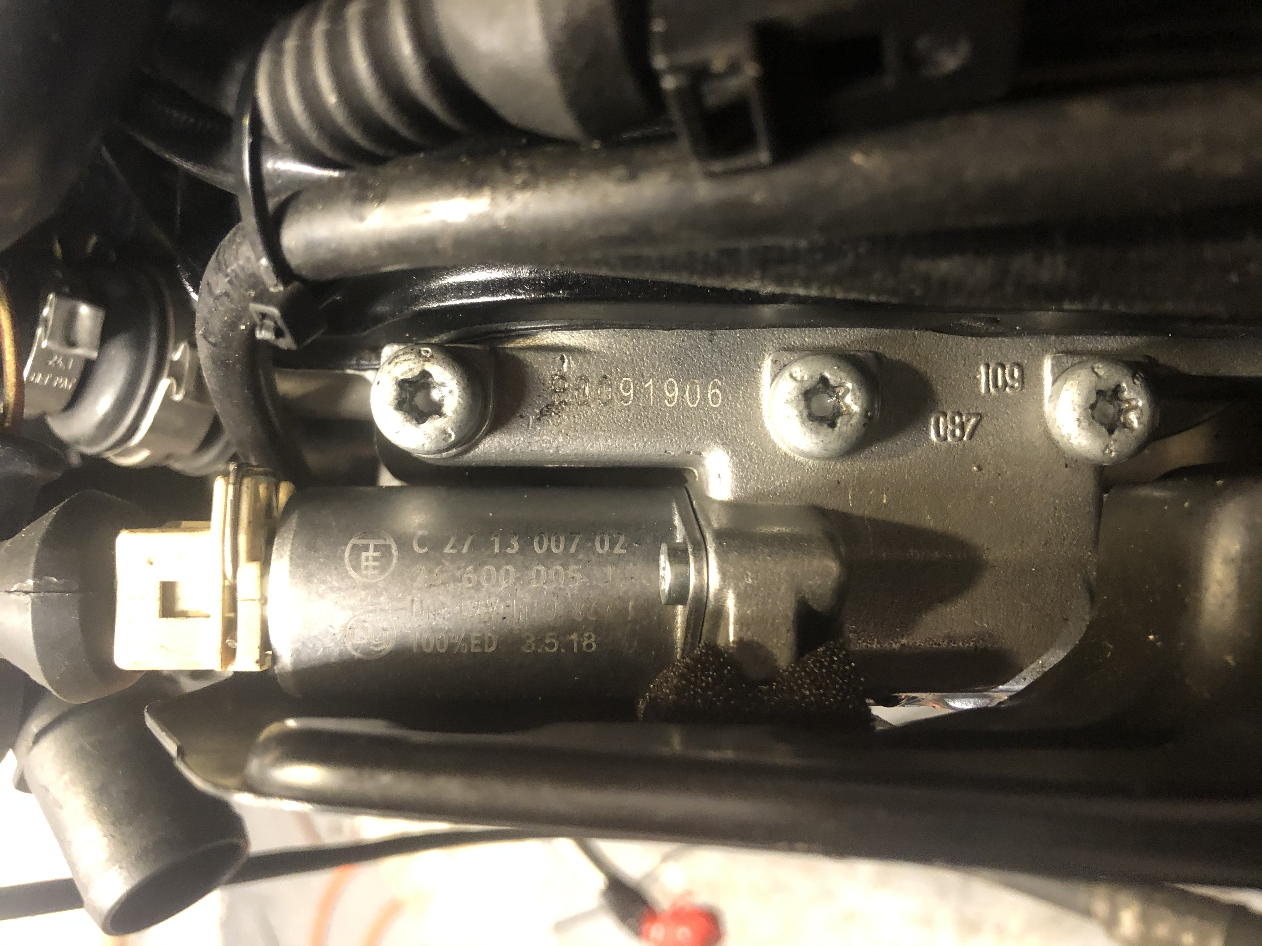

Audi vs Vaico.
Solenoid part no & logos are identical. Except one is datestamped 2018, the other 2003.
The valve body casting - have the same 087 & 109 in the casting. Cast lines and machined faces are identical. There some minor very differences - but looks good to me.
