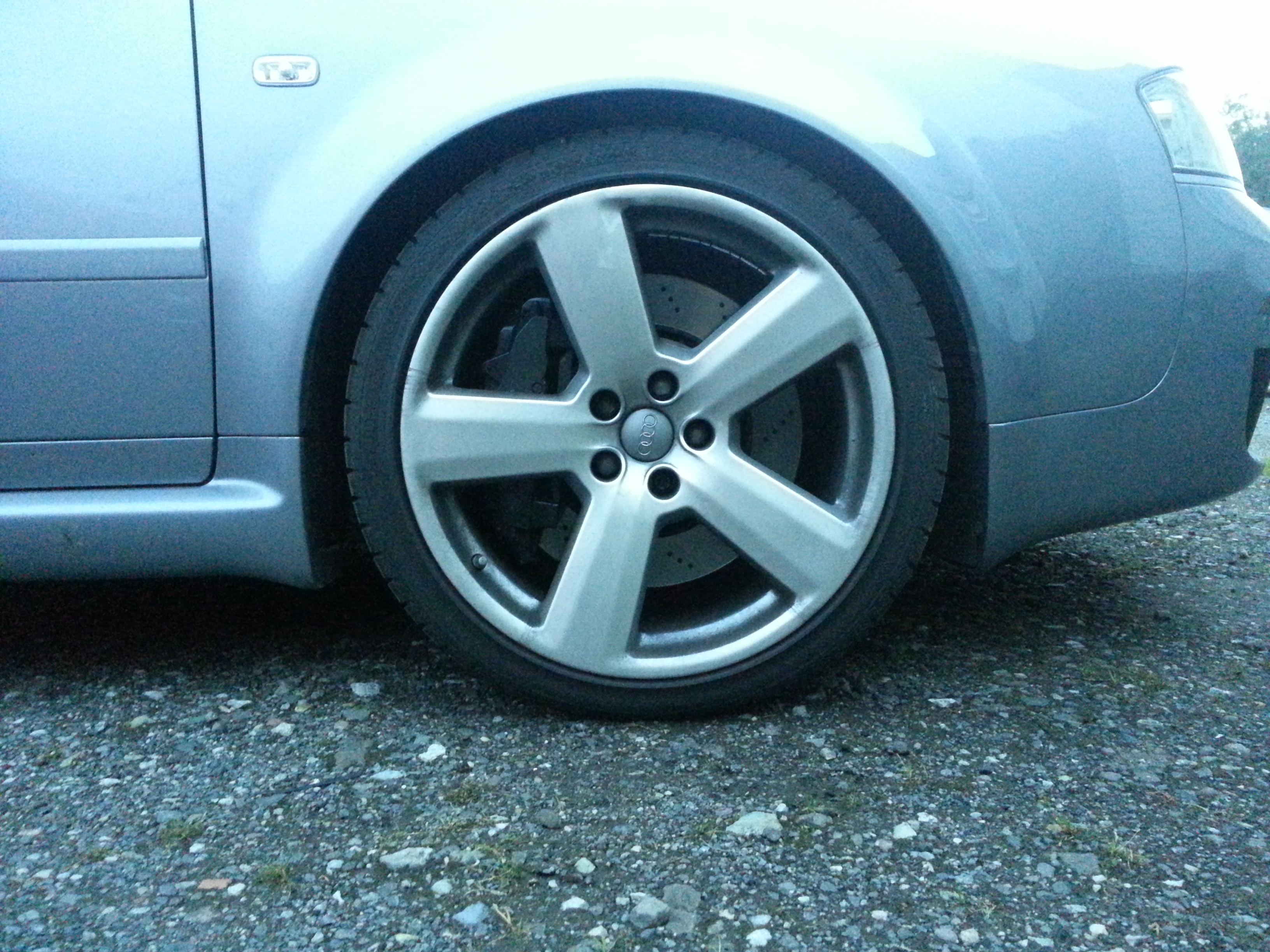

Running update on the car.
I've now had enough time in the car to get to know it's capabilities and started to be able to really push the car, making full use of the power and torque. Maybe it's time for an upgrade 8)
One thing that I'm not happy about now is the suspension ride height.
My car has always been low... much lower than a standard RS6 and I wouldn't be surprised if it's lower than an RS6 Plus too but I don't know for sure as I don't have any figures.
Could I ask for a favour from someone with a stock height RS6 and also an RS6 Plus please? (Must be on 19 inch wheels) could you measure from the bottom of the wheel rim to the bottom of the wheel arch please? This is the most accurate way that I can think of measuring ride heights.
Here's a diagram of the measurement just to be clear.
Mine is currently sitting around 595-598mm all around.
MG
ahoooga
Posts: 1105
Joined: Thu Dec 20, 2012 11:14 pm
Location: Well in front of that RS4
Re: The RS6 project including 5HP24 A transmission rebuild
Post by ahoooga » Sat Jun 29, 2013 9:29 pm
On standard original 19 rims ( 255/35/19 tyres) with stock/original drc suspension
from bottom of the rim , between the tyre and the rim
offside wheel is 61cm , nearside wheel 62cm
measured thru the centreline of the wheel
offside front @ 61cm

Are you sure it's hitting the bump stops and not compressing the springs to the point where the coils are touching (and the spring becoming incompressible)? If it's the latter then raising the suspension will only make it worse.

Post by RS2 » Sun Jun 30, 2013 7:04 am
ahoooga wrote:On standard original 19 rims ( 255/35/19 tyres) with stock/original drc suspension
Thanks for the measurements. I was expecting more of a difference.
Re coil bind... if Bilstein have designed a coil over set (PSS9) that can go into coil bind before the bump stops are active... I think a lot less of them!
Today's jobs will include careful inspection of the front coil overs.
MG
