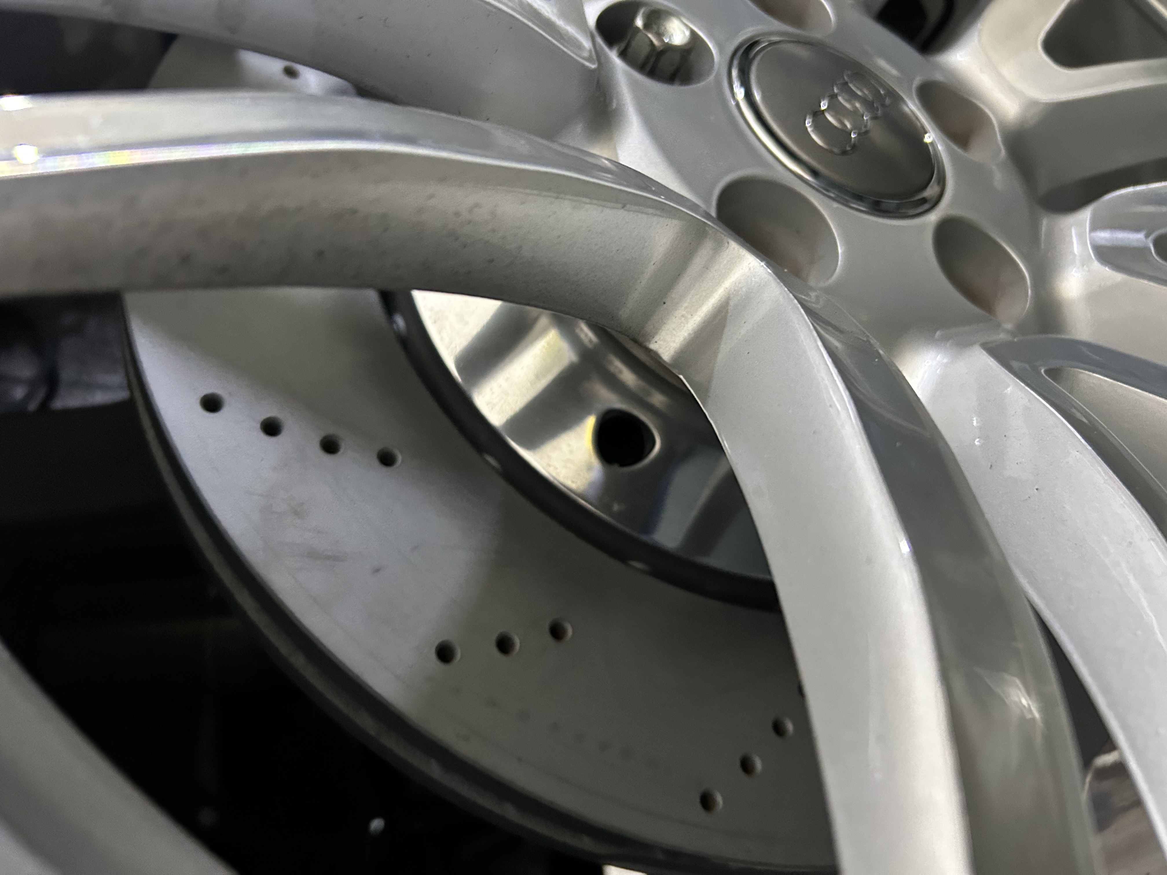

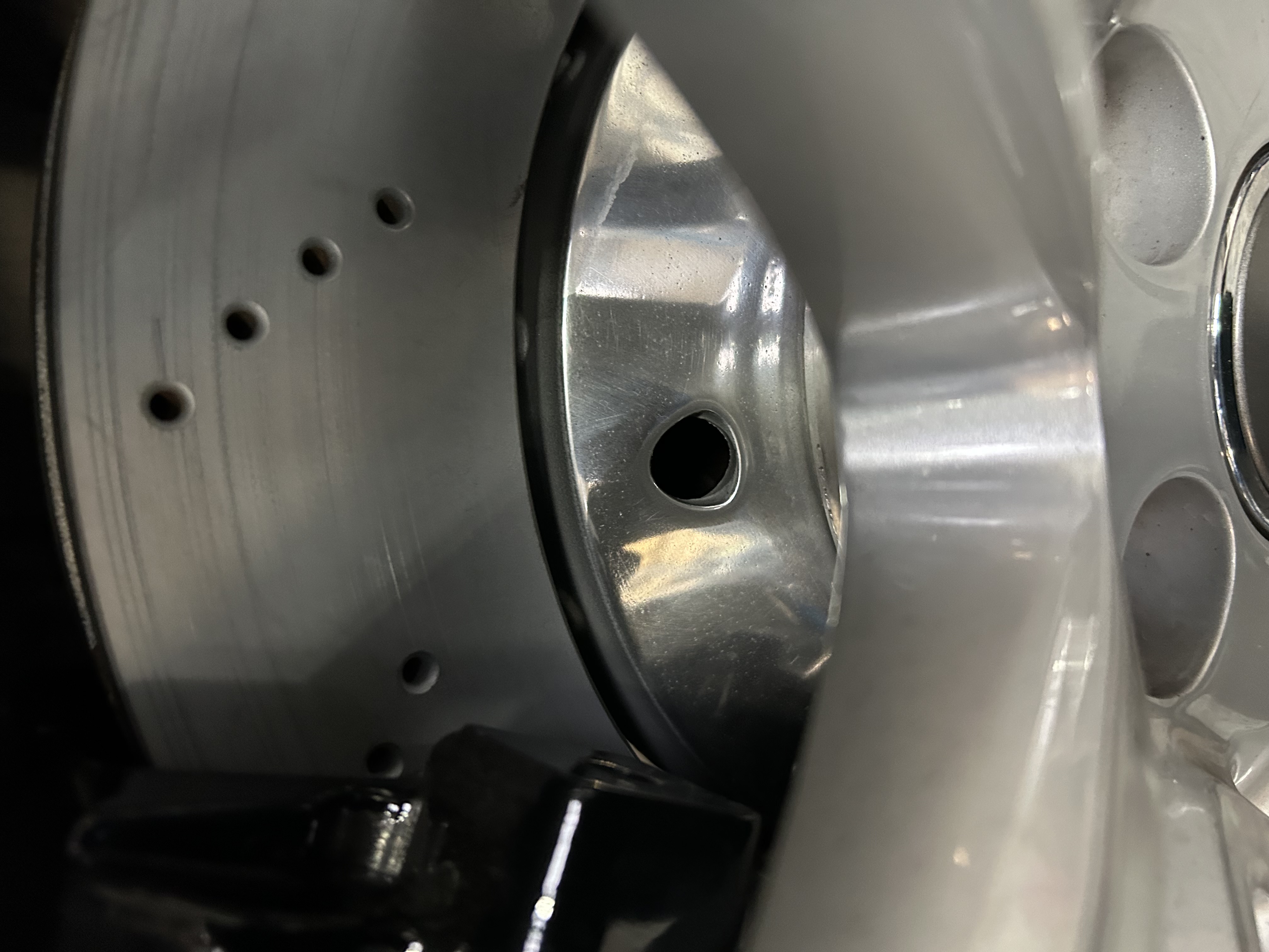

Any idea of the cause of the odd wear?

Not found anything obvious.
All suspension and steering things feel nice and tight
I'd notice a totally shagged wheel bearing
I'm still wonding if the Zimmermann bell is fractionally thinner than an OEM one.

Same thing has just happened to my friend's recent Skoda Superbe which is completely standard in every way. It's a mystery, too.

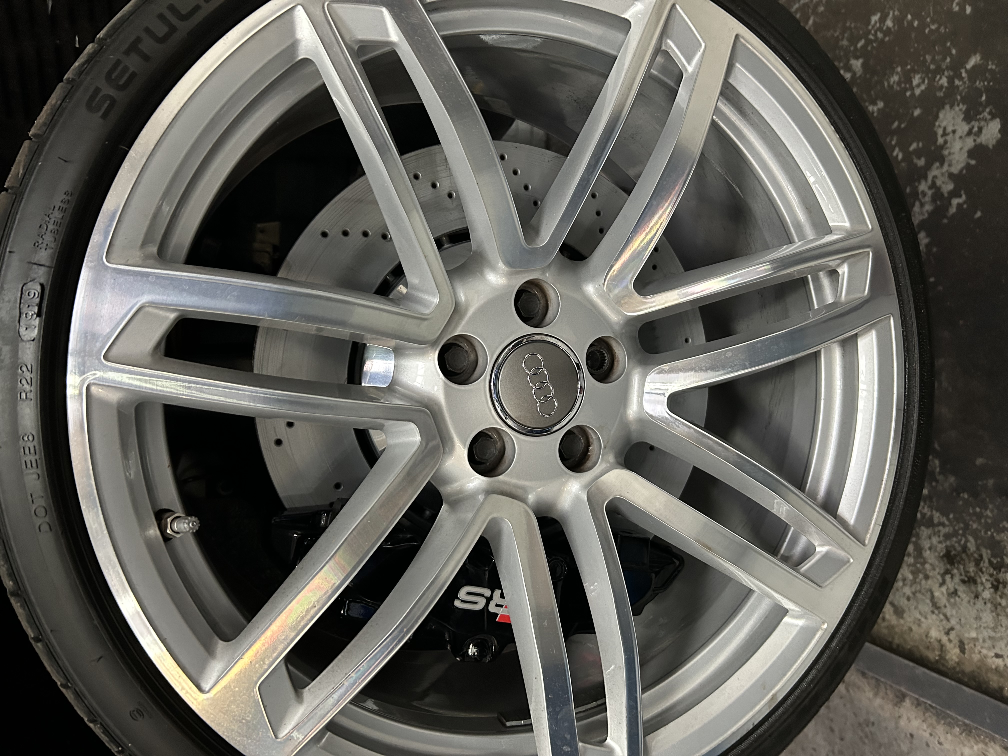

Car is back on its wheels again ready for tyre man to come round tomorrow.
Car appears to have a yellow brake warning on dash, so need to check this out next. Is there anything else that can trigger it apart from front pads and low brake fluid. Gut feeling is poor connection for the front brake pad sensors.

Re: front brake pad recommendations
No, that’s it I believe. Easy enough to test by short circuiting the pad sensors.

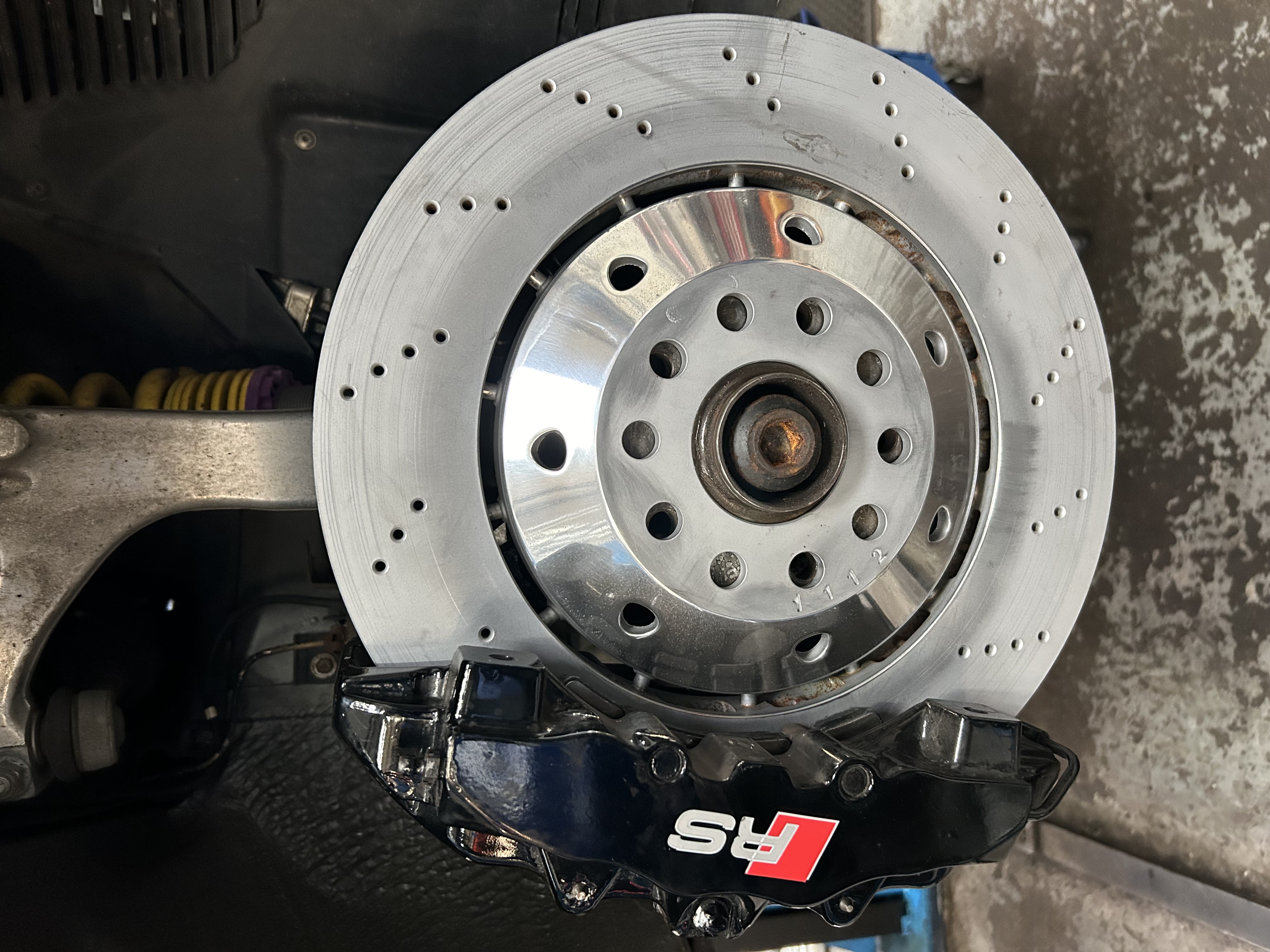

Finally got round to fitting these today!!
Haven’t driven it yet as I’m doing the drivers door latch.

If you still have old OEM discs, could you measure thickness of the brake disc bell - where wheel bolts through disc to hub?

Yeah I still have them, I’ll measure them on Monday and let you know.
Hi Mate 8mm is what I make it.
Forgot about this. Remind me on Thursday or Friday and I’ll measure mine too.
