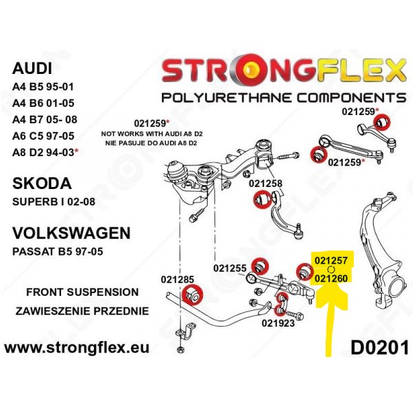

I've spoken with Strongflex who have confirmed I can return what I don't use. I'll get the complete set and replace what needs replacing only.
When ordering I'm asked "Check the width of the Front lower wishbone outer bush before buying. There are two widths of the bush, 49mm (021257A) and 37mm (021260A)."
Does anyone know if the 2002 Avant is 49mm or 37mm?
