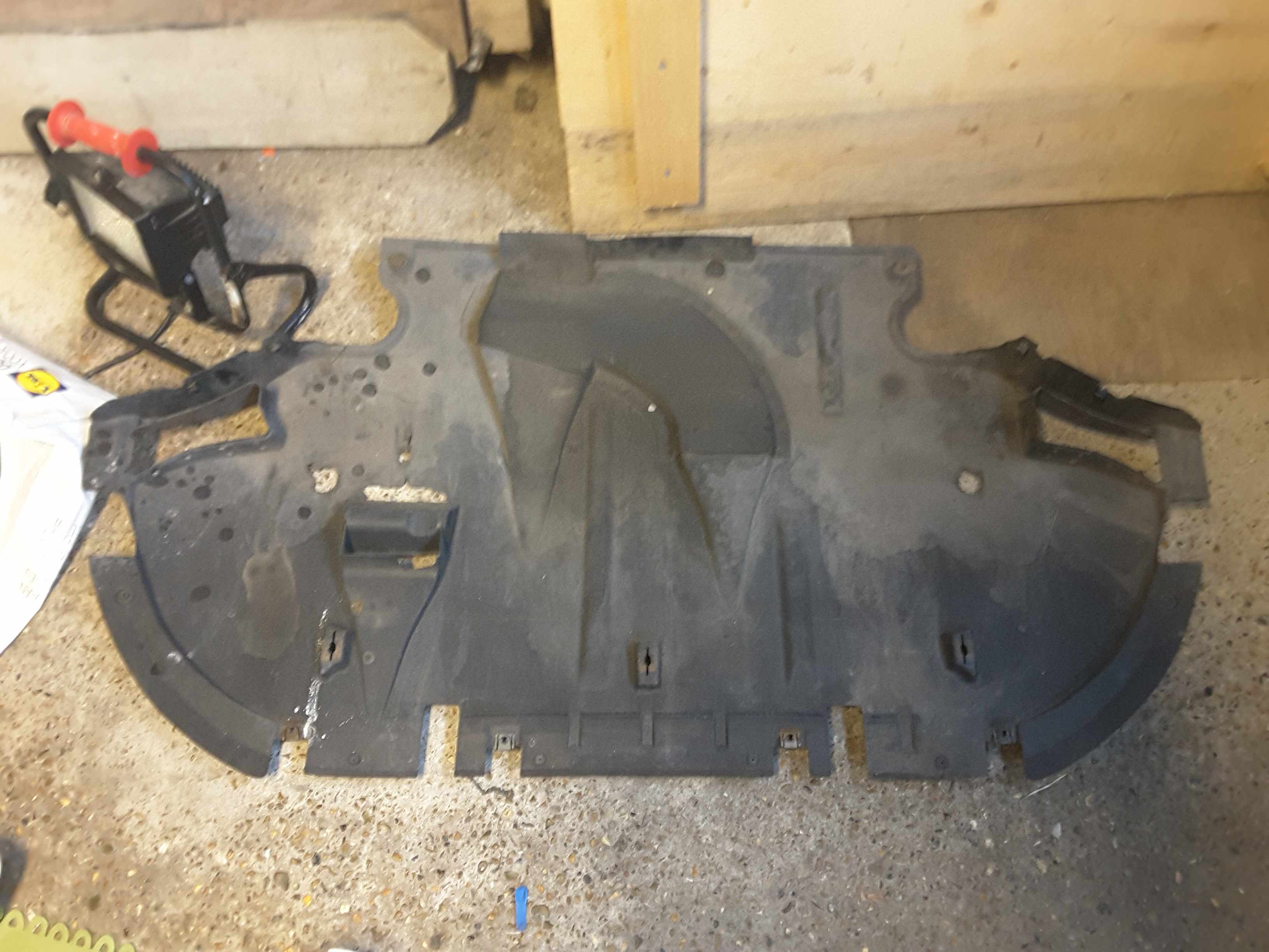

What nm do i have to use to refit the drain plug?
I might do the sportec mod while its out, as you can see, it already has some nice vent holes in it....

Did you end up doing the Sportec mod too?

No i had to use the 6 so had to hurry gettting it on the road again....
Will do it in the near future, its not that a big deal.
