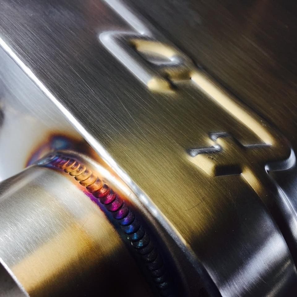

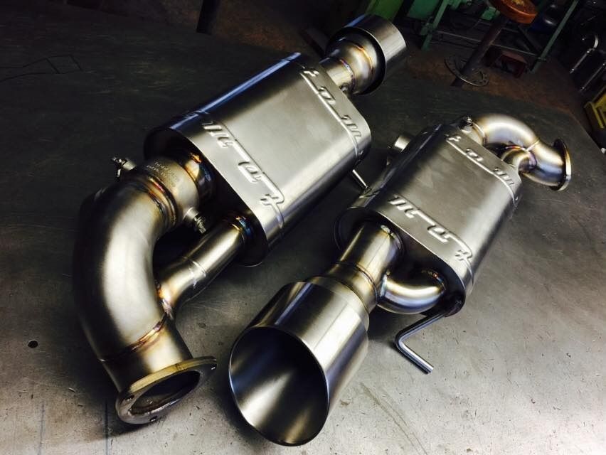

Post by TTE Si » Wed Oct 21, 2015 9:54 am
Exhaust Upgrade from the masters... F-TOWN
duel 76mm valved with 100cell cats
Allready performance feels improved and boost pressure raised now on same tune. We will remap and test see what this brings,
Looking at intake options now
