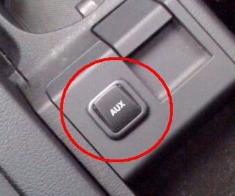

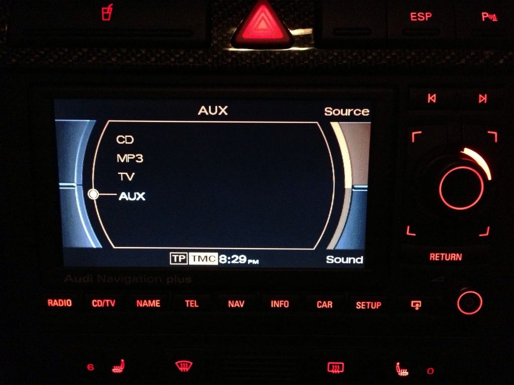

Re: RNS-E, have I bought the right version?
Get this for your AUX, it is OEM Audi and about £10. Part number:
8J0 035 475
Then get the guy to code the AUX thing in so it is one of the available sources.
8J0 035 475
How is the AUX-in wired in?
