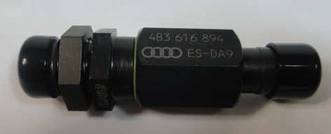

If you get a chance, can you update the document with the Audi quick coupling part number before that ebay link dies?Mr Footlong wrote:Meh, you never know and was a bloody nifty little job you did with all that. I have altered it slightly with a paragrpah of text at the top and a link to this thread. Have stuck it in the root and the RS6 area and have shifted the whole site to one of my more flagship web servers
4B3 616 891
Ta

Gents, question for you UK guys. Anyone have the quick connect part (4B3 616 891) they want to sell? I am in the US and will pay the required shipping? Also, if anyone has one handy, can you take a few close up pics of both ends and the whole thing? I have extra DCS bits sitting around and I might try to fabricate the quick connect part from the bits.
Thanks!
Thanks!
03 RS6 :: 01 allroad
Re: DRC versus pot hole
alrightroad wrote:Gents, question for you UK guys. Anyone have the quick connect part (4B3 616 891) they want to sell? I am in the US and will pay the required shipping? Also, if anyone has one handy, can you take a few close up pics of both ends and the whole thing? I have extra DCS bits sitting around and I might try to fabricate the quick connect part from the bits.
Thanks!
Try giving MRC or Unit20 a call mate, they have removed most of our drc units.

Hi
This is an interesting thread. I still have the DRC system on my car. I got all four shocks replaced three years ago, have not encountered problems so far and was thinking of recharging the pressure and checking the system for leaks. I see that you require a special coupler part number 4B3 616 891 as shown in the picture below.
Does anyone know which thread connection type and thread pitch this coupler has? The picture showing protector caps on the end connections, so hard to see. It is an Audi/VW part so I guess it is metric M? thread, but which size and is it female or male thread? Please advice.
Thank you and regards.
