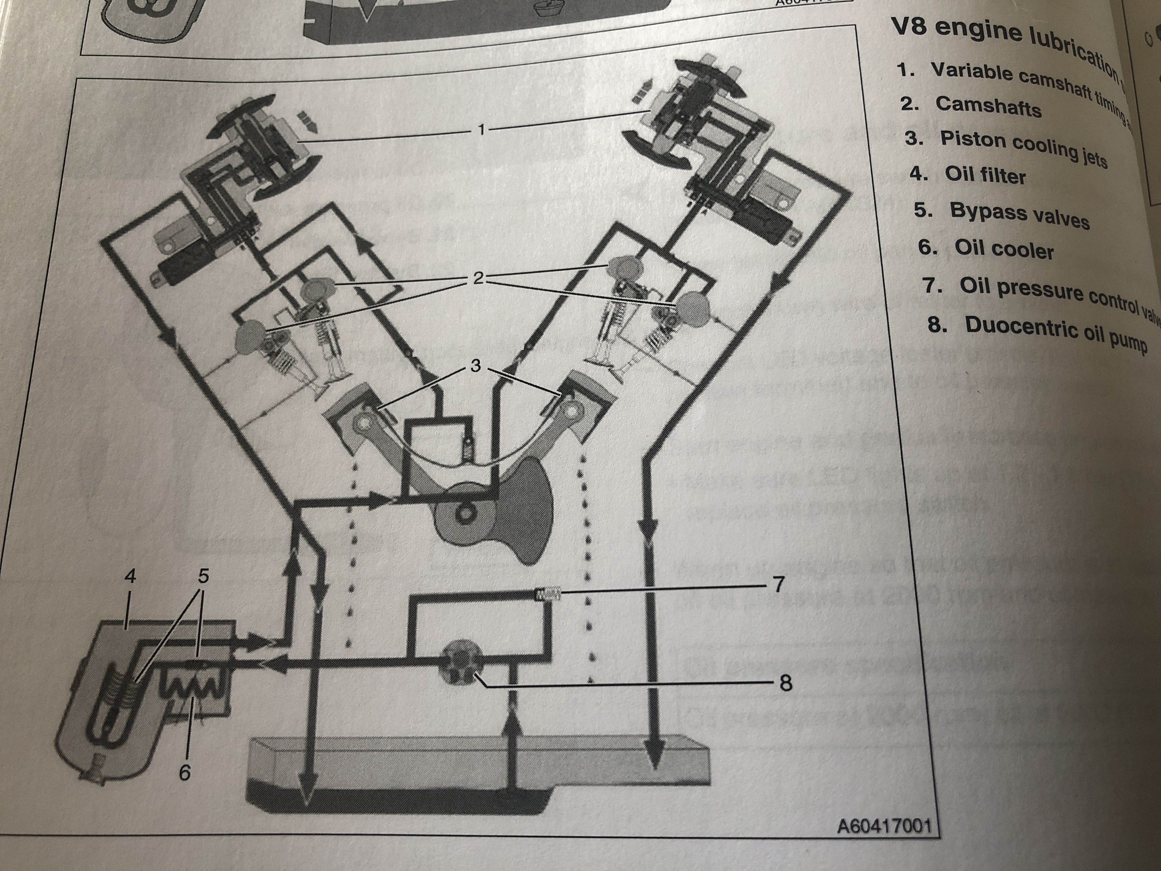

- Posts: 2955
Re: Oil leak continues
Turbo oil in pipe. Thats pressured so would expect a lot more oil leaking.
Turbo oil drain pipe- done twice.
Cam cover seals. Cleaned and inspected. Appear to be dry.
Crankshaft oil seal below leak ?
Oil pipes ?
Oil coolers below leak ?
Oil pump is below where the leakage is.
Just waiting on advice at the moment.
