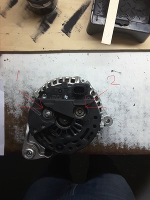

Being euforic getting the bastard out, i forgot which connection to use, 1 or 2...think it was 1
Apart from that, the number on the new regulator is BR14 MO F 00M 144 146...

Re: Alternator time
I would suggest 1 as 2 doesn't have the cable cutout , plus doesn't look as of it has a thread sticking out of it.

Re: Alternator time
2 holds the reg pack on, 1 is the output. I changed one last week on a golf diesel looks exactly the same. The small Phillips head screws were very tight but I was changing it in situ.
Re: Alternator time
Ok thanks guys, its going in back today.

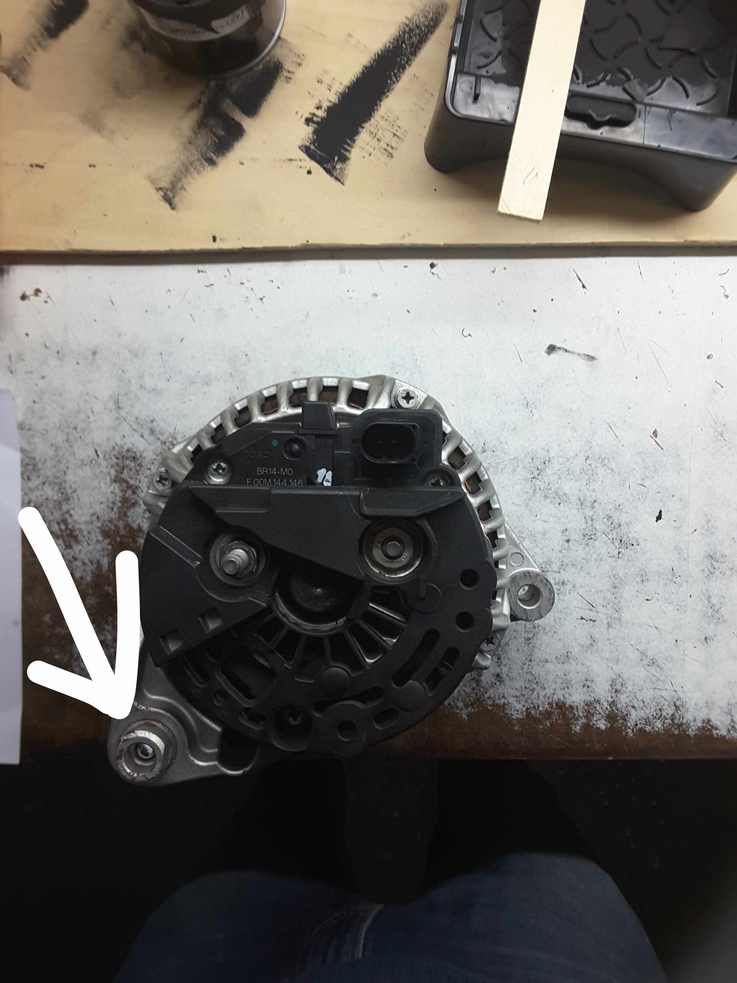

By the way, i pushed the bush shown in the pic a bit so it Will fit more easily...

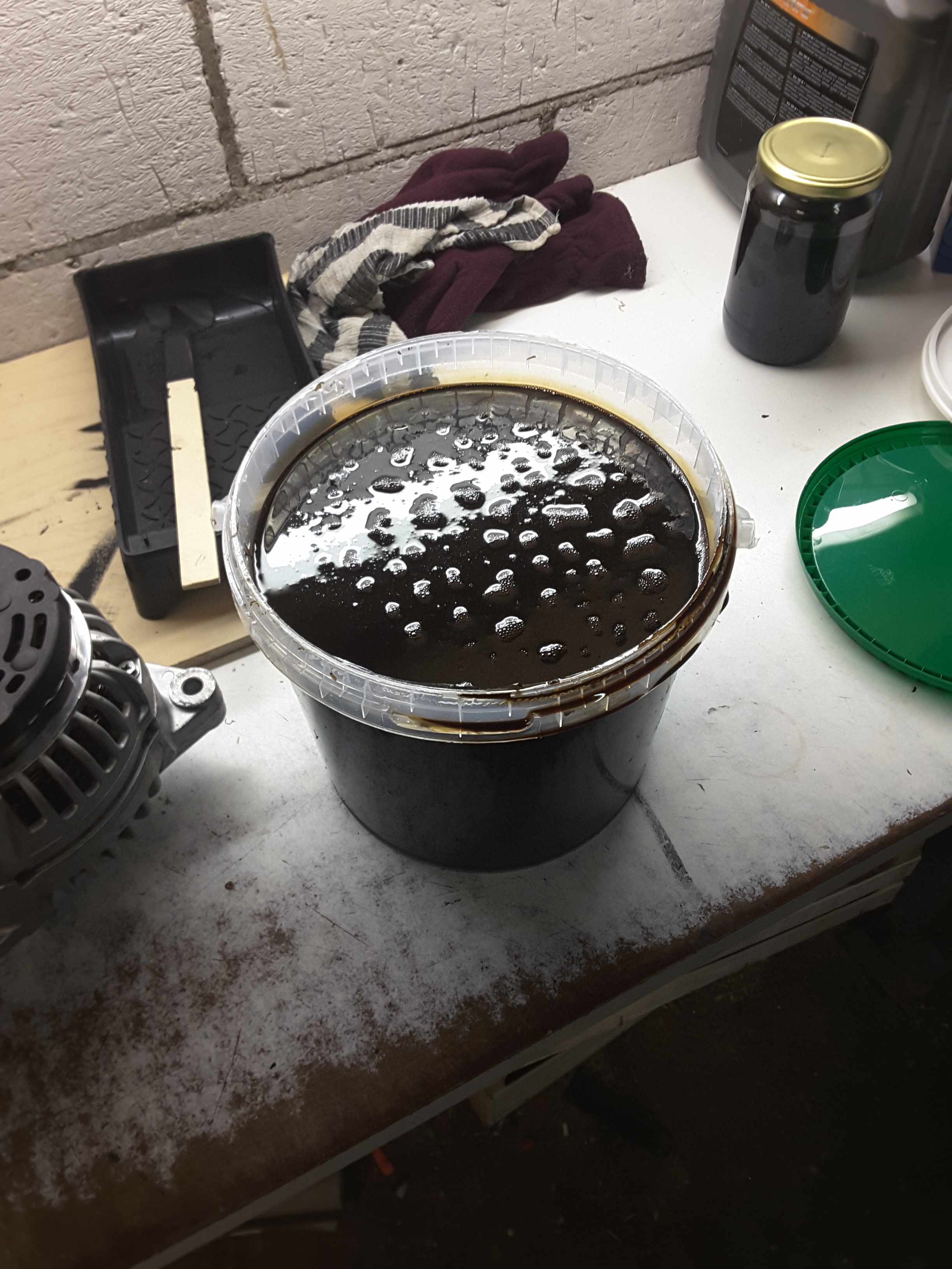

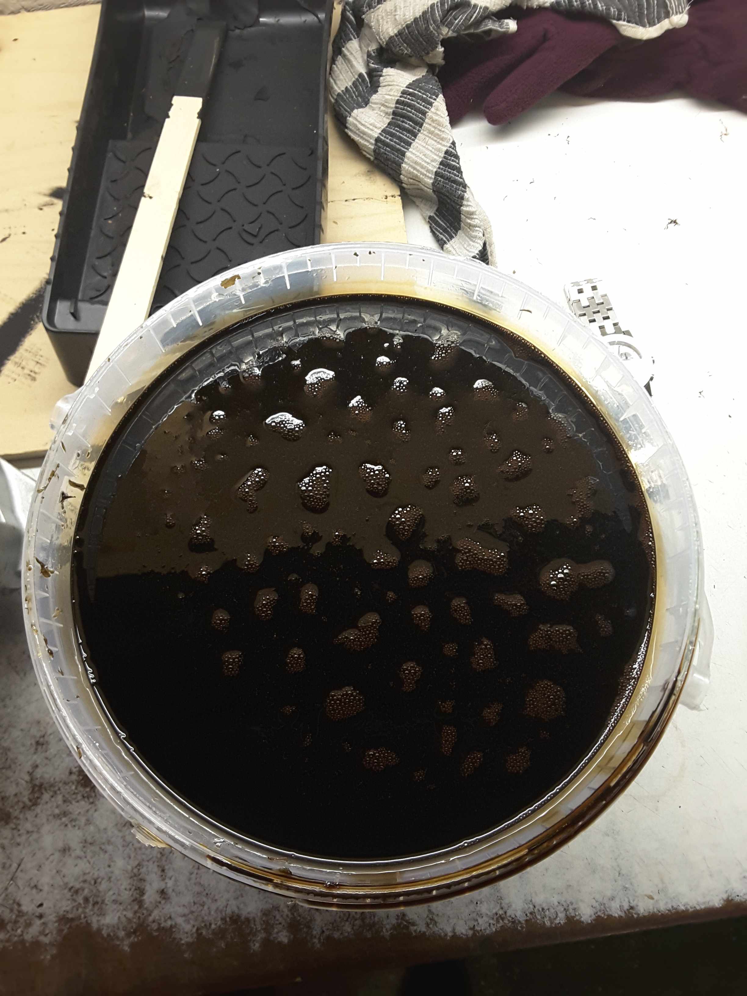

Old oil out, pretty Black, smells like petrol....

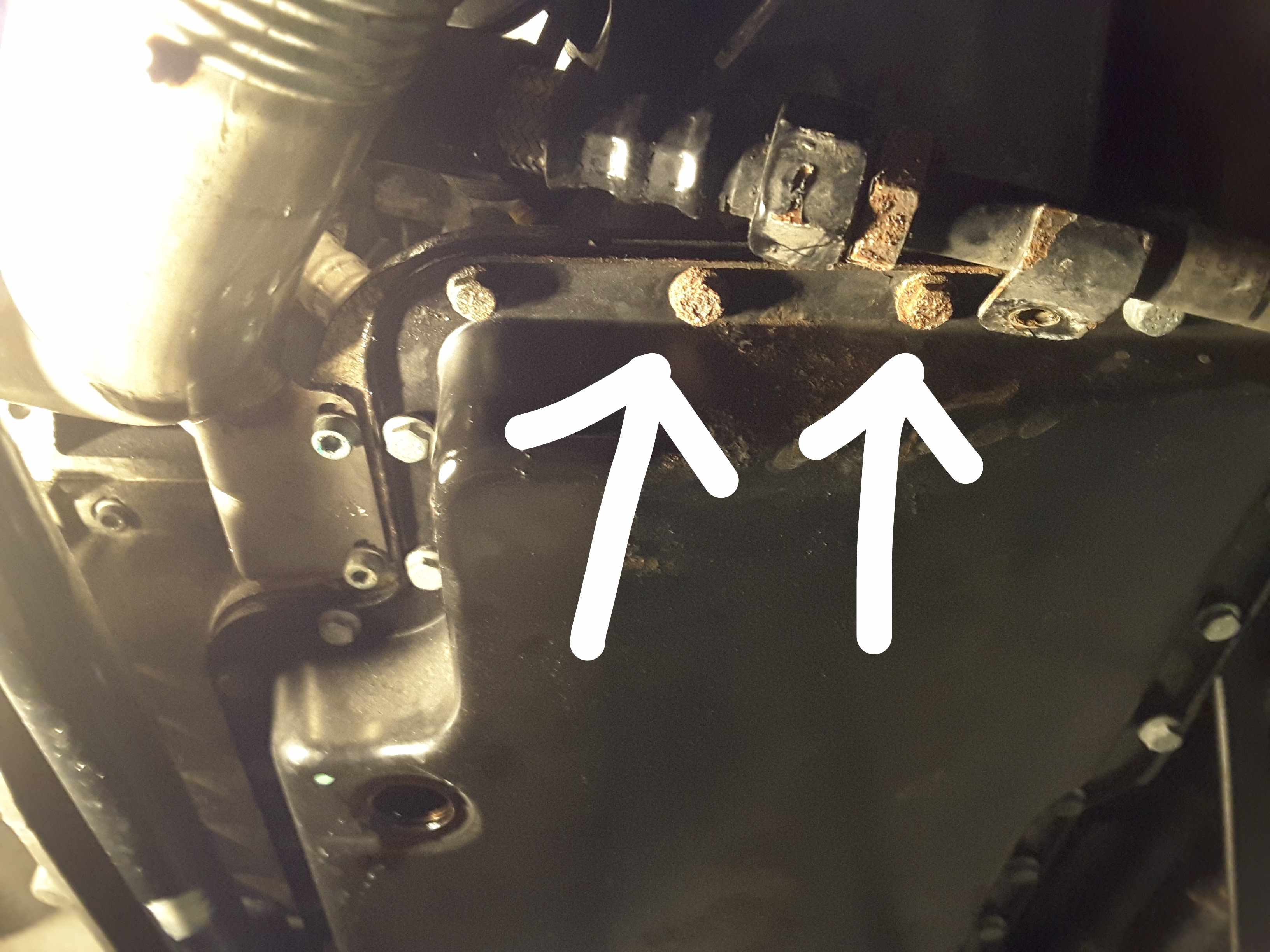

2 pretty bad rusted bold here, Can i just replace them with New ones or Will it be a risk regarding the gasked/start an oil leak? .....

Re: Alternator time
I would change them one by one. And torque the new ones up correctly.
