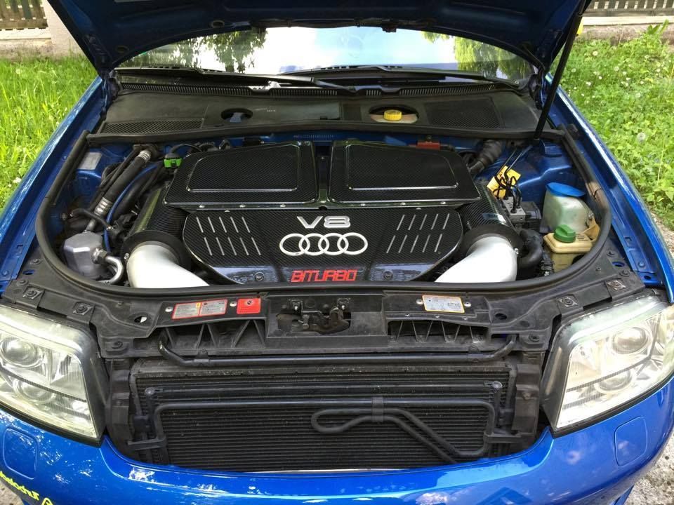

All is good just sort lost the will to update here lol
Had the car dyno'd at 680ps 910Nm @ 1.2 bar peak 102 fuel (no WMI)
Going bigger custom exhaust hopfully F-Town duel 76mm valved, we feel is a big restiction just now and then re tune / dyno.

Re: RS6 Project 7XX
Post by bam_bam » Sun Sep 13, 2015 8:57 am
Looks a billion times better without that vinyl all over it.
Get rid of that airbox, that'll be restrictive.

Yeah i agree.
we are not sure what to do on the intakes/filters..? there was mention on somone using jag parts maybe ?
Re: RS6 Project 7XX
Post by bam_bam » Sun Sep 13, 2015 9:11 am
If I were in the same boat, oh wait, I am... I'd build an air-ramp from the front to the scuttle wall and have it all seal against the bonnet. Then use a double mushroom filter (probably not the correct term, it's just what I call it) sat on top of both intakes.
It's a very similar setup used on the RS6 GT race cars.
p.s. still think that the hotsides are too small.
