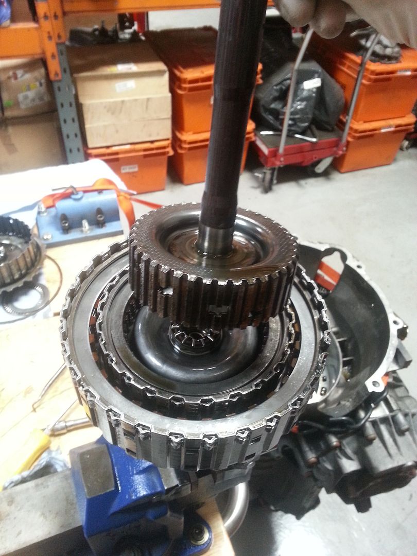

Right,
I took today to finish the rebuild of the transmission.
I started off taking lots of photos and then as things got more busy and I started running out of room and time, they stopped. Sorry.
So I got a delivery of seals etc from CT on Friday (Thanks Mark!) with just about everything I needed. I forgot to ask for the 2 small seals that sit in front of the lower bolts which hold the oil pump in

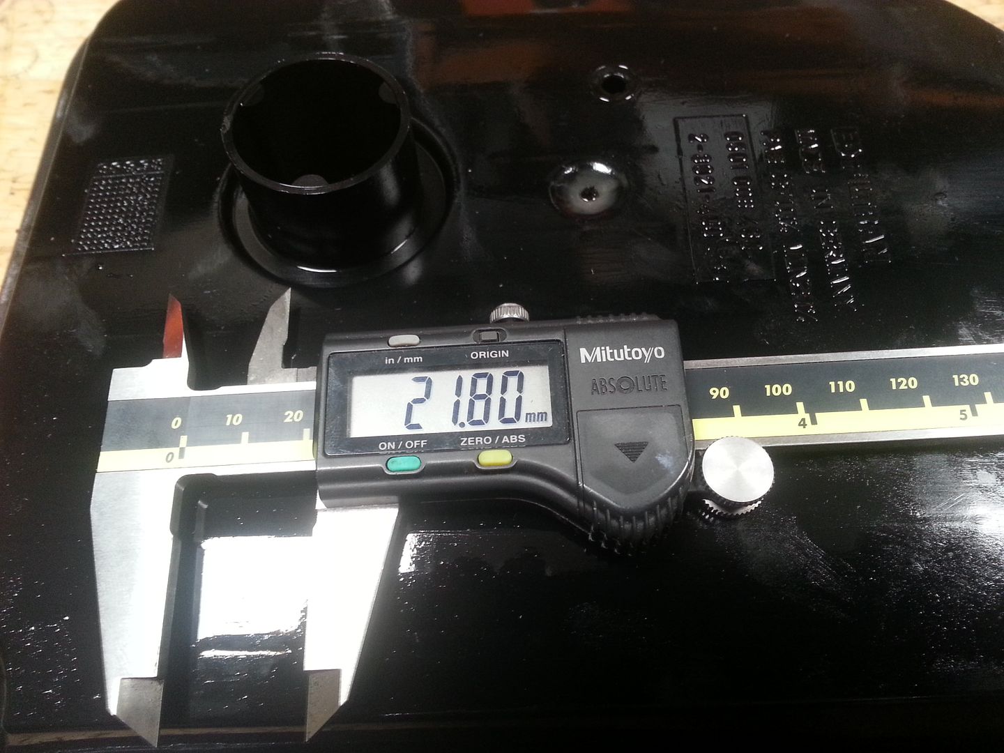

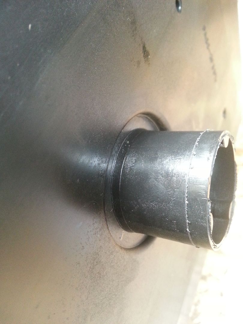

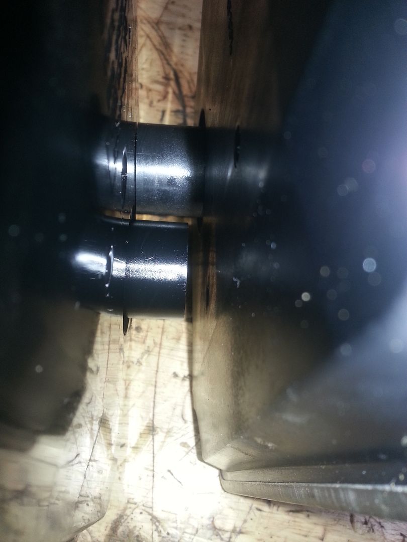

After the confusion over depths of sump pans, filter tube length and oil level, I decided to measure old and new and the depth of the sump to see just how much clearance I had with the old filter.
Oh, I found the date on the old filter and it confirms that this is the original filter from 2010.
The original filter tube length...
The new filter tube length...
I measured from the sump mating surface to the deepest point = 90mm.
With the new filter bolted in place, the distance from the bottom of the tube to the sump mating surface = 90mm !!
As the photos confirm, I needed to trim 5mm from the tube.
This is a fairly scary thing to find out. I could imagine that many people could end up ordering a standard 5HP24 filter and not think to check the length of this and it's bye bye transmission!
I scored around the tube and removed the 5mm section.

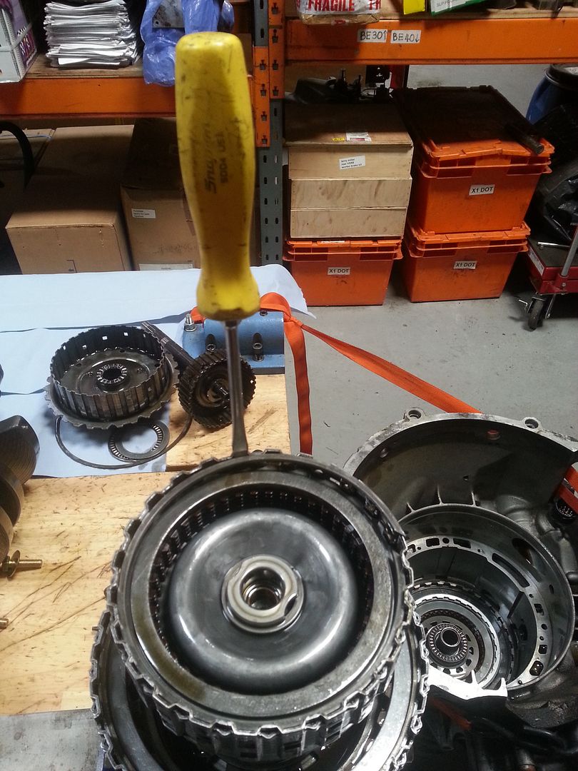

Onto the clutch discs and seals surrounding the area that had suffered in my transmission.
We've seen this before but this is our starting point.
Slowly removing parts and nothing what went where and setting them out on the bench on clean paper etc.
The large circlips that hold each set in are easily removed.

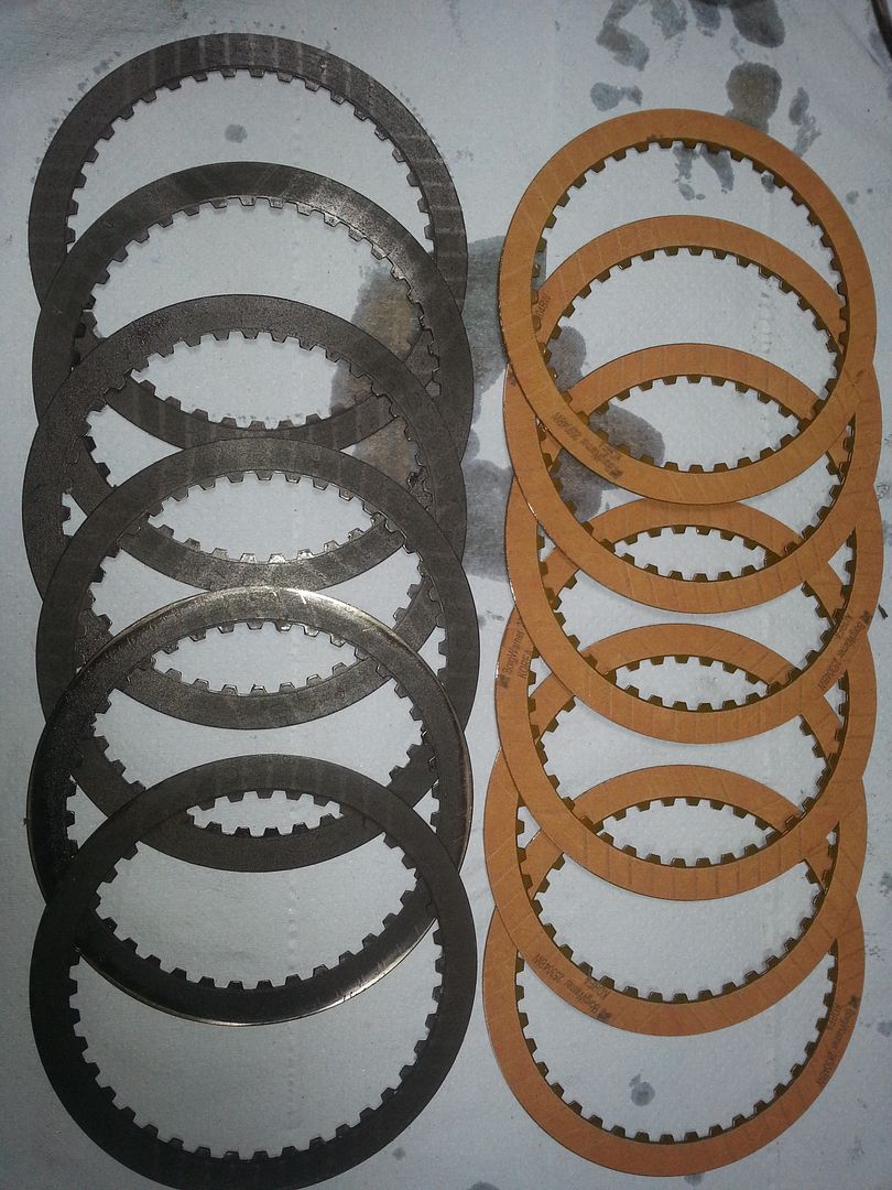

Mark felt that as the clutch discs in this centre clutch pack have suffered, the o-rings surrounding the piston should be changed also.
All of the clutch friction and metal discs laid out.
New and Old. You can see that the worst friction disc has worn through to the metal on the edge.
The piston and it's O-rings.
Everything is cleaned and refitted in order.
The O-ring which causes the most issues. This is the one that usually fails when the bearing between Clutch pack A and next setup fails and looses drive in 1-4th gears.

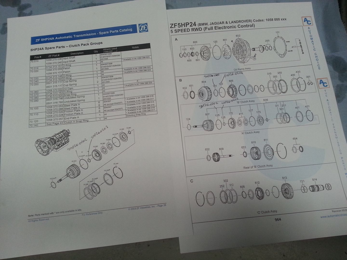

Having a couple of diagrams from downloaded PDFs makes it a lot easier to work out which part goes where!
I'm afraid that this is where I started running out of room for parts and time was short so the photos had to stop.
