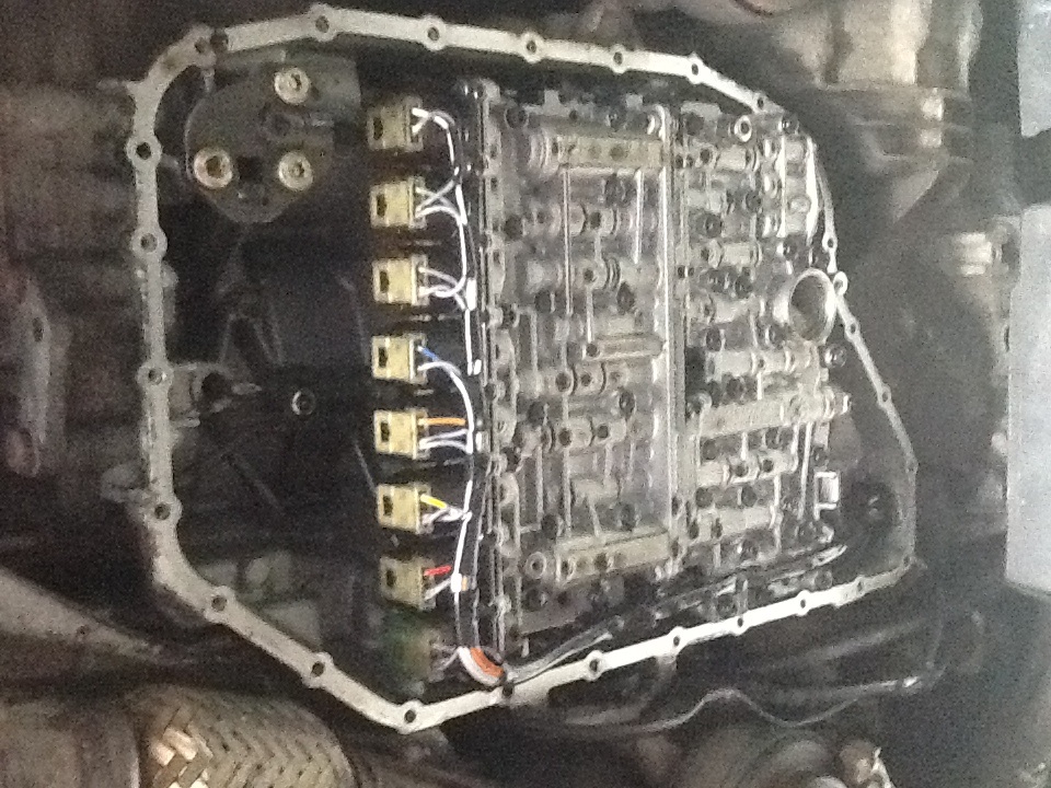

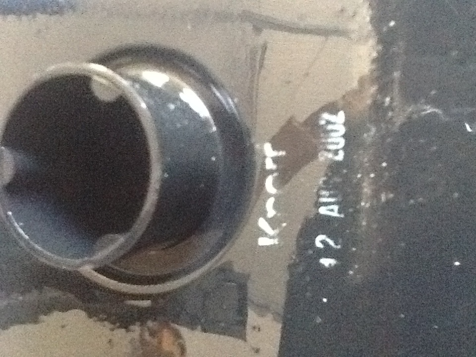

At independent specialist right now and he's opened the gearbox to replace the ATF. Surprisingly, original filter and fluid in there, looking very clean even after 210,000 kms.
Worringly, he mentioned to me that changing fluids can cause gearbox problems
Only after he'd opened it out of course..... So, hoping now with fluids replaced that everything will run as smooth as it did for the last10 and a half years. Original gearbox, original ATF, let's see how the new stuff fares...

It can't cause failure. It can only show up faults that were there anyway and about to result in box failure.
It's like replacing the sawdust in the coolant system with water and then when the radiator leaks saying it's because you put clean water in.

Listening to him talk about the system, I think now that this is what he meant. That codes would be thrown up, become more apparent with imminent box failure etc. after ATF change.Shoppinit wrote:It can't cause failure. It can only show up faults that were there anyway and about to result in box failure.

It's a good sign that the old ATF is in good condition.

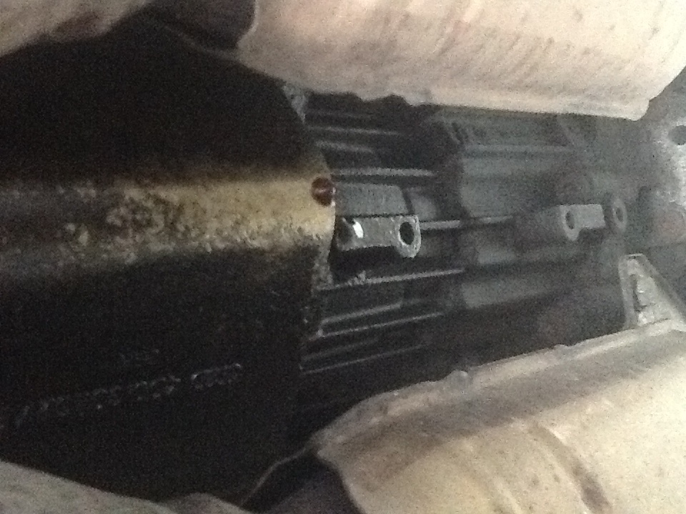

So, had the ATF changed and drove the car home. Left it sitting up for a while (almost two weeks) and when I returned, there was a large puddle of ATF under the front leftside. As there has never been a puddle there before, I called the guy who did the ATF change and the car is now on a flatbed on way to specialist to have a proper look at gearbox to salvage what can be salvaged before it eats itself. He was very apologetic and pretty embarrassed about it so let's see how long it'll take and how much it'll cost to put it right.
Feels like clutch is slipping, even when in tip mode up and down the gears so I've asked that it be pulled apart and examined, rebuilt as needs be.

Specialist just called to tell me that my torque convertor is not closing.
Doesn't explain where the fluid leak is coming from though....
T/C replacement is hopefully straightforward enough.
