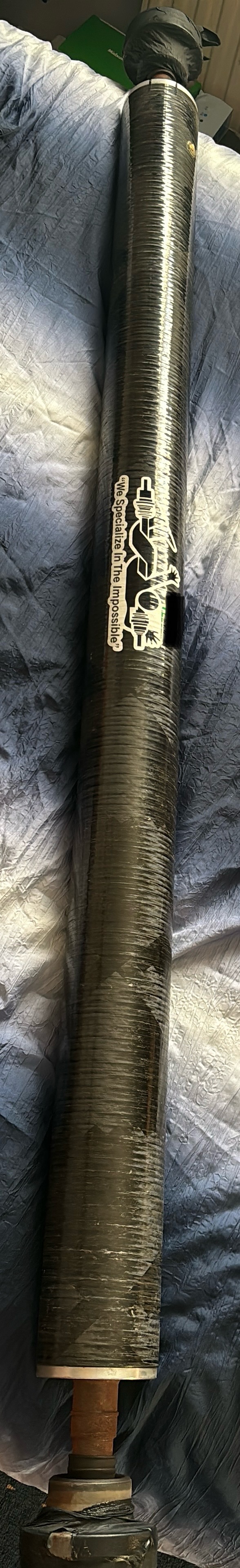

1x carbon fibre pro shaft arrived today👌🏼
I can’t wait to get back home and open the box on Friday

Post by Sxcarmyboi » Fri Mar 15, 2024 6:23 pm
Well I have got home from work and unboxed my package😍I am in love with my carbon fibre prop shaft for my manual swap conversion
I have also received my drive shaft spacer too

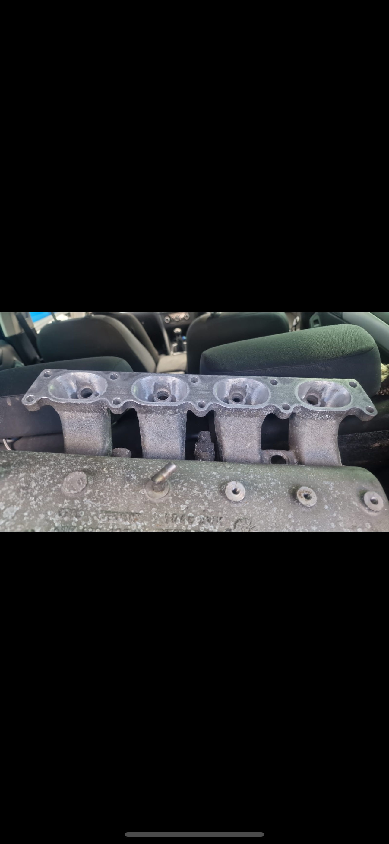

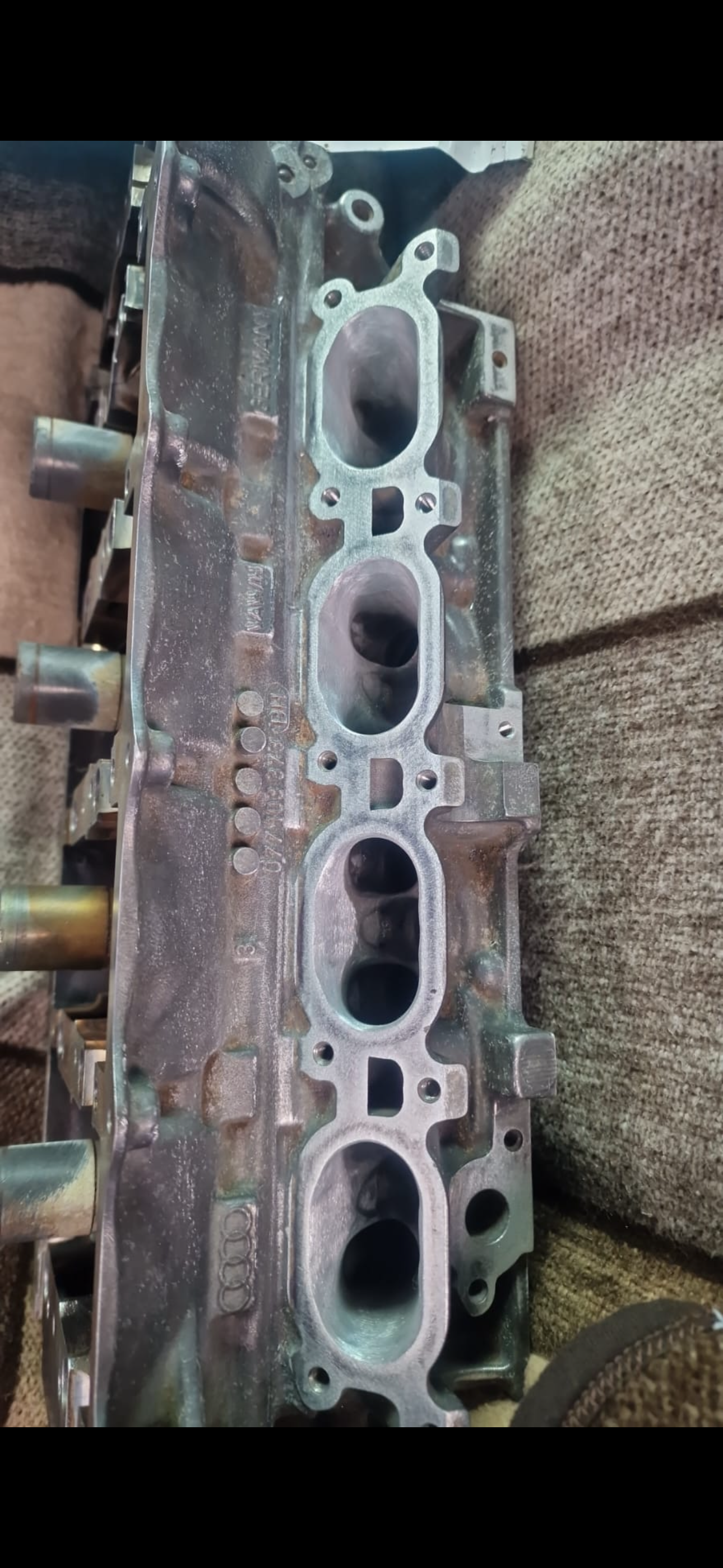

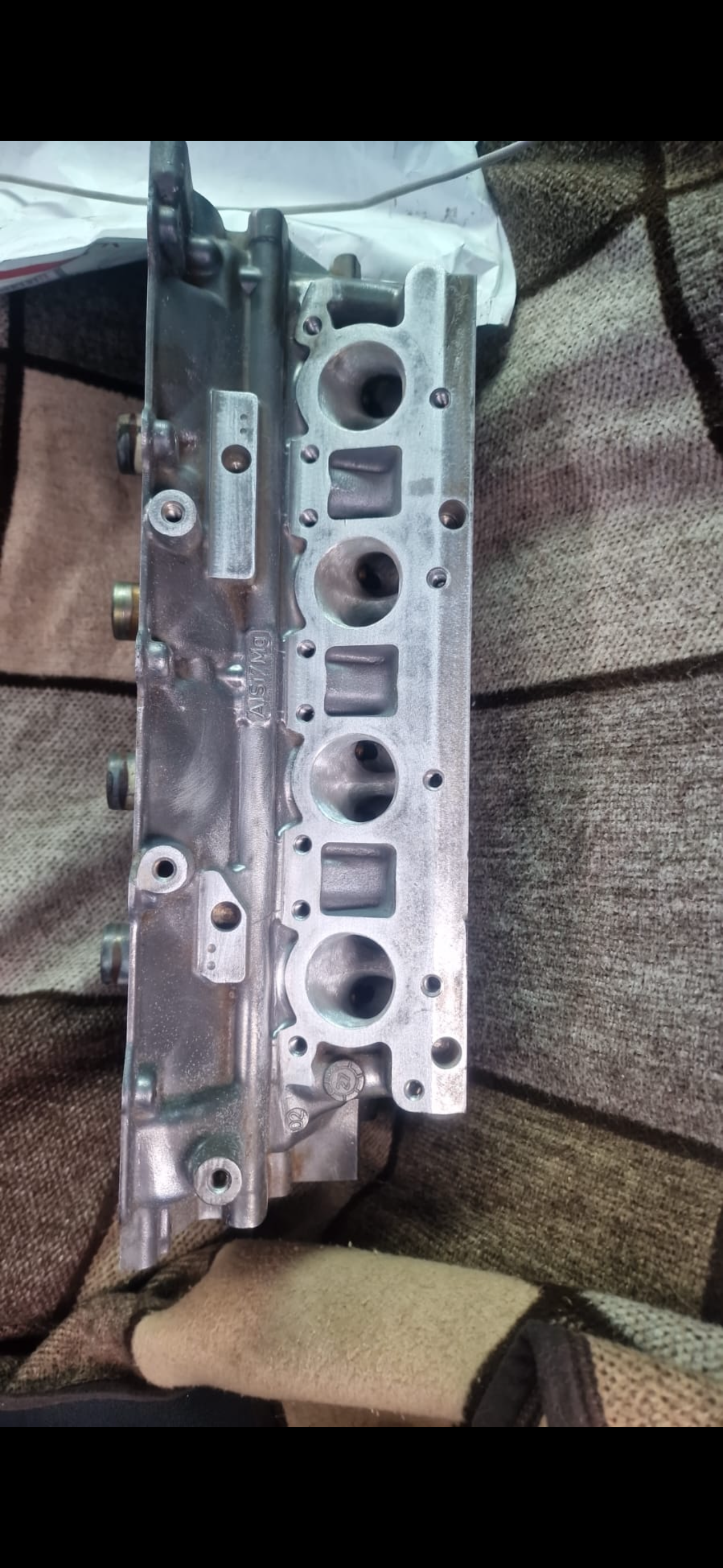

Well today has been a good & bad day. I have finally seen some progress pictures of what I’m spending all my money on :lol: :lol:
Both of my cylinder heads have had their mild port & polishing complete. 90%of all my valve train kit has also been complete. Just needing/waiting on the inlet valves to be done then the heads can actually go off and be cleaned in prep for them going back on the bottom end.
The port & polishing plus port matching has also been complete. Exhaust manifolds and inlet manifold.

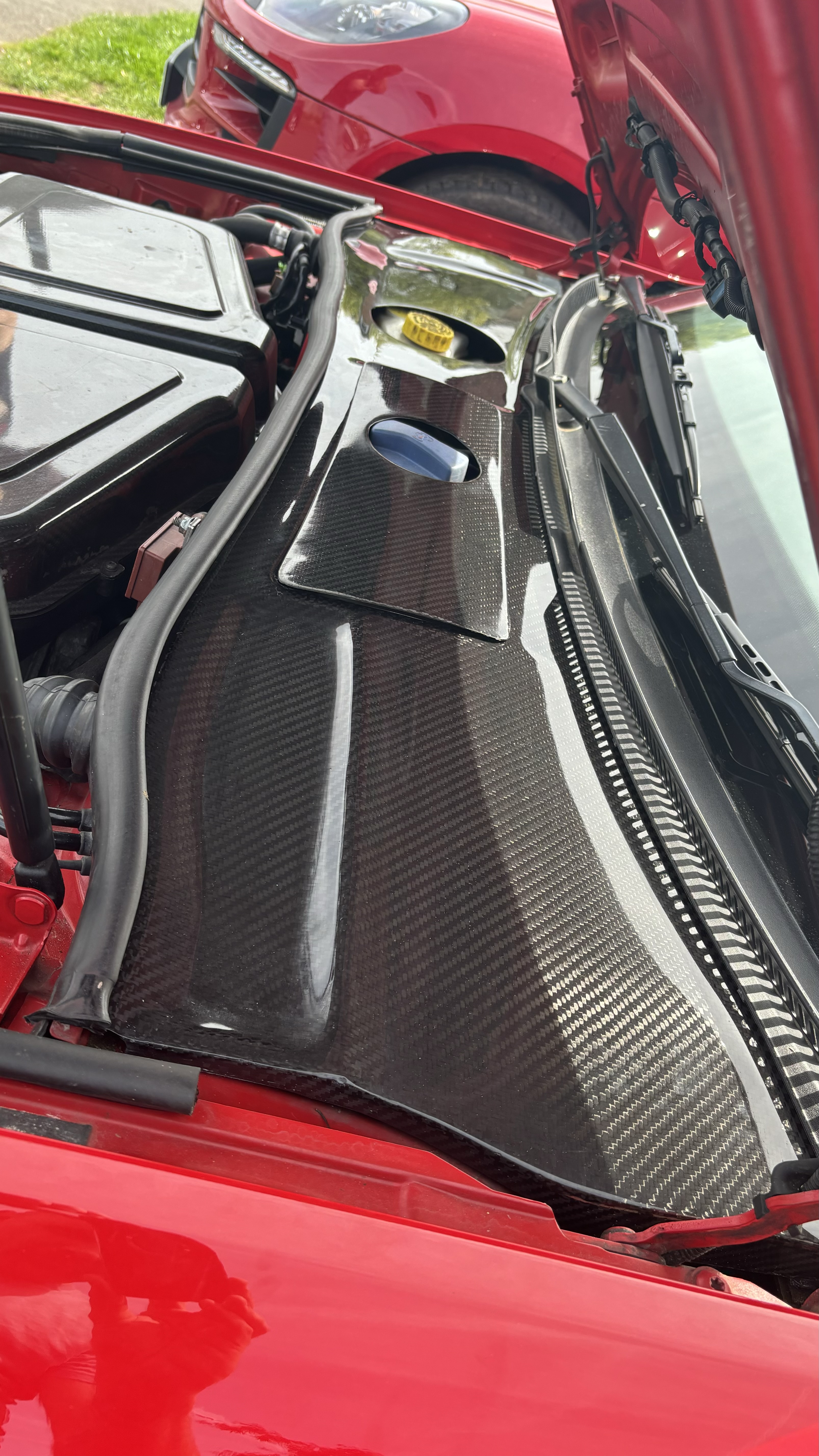

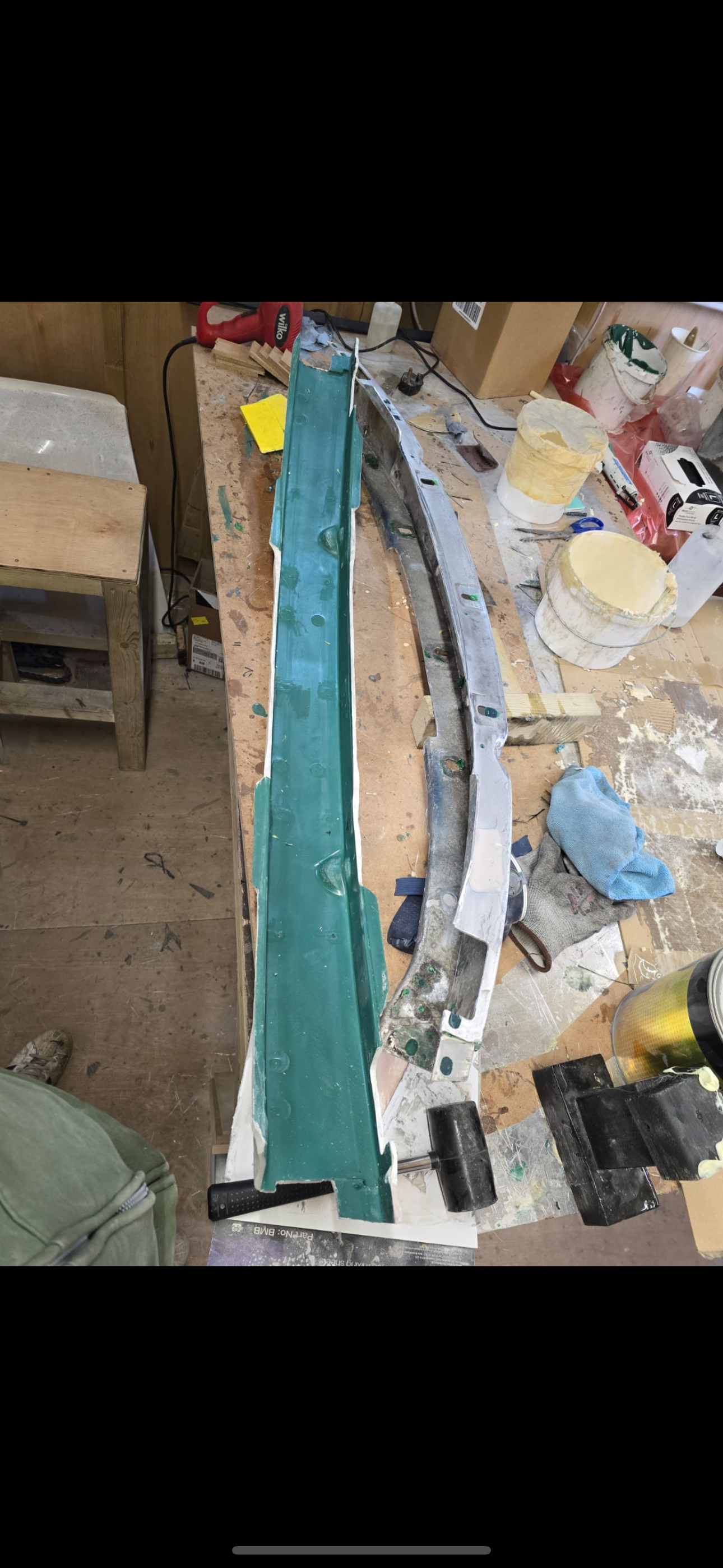

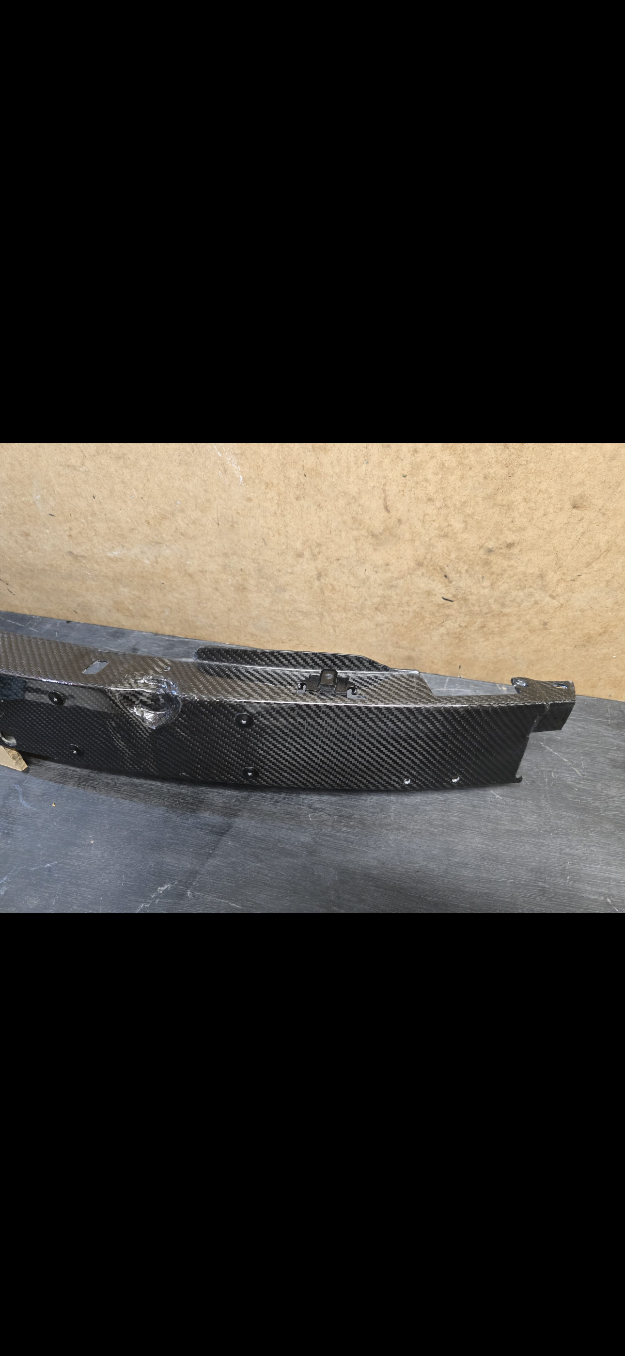

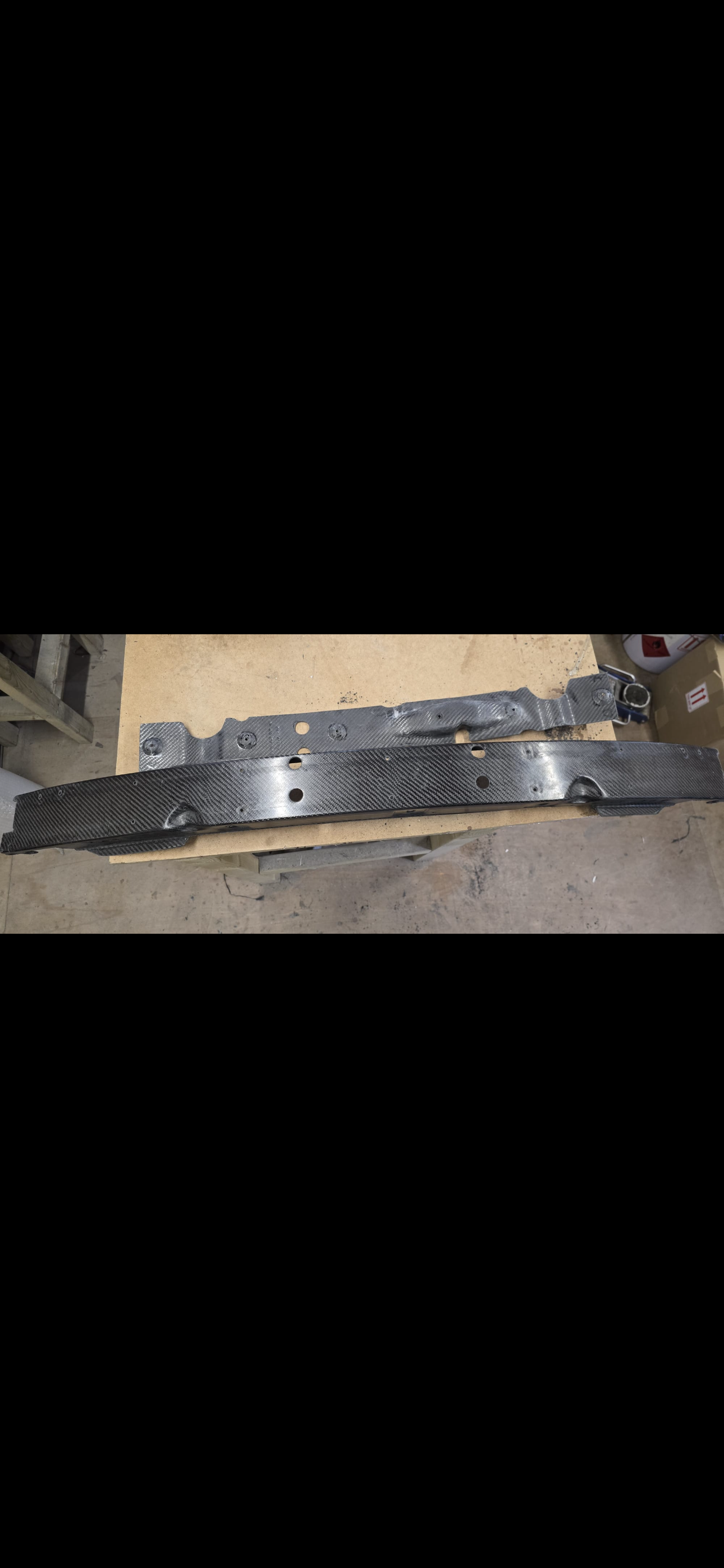

While I haven’t got the car with me, I have still been cracking on with other parts to do with this project.
First of all, is my carbon fibre scuttle panel.
I’ve also been working on making the front crash bar from carbon fibre too. This is purely just to save some weight on the front end of the car.

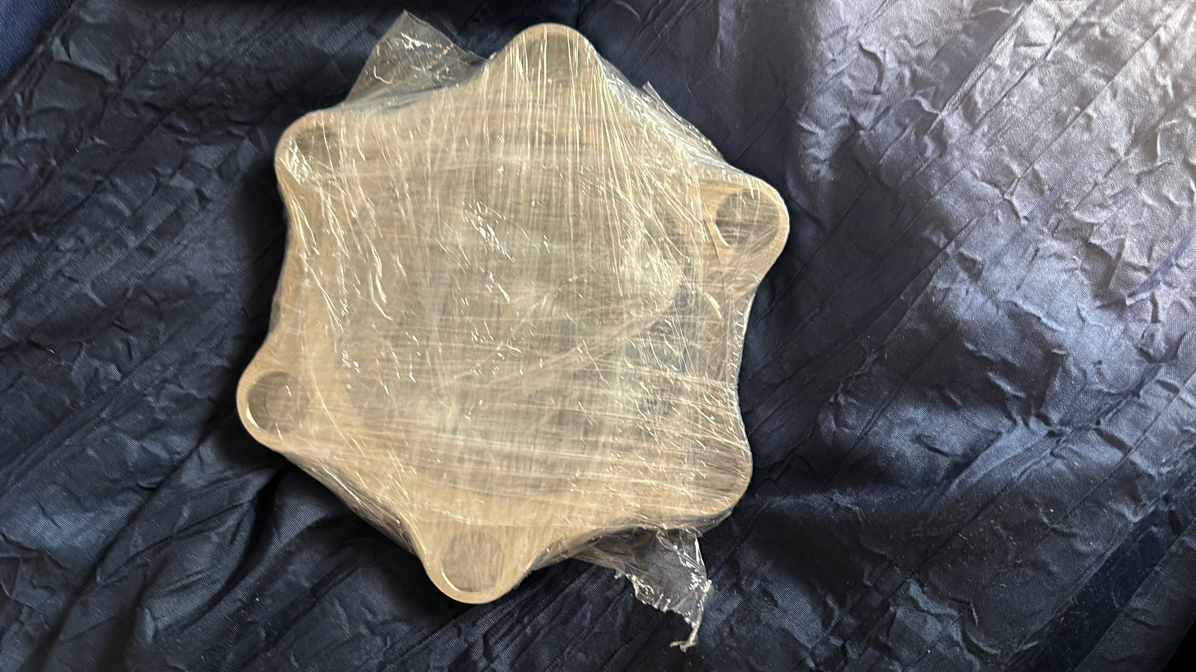

More news I have now managed to source a griddle plate for my build.
It’s in final testing and development stages then I should have 1 with me.

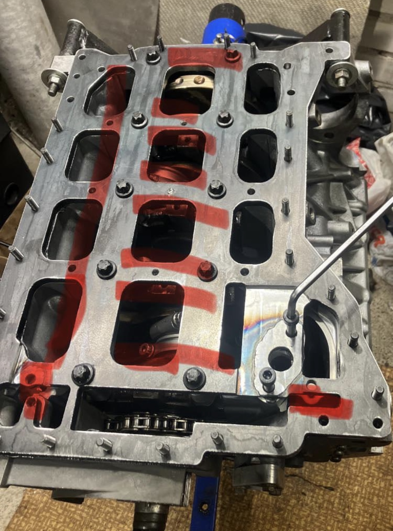

Post by Felix2566 » Sat Apr 20, 2024 12:53 pm
Is that an additional part added to give more rigidity to the bottom end?

Post by Sxcarmyboi » Sat Apr 20, 2024 5:09 pm
That is exactly what it does. Just aids in strengthening the bottom end.
It is an additional part. That bolts on to the bottom of the block then the oil pan/pans go on after.

A main bearing girdle provides stiffening to your engine block. Since high forces act on the entire engine, especially in tuned engines, the use of girdle plates is advisable. They prevent the crankshaft from bending too much and withstand even high torques. The bending of the crankshaft affects the whole engine and can cause major damage.

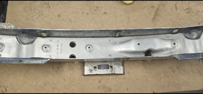

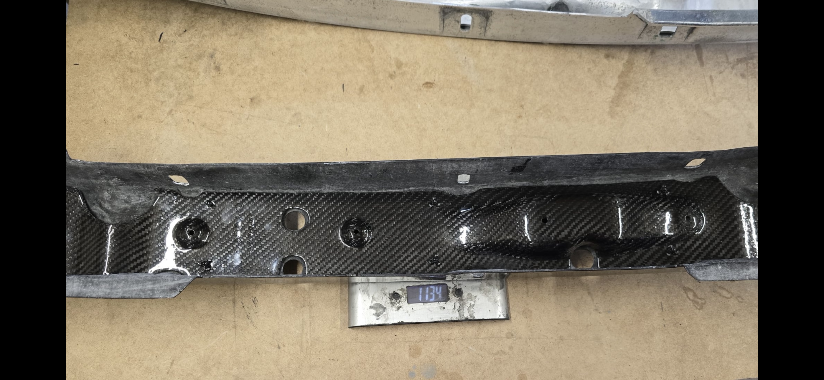

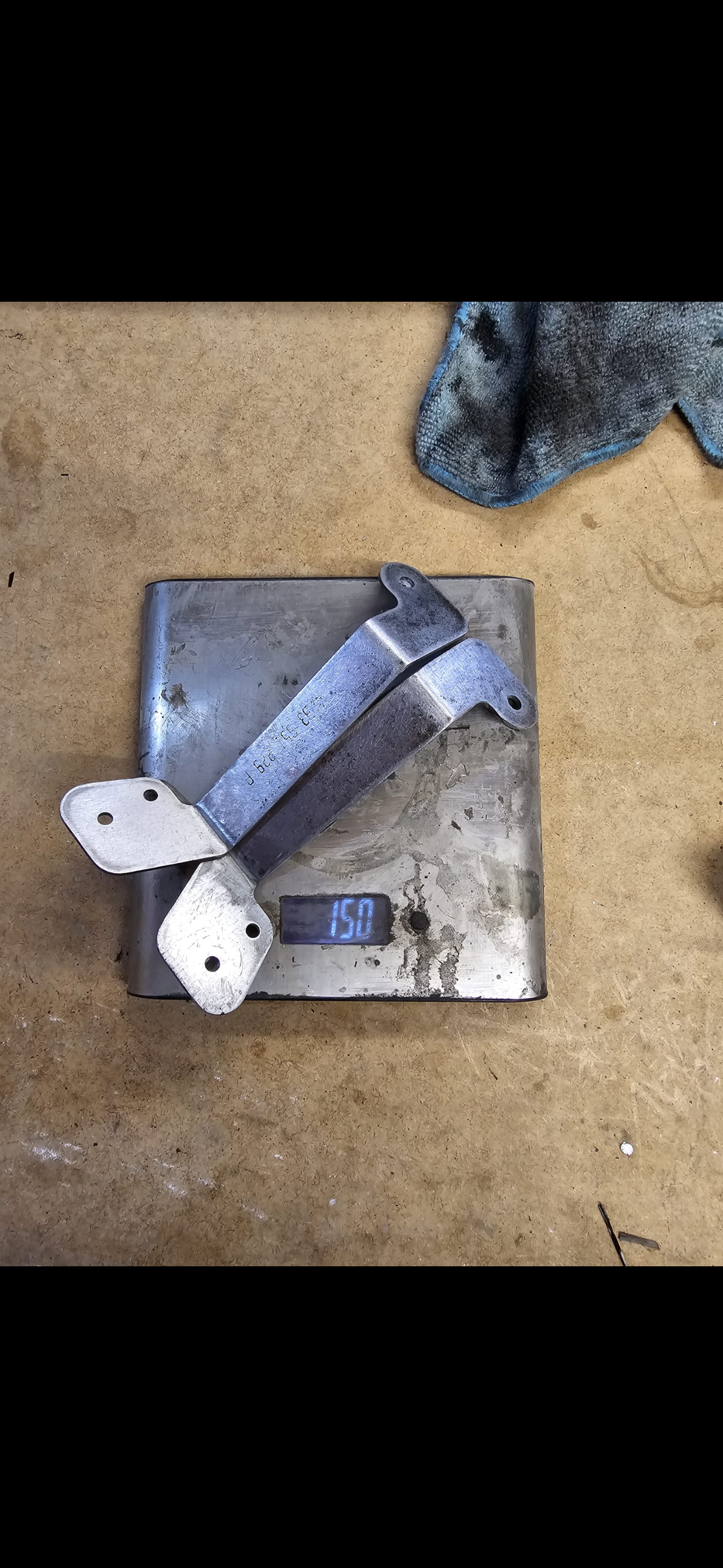

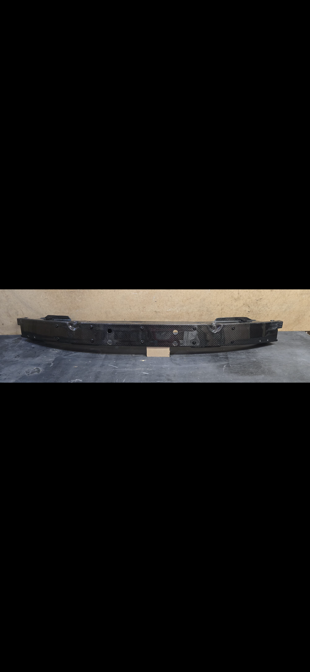

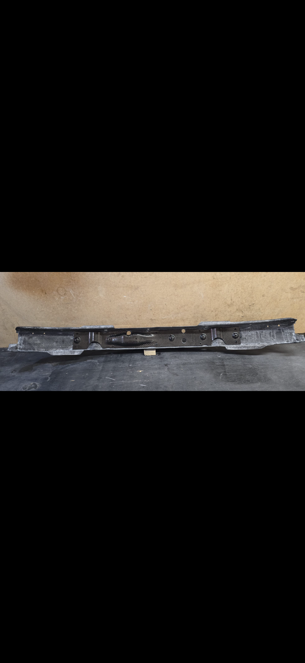

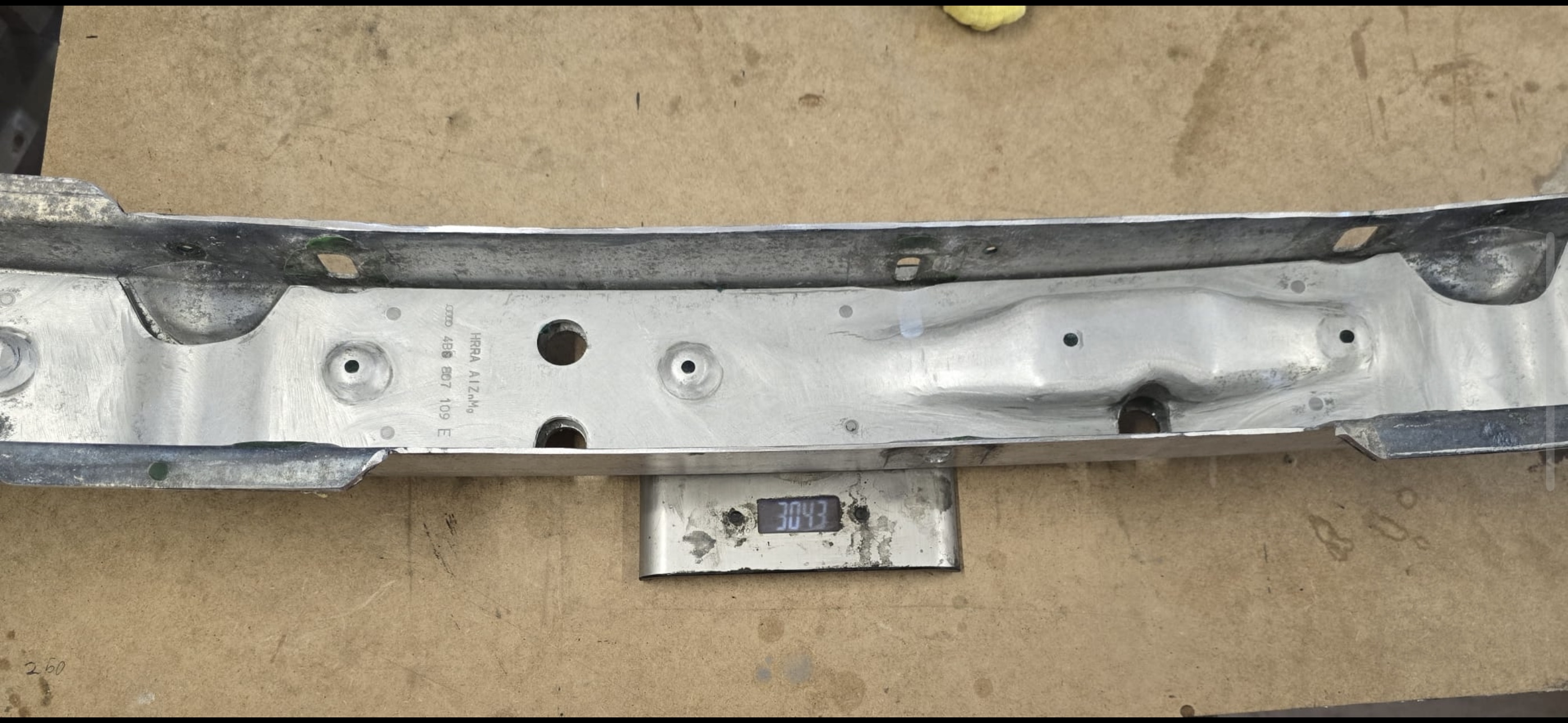

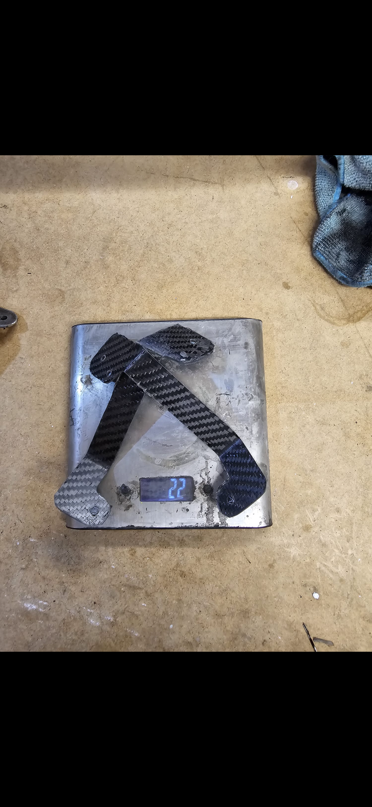

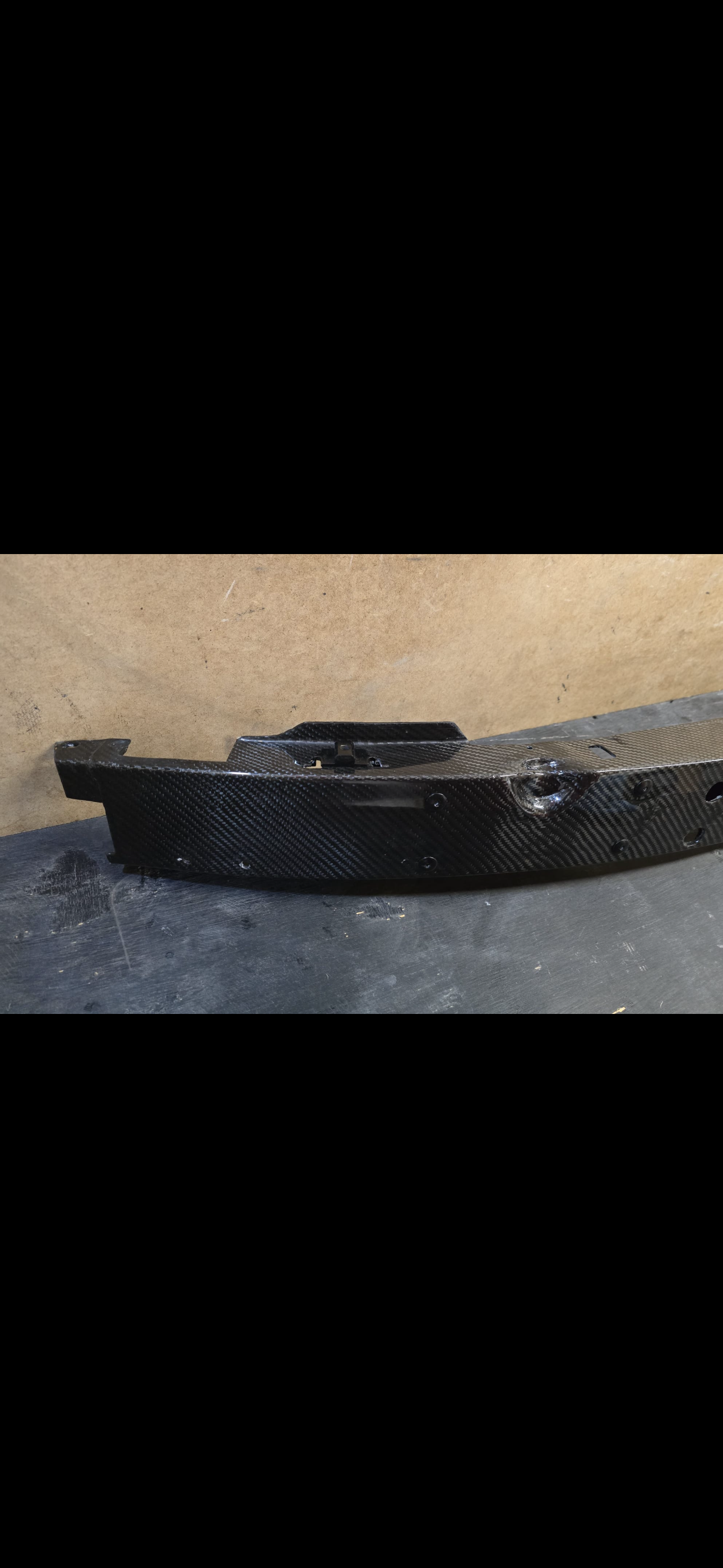

Another update in my quest to save some weight.
My front cross member/crash bar is now ready to be fitted onto my bumper. This item replaces the alloy bar on the back of the front bumper. (I know people are going to say why are you changing from alloy to carbon. The reason is because carbon is actually strong than alloy. That’s why, as well as saving over 2kg in weight)
C5 RS6 Avant
800+ BHP loading
1100+ ft lb loading
Sxcarmyboi
Posts: 209
Joined: Sun Jan 13, 2019 10:58 am
Location: Maidstone
Re: Engine build and 6MT swap
Post by Sxcarmyboi » Wed May 15, 2024 8:23 pm
More picture and updates of the front cross member.
Enjoy and the next pictures will be once it reattached to my front bumper.

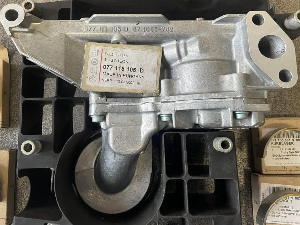

My brand new oil pump turned up today.
