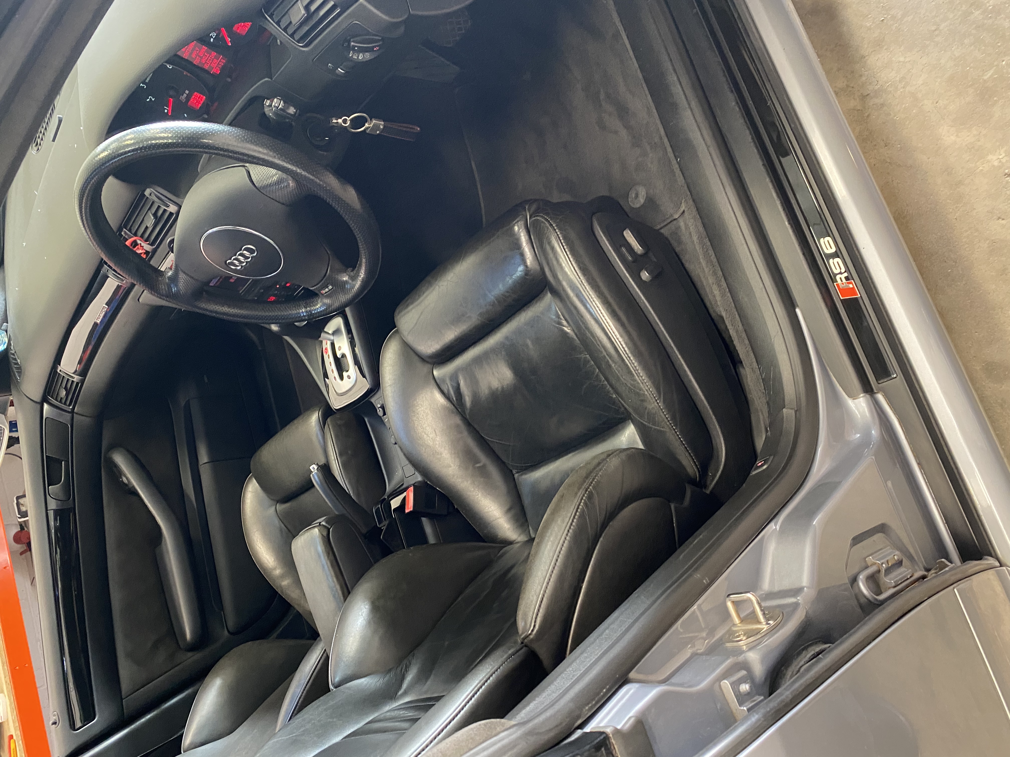

All back together now
Wipers initially had a mind of their own but seeing as they were having a bath for a few months, I would expect that, after a test drive though they have fixed themselves, is that a first for an RS6? Free repair???

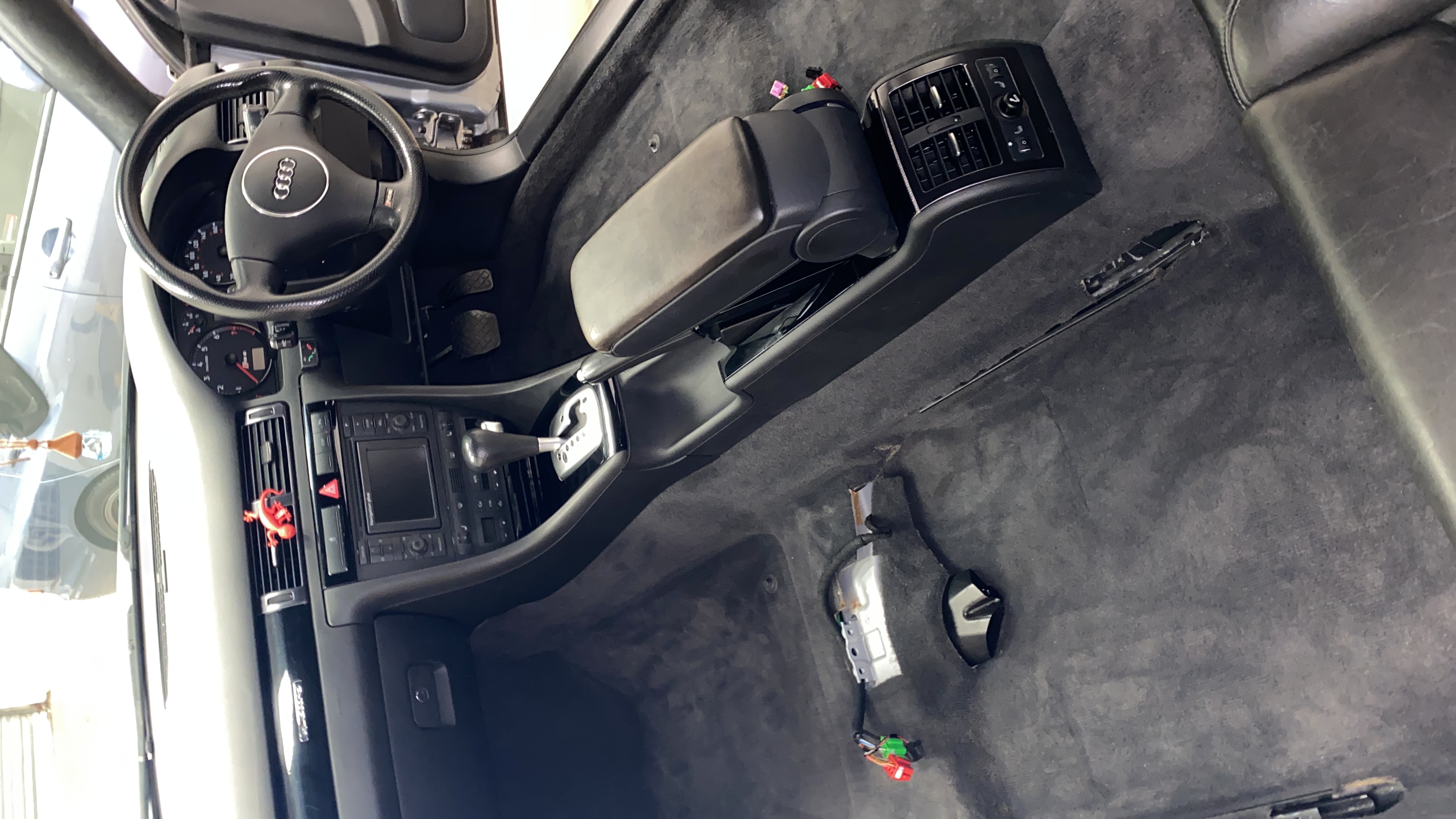

Only one issue, handbrake light stays on, had a bit of a faff replacing rear of console so maybe knocked it in process or the mount is pretty weak which I found on removing, I’ll have to get a look at that again soon
So far, gear issues are now fine, no extra lights or dodgy selections etc, moisture in the plug must have been causing it thankfully
I have now noticed quite a squeaking when dry steering a bit, would this likely be the top mounts? Don’t imagine rack has anything to do with it?

Handbrake has a single wire going to it on a spade connector IIRC. You probably dislodged it.

Yes Shop, it’s a really flimsy little bar steward so I’ll hopefully reach it by removing the rear vent, or I’m now an expert in removing the console anyway as it was in and out so many times on the refit
