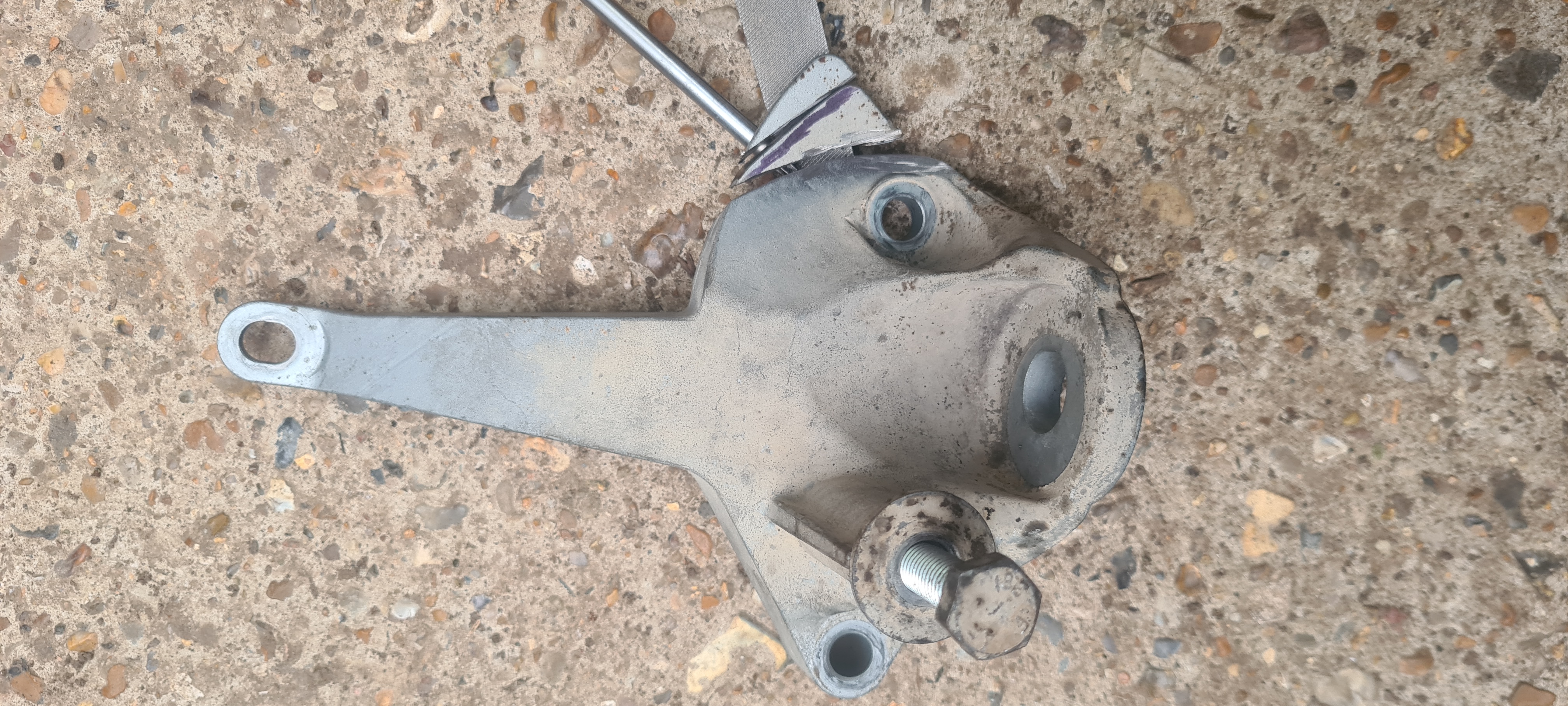

Re: Cleaning a F125 switch
While my engines out I've also done the gearbox mount mod too so I can make a nicer job of it and thank myself in the future if needed.
Bolts if I recall were 16mm long. I can double check if you want to be absolutely anal about it but 16mm or there abouts should work anyway.
Also filed the shaft down that the switch slides onto as suggested by others. There's no need for all that to be hanging out. F125 now slides on and off with gearbox mount in position with ease.
See pic to give an idea of the amount needed to be cut off.
Clearly wasnt on Audi's design radar that the switch would have to be replaced while on the car. It's not a great design at all.
But with the modifications to the gearbox mount, the spindle and changing the bolts it makes it a super simple job
How have people been cutting the wing off? It looks a bit of a nightmare in-situ.
I used a recip saw, couple decent blades and it was off. No damage to the rest of the car. Took a while as the steel is very hard!
