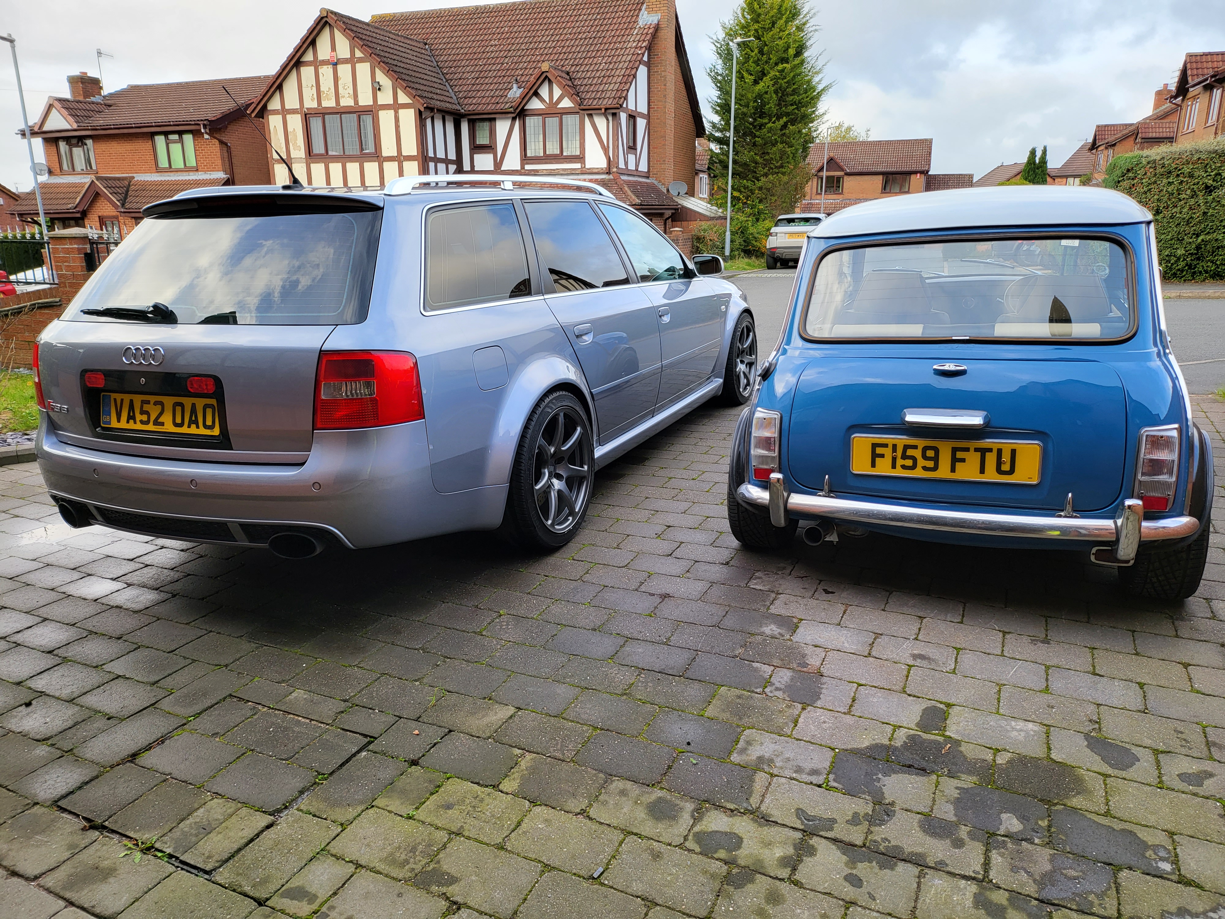

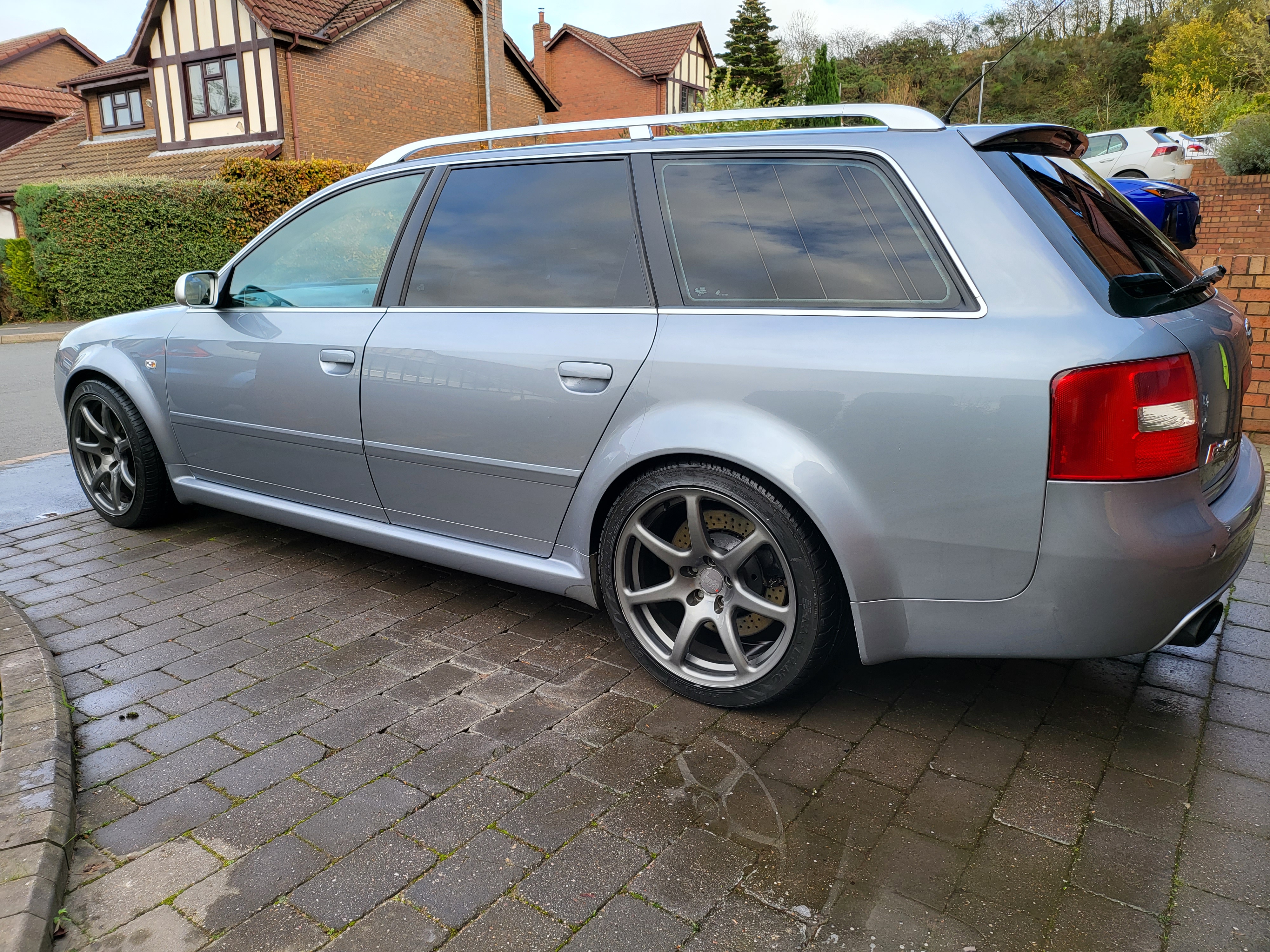

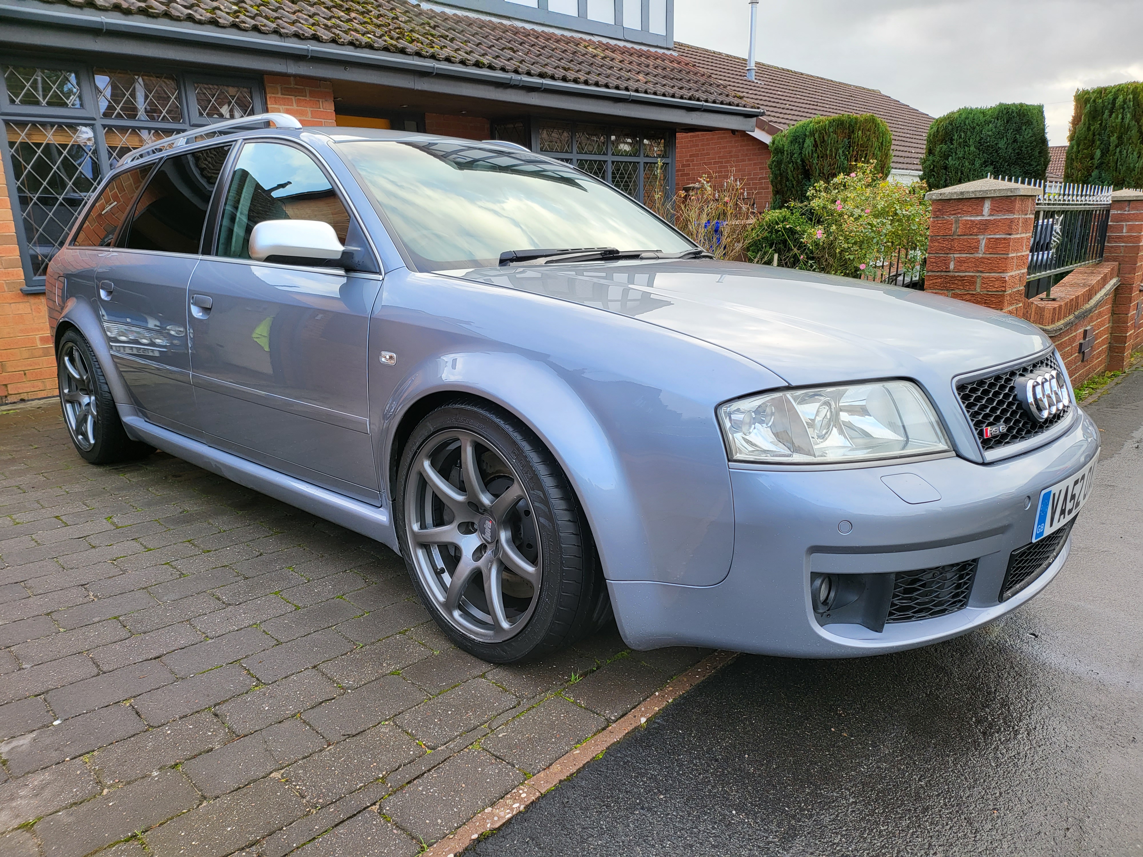

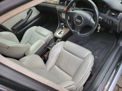

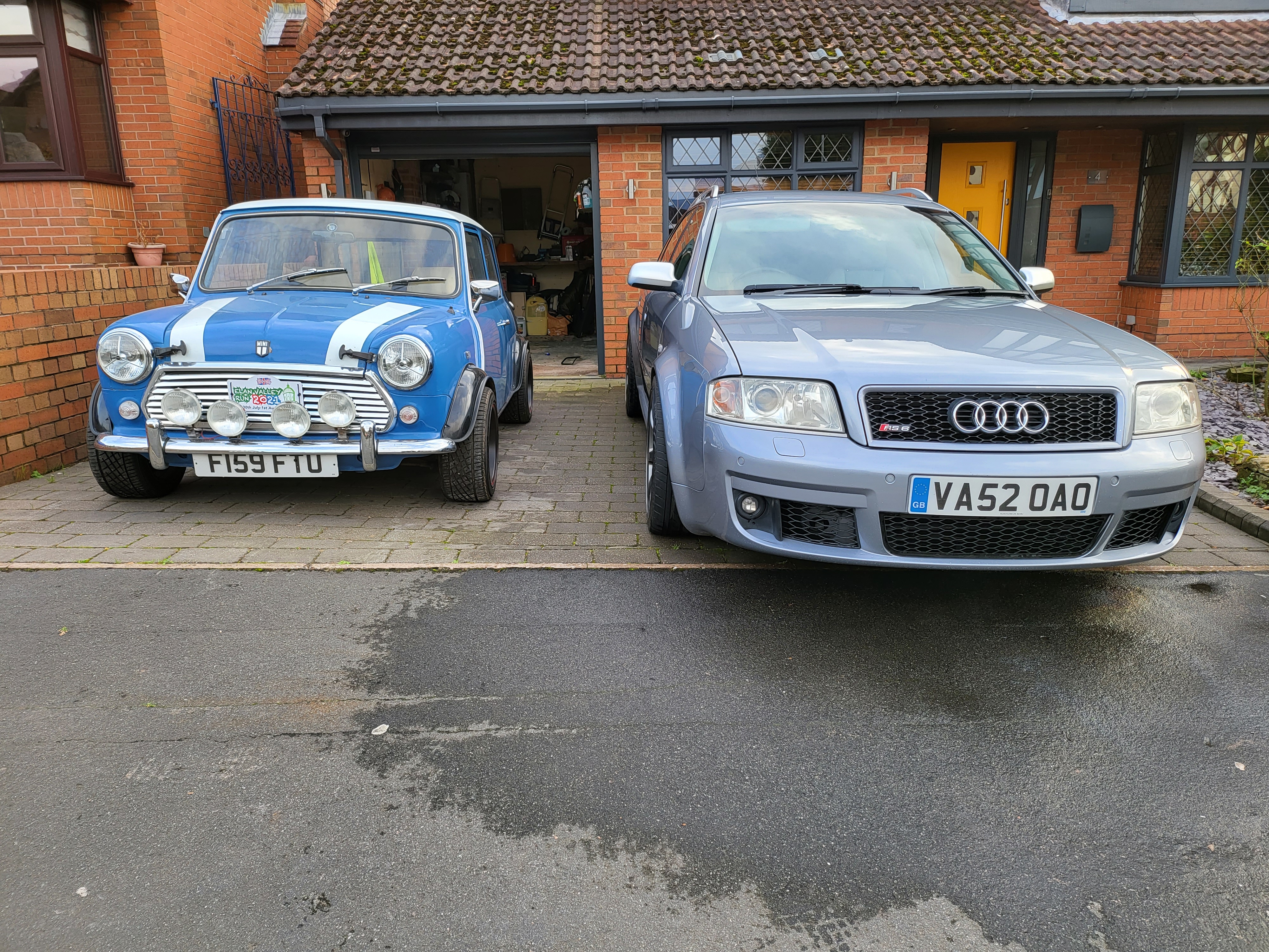

Washed it today and thought I'd take some pictures as I've only shown 1 dark picture. I love the colour, it seems to change depending on the light.
Took a couple of pics with my other baby while it was out of the garage:

Looks really nice Matty.

Also I think that mini was reported as a accomplice for a gold bullion robbery a while back in Italy.

Re the Mini, I don't know what your talking about...
