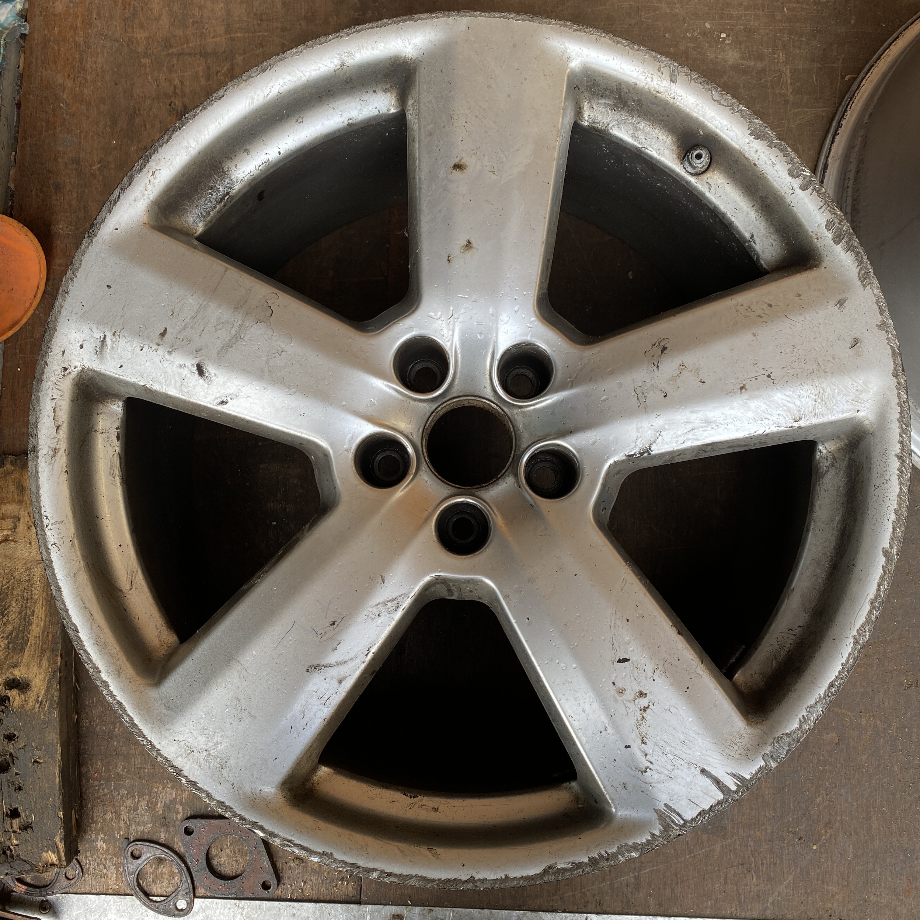

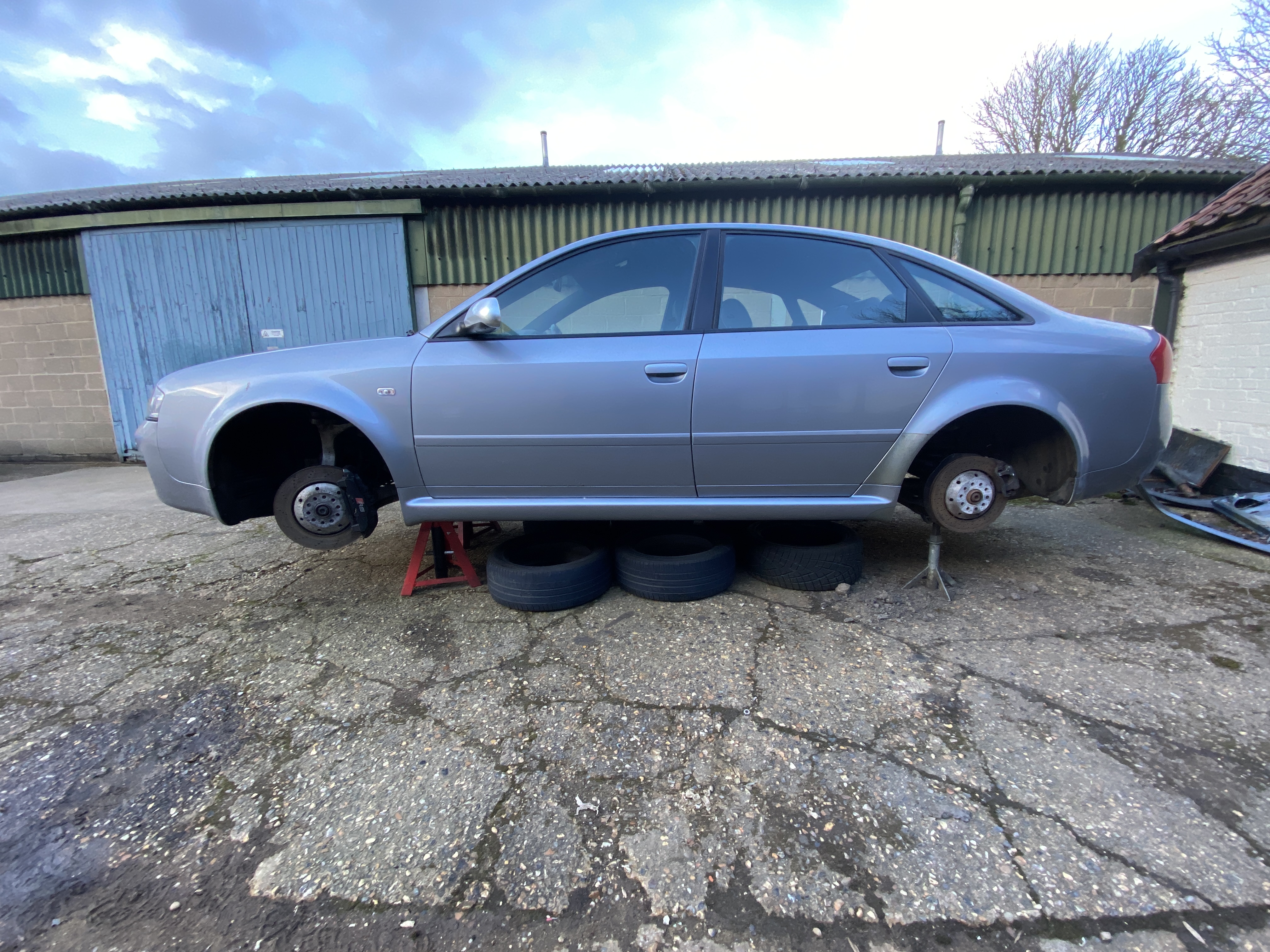

Car's now on axle stands and I've taken the wheels to local friendly tyre Shop and had tyres removed. I have a tyre machine in our workshop, but low profile tyres are a b*tch to get off, and I don't use it often enough to develop the knack. Conventional 60-70-80 profile tyres no problems. Wheel reconditoning people on standby and hopefully collecting the wheels next week to refurb, and to also do a spare set of Clio RS200 wheels for my wife.
Next I would like to remove each brake disc in turn, clean and examine and reassemble. There is some life left in these discs and pads. I'm going to give each corner a good clean whilst I'm in there.

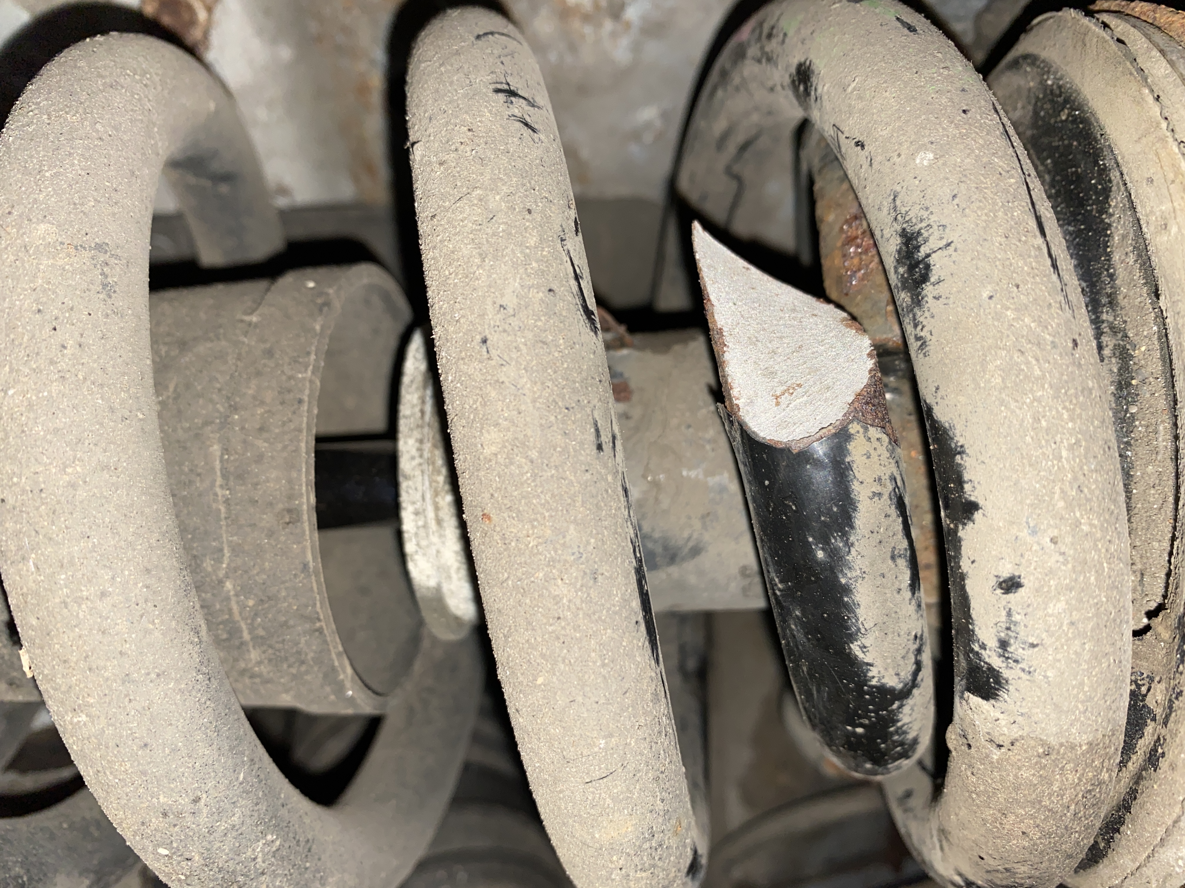

Annoyingly I have spotted a broken coil spring (front RH), and there was something damp near RH rear suspension, but not investivated it yet. Wheelarches were caked in mud so knocked most of that off.
Old private plates sawn off with thin string. Old sticky pads removed and new plates fitted. At least a couple of things ticked off my job list.

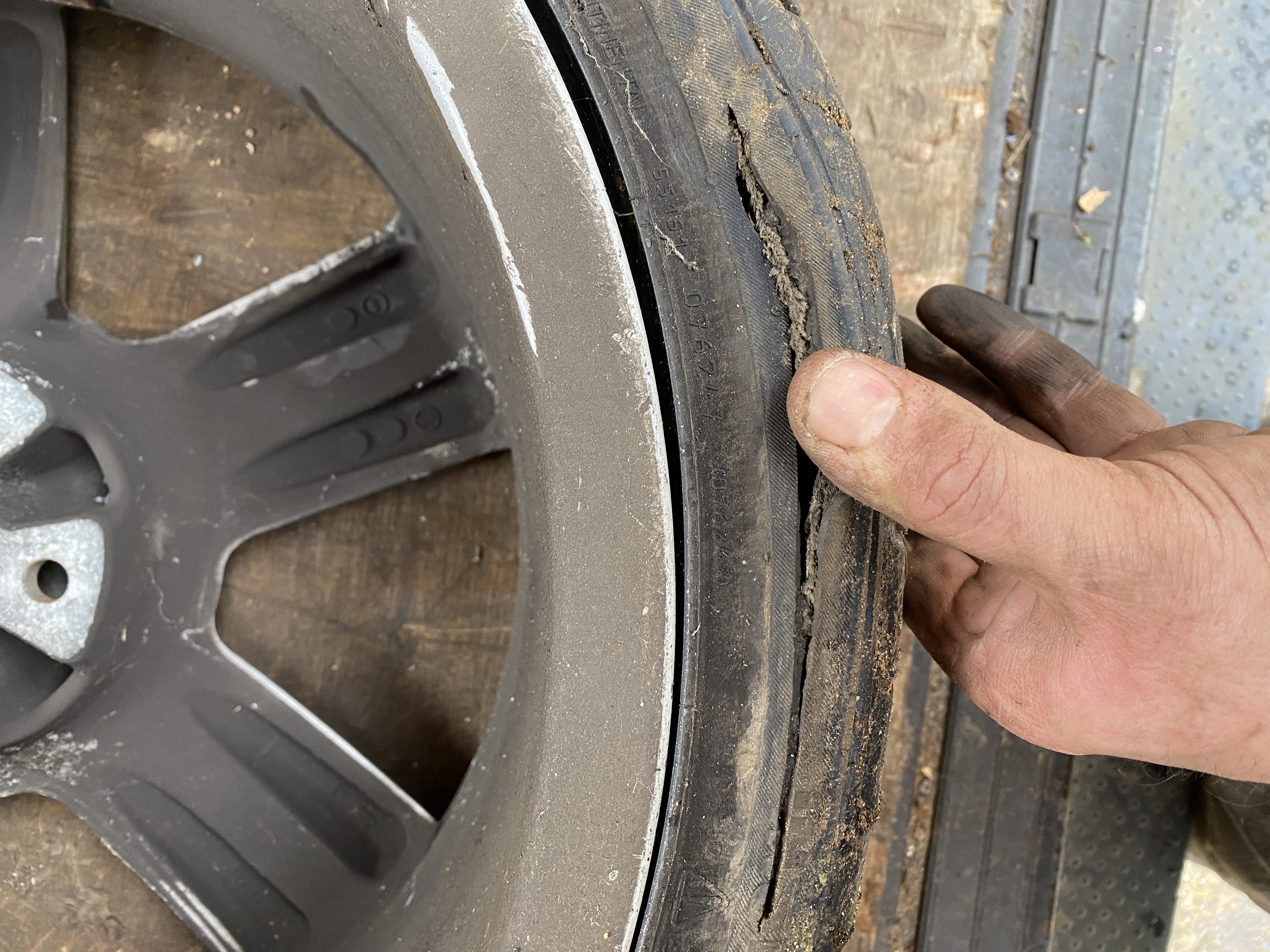

Re: New owner
Where we're going we don't need wheels...
Wheel, ready for reconditioning.
Broken front coil spring :-/
Front left had a holed tyre, split was as wide as my hand.
