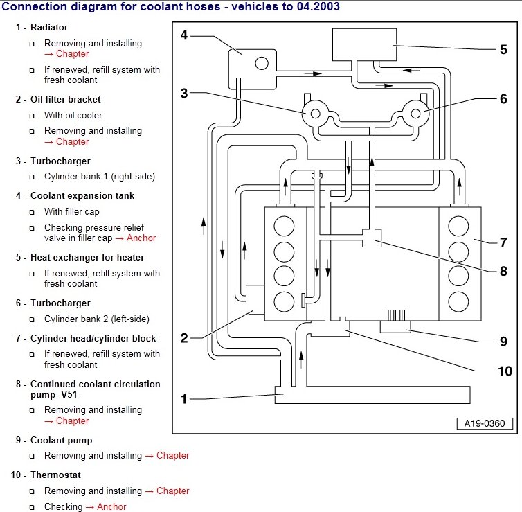

Re: Can’t source a radiator!
Hi guys,
unfortunately I'm now also in the situation I have to source a new radiator for my car. I've checked with Serck and they still can deliver but the asked price is now £1,794 which is a bit up from the £900 mentioned previously in this post.
I'm therefore considering other options, which is the 4B3121251E version of the radiator which is available for less than £200. This is identical except it doesn't have the extra pipe for the afterrun pump.
Shoppint wrote "You can change the plumbing so that it circulates like the early 2003 cars and always let your turbos cool down to 90 degrees which you should be doing *anyway*.
Anyone have information on how the plumbing of the early 2003 cars was done so I can consider this solution.

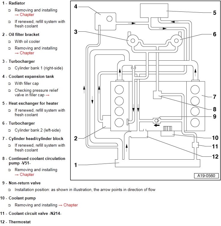

4-2003 on:
Thanks Shoppinit for the drawings.
Unfortunately it doesn't seem straightforward to convert to the pre 2003 plumbing.
On the post 2003 drawing it's not shown the flow direction trought the turbos. I assume it is because the flow direction is both ways. From the radiator trough valve 11 and the pump 8 to the turbos when the engine is stopped.
And from the turbos through the pump 8 (not running) and then through the one way valve 9 back into the engine when the engine is running. Valve 11 is then closed.
If this is correct I'll have to find a way to tap into the bottom hose from the radiator to supply water to valve 11.
I'll look into it in more detail later.

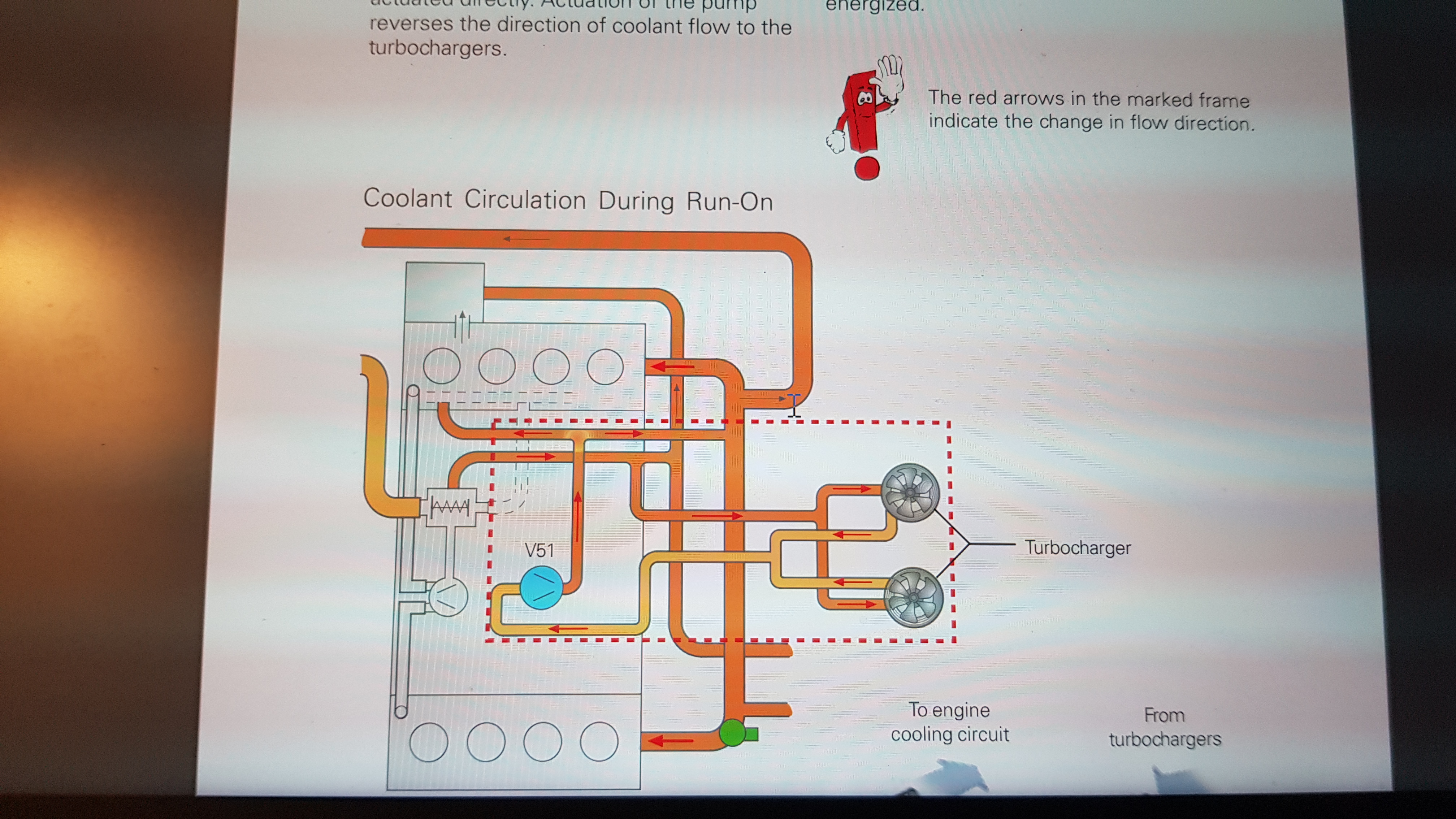

Yeah. I seem to remember that the after run pump circulates in the opposite direction to normal flow, too.
I’m not sure how much I trust those arrows either. The whole job seems a bit amateurish.
I’d definitely want to confirm some of the directions. Last thing you want to do is starve the turbos of coolant.
Yes the flow to the turbos is reversed from normal operation once the engine is off. So coolant is drawn through the turbos by the after run pump
SSP 991303 explains
SSP 991303 explains
