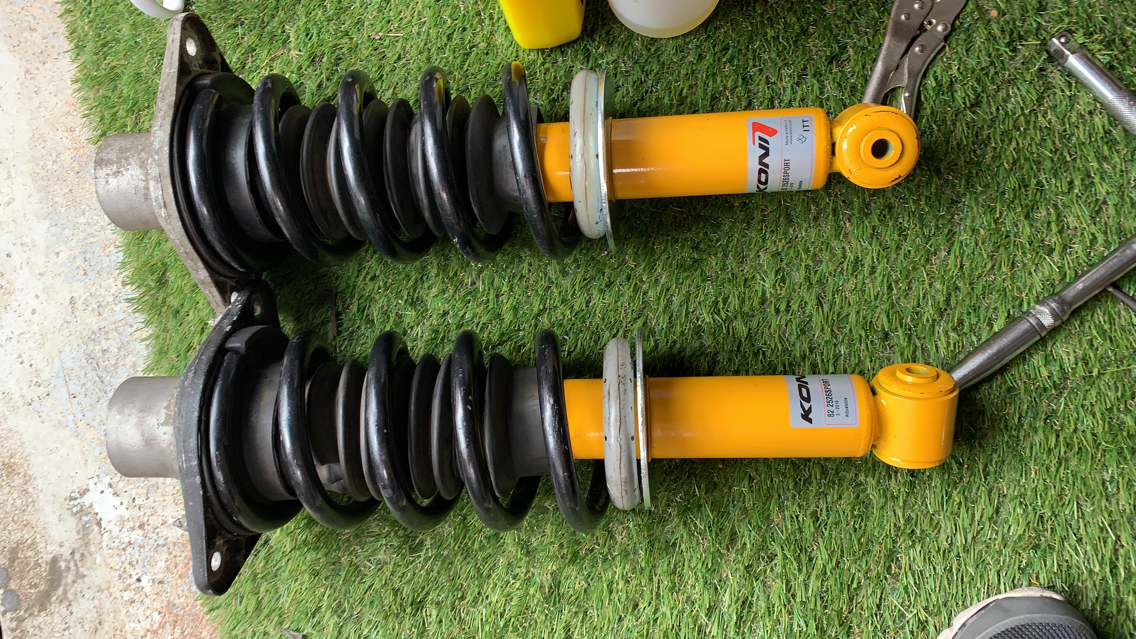

Human Joist wrote:They look good.
I’ve just collected these springs. They are off a plus so will sit a bit lower as well. Chuffed with this. Will get them fitted tomorrow
Those look great. Glad you sorted it Image

Interesting. The colour code on your springs is the same as mine. Would that not mean they are the same??? They do look very fresh though so great find.

Cool. I'm not convinced they are plus springs, though, but the parts catalogue is pretty opaque on the colour codes, so hard to be sure.

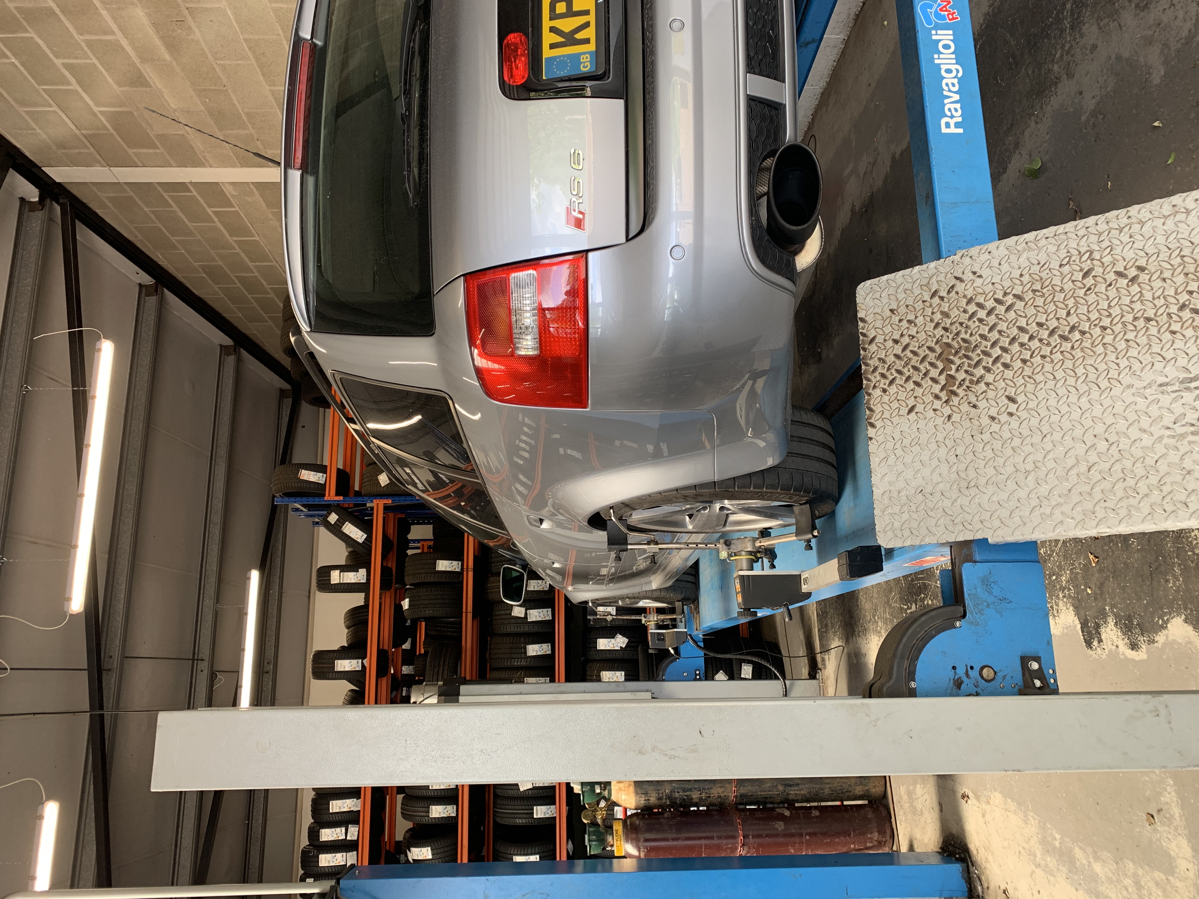

Got it all tracked up yesterday. Went well apart from the one rear right tracking bolt innermost with the multispline thread that was stuck fast. They didn’t want to snap it and suggest the bush will be swollen and need the bolt curing out

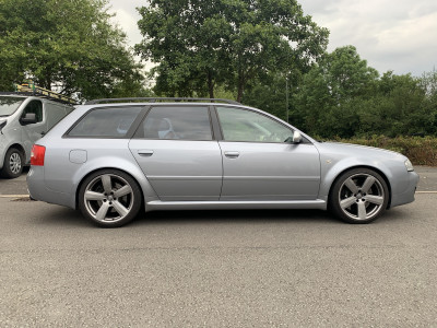

Human Joist
Posts: 487
Joined: Sat Aug 02, 2014 6:04 pm
Re: Urgent suspension help
Post by Human Joist » Wed Jun 10, 2020 6:28 pm
So this is now after two days
This is just after it was fitted. Seems the suspension has settled a bit. But almost a bit more at the rear
Users browsing this forum: Majestic-12 [Bot], srichards and 93 guests
