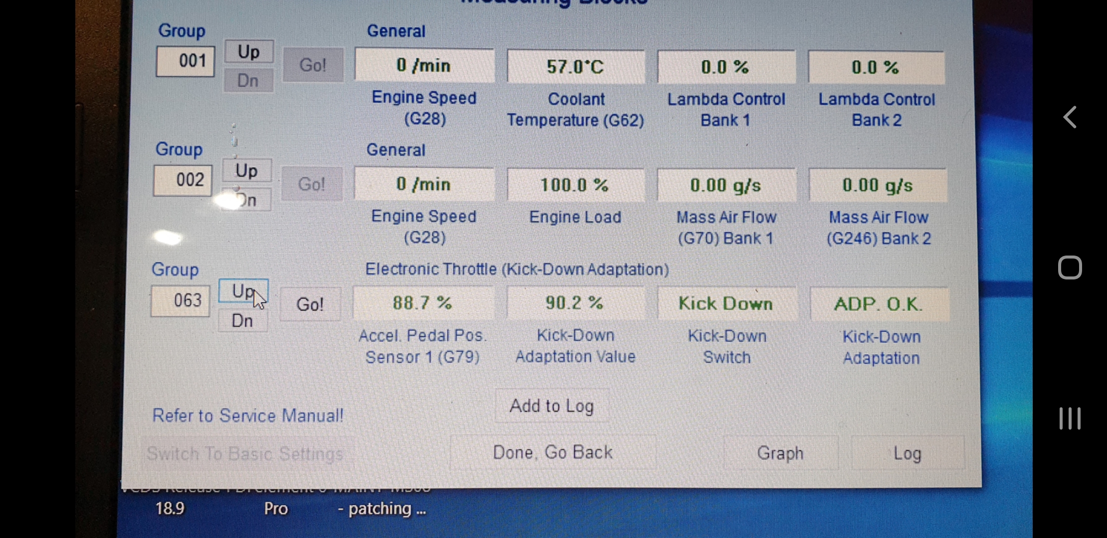

I think it’s unlikely anything has changed in the TCU. Most likely is that it’s reacting to different torque calculations based on different data from the ECU.
I would go back and look at the mixture and ignition timing. Maybe you’ve still got a small leak somewhere.

I did read somewhere that you can reset the TCU using the accelerator and key. Might be worth a Google.

Definitely worth checking over the MAFs to see if they are new or original as they are used as part of the engine load calcShoppinit wrote: ↑Wed Oct 14, 2020 7:37 pmI think it’s unlikely anything has changed in the TCU. Most likely is that it’s reacting to different torque calculations based on different data from the ECU.

Cheers everyone, I will have a look st the mafs and check for any leaks as suggested.
