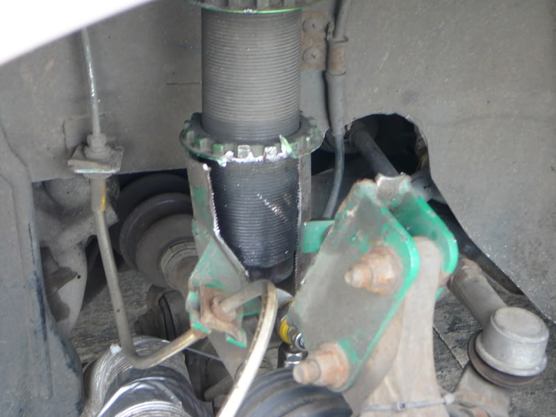

The coil overs that adjust at the bottom had a lot of strength issues a few years back as the rotating collar is so thin and takes all the punishment.
I would imagine things have been improved on now but worth keeping an eye on.

Re: DRC Plus replacement Parts List
To be fair, that's a photo from a post showing failures of Konis, KW, etc.
