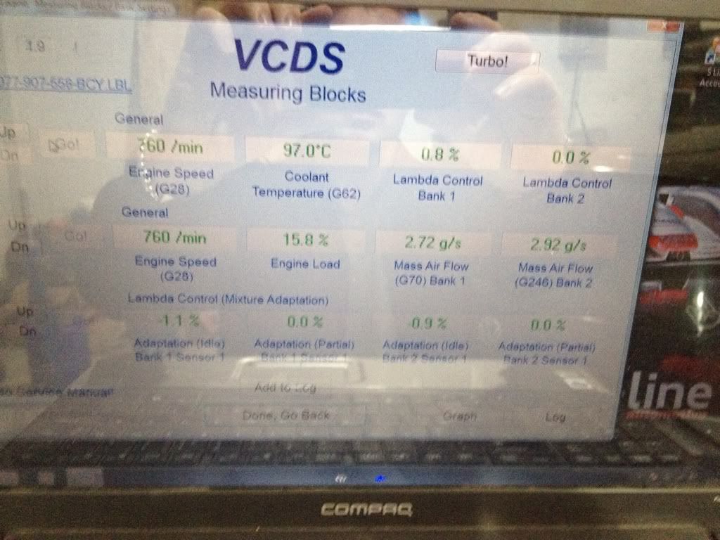

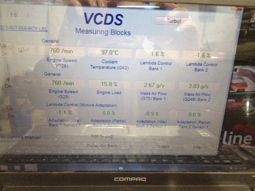

Right wiped codes and went for a blast - they did not come back, see below for pics of data at idle but i thought it looked ok....
Lambda control under log 1 ranged from 0 to -2.3 but usually matched and were manliy 0 to -1.6 I know this means it's reducing the fuel as its thinks it's running a little rich but was zeroing every second or so.
Any ideas?
Any ideas?
Re: "lumpy" throttle response
Not telling us much as idle, that's the problem. It would have been useful to log the MAF values while driving, especially under WOT.
Problem is here that your mixture adaptation values are reading zero which suggests to me that the picture was taken just after clearing the DTCs which also zeros the adaptations. It won't calculate the partial until you drive for a bit. So we have no info about what your MAFs are doing at higher revs.
What you need to do is go out for a drive with the laptop plugged in (don't clear the DTCs this time) and use the log feature (you can see the button) to save the data to disk. Start it off logging then go for a short blast, getting up to the red line at least once under WOT.
Then do the same while logging these groups instead: 1, 54, 115.
Then find the .csv files generated and post them up here for me to peruse.
