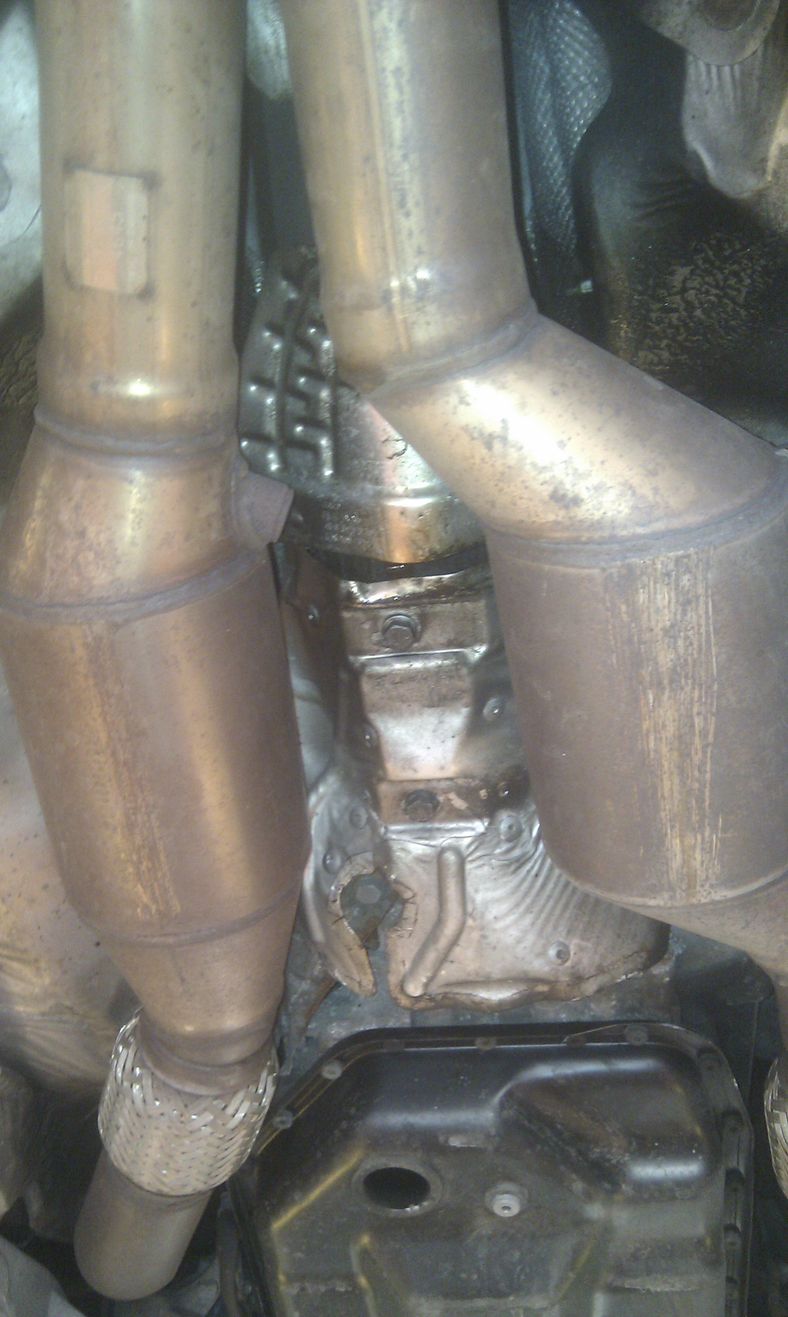

Looks like I have the same issue too! (Thanks mavada)
How urgent a fix is this?

well, it needs oil to work properly and you dont know how much and how long it is leaking while driving.
Thats why i always want to repair oilleaks asap.
My advice should be to have a call to Audi stealer or a specialist who knows about the uprated parts (some Audi stealers in my area dont even know the part is upgraded...) to prevent it from leaking again...

Yeah, it has been less than 500mi ago because it was OK at the last service. Ill get it over to Unit 20 as soon as I can I think
