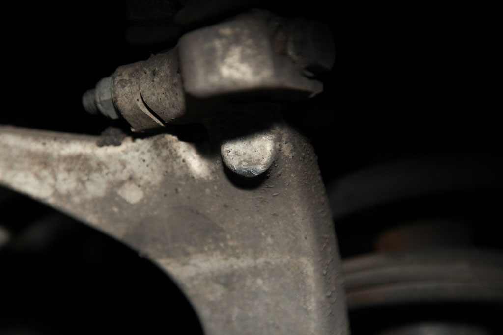

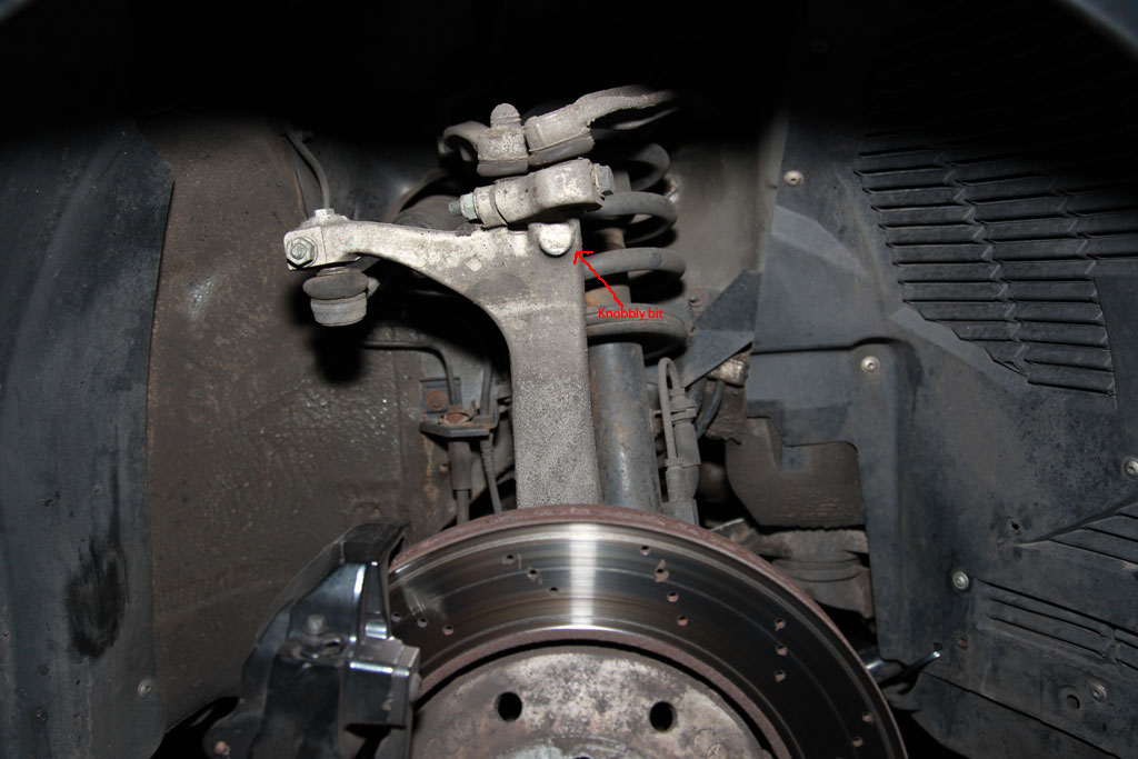

Had a closer look at my blown out tyre and wheel arch. Think I've been hit by the dreaded "knobbly" bit extrusion, as you can clearly see from the fresh rubbing. Can someone here please confirm that this is the knobbly one ??

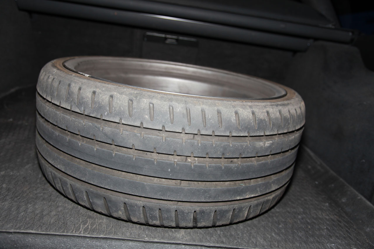

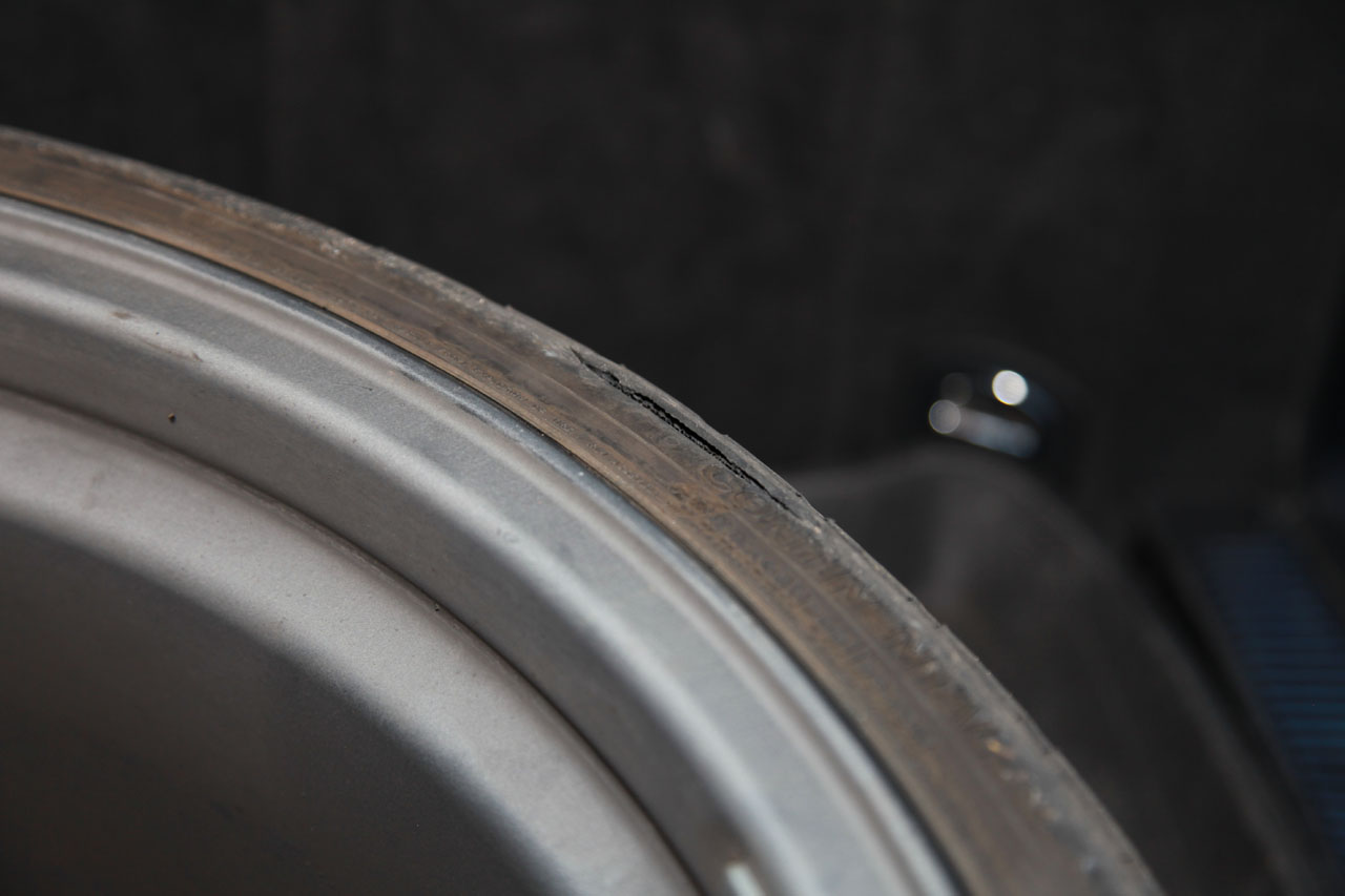

Post by Wolverine » Sun Sep 19, 2010 7:36 pm
And here are pics of my blown out tyre ....

Post by Daveperc » Sun Sep 19, 2010 7:48 pm
Yep - that's 'ol knobbly all right - and the tyre damage looks consistent with contact....

So Dave, any ideas on a solution ? Can I not just sand this bit down or is this some specifically engineered knobbly thingy thats vital to the suspension?

Post by iR8V10 » Sun Sep 19, 2010 8:31 pm
I had mine taken down by doug at MRC when we put the wheels on...it's 100% not contacting now.

Post by Daveperc » Mon Sep 20, 2010 10:36 am
Two thoughts on "Ol Knobbly"...
1) If Audi put it there it must serve a purpose - it must cost money to shape it that way, and these cars are engineered to the last penny. I have always presumed it was thickened so that a thread or similar had sufficient meat round it;
2) If Doug had successfully reduced it, then I assume it is safe to do so - those guys at MRC know what they are doing!
Only other advice is "tell the insurers if you mod it" - explaining to the nice lady on the phone that you've had your knobbly bit ground down to make more space for rubber should be hilarious!! (Seriously though - it is a "mod" and as such should be declared")

Okay, I'm more comfortable with the fact that my two blow-outs in the past 2yrs (both fronts) are more than likely caused by the "knobbly one" rather than the load rating. Now need to buy another pair of front tyres ... I'm thinking of buying the new Continental SportContact 5P in specific Audi fit as these are also recommended by ABT.
